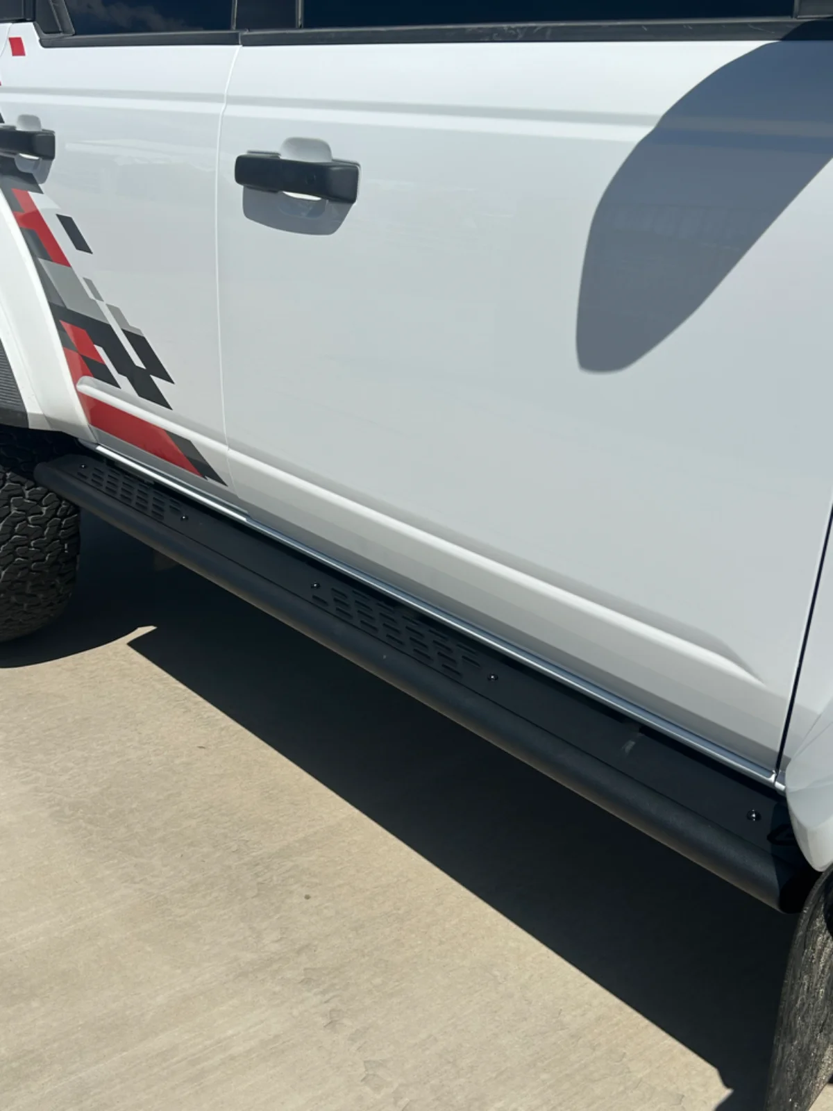

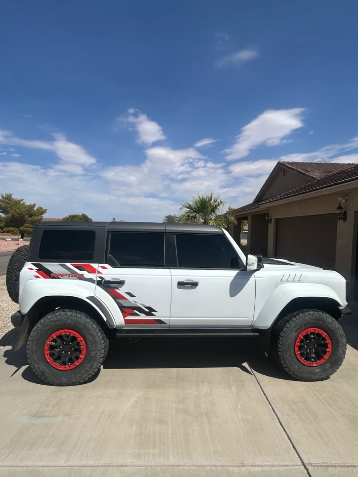

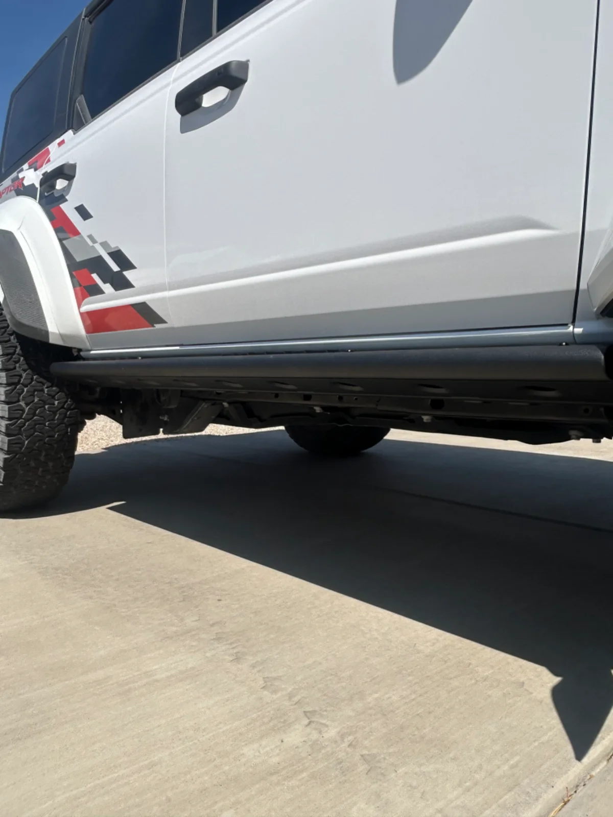

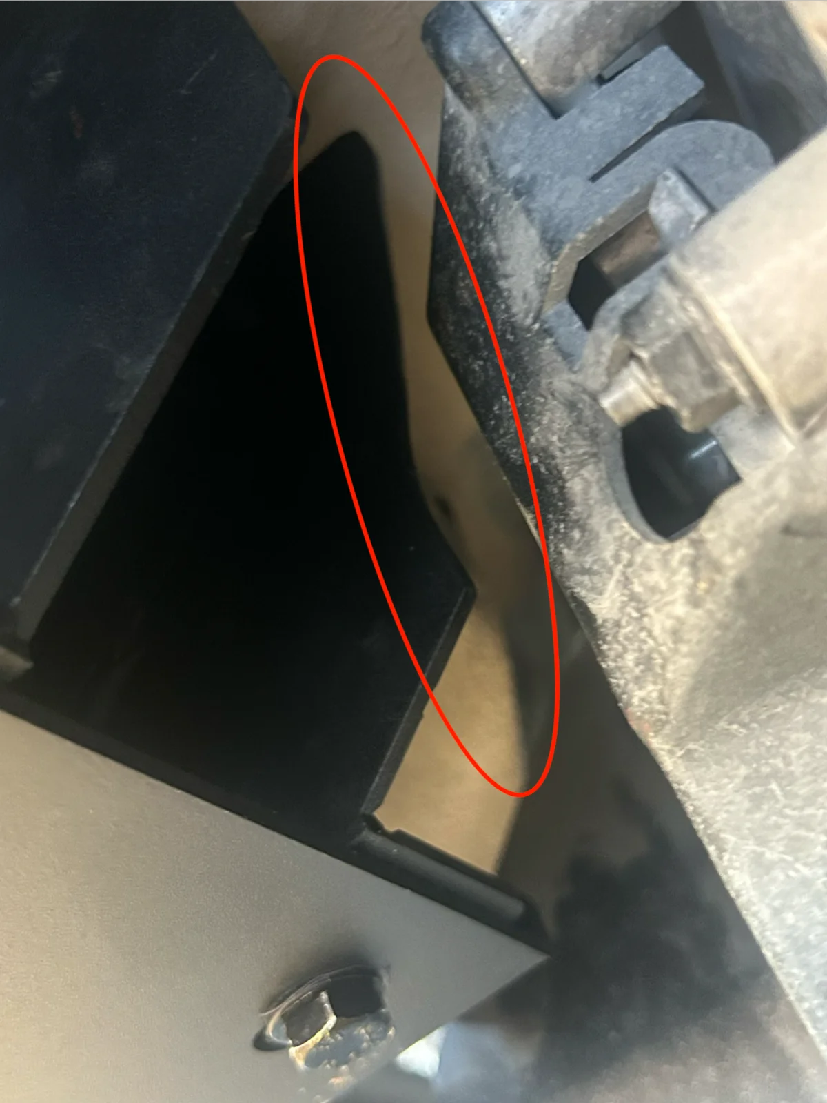

Not too bad of a "bolt-on" job. I had my friend JP come over and help. He previously installed a set on his Braptor. First, the packaging was crazy good. They wrapped all parts in this thin rubber material. The boxes were thrashed at the ends from shipping, but the rubberized wrap held up great. Our only complaint is these were first made for the 4 door Broncos. They fit just the same on our Braptors, except the rear passenger mounting bracket. the frame mounted module gets in the way. So, you either modify the module's plastic cover or you cut/grind away a small corner of the bracket to mount correctly(pic attached). I feel Turn should make a Braptor specific bracket for those that do not have the tools/means to modify. The best news is the sliders do not interfere with the Brap flaps. Sweet!! Also, the Rokblokz front mud flaps fit, but touch the slider a little bit, so I may trim them a little to clear the front of the sliders. Easy peasy. Sliders are kinda heavy, so another helper makes a difference. Overall, they look like quality sliders and I know the hold up in the rocks. Looks like they will also help with rocks hitting the bottom of the rocker panels/doors.
