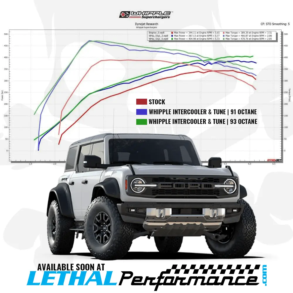

The numbers are IN! 😱 Whipple Superchargers has their tuning done for the new Bronco Raptor, picking up 60rwhp with their tune & intercooler on 93 octane. Whew!
Red = Stock
Blue = Whipple Intercooler & Tune | 91 octane
Green= Whipple Intercooler & Tune | 93 octane

Wow, if I'm figuring this correct, it's Drive Train losses are only 17.5% HP loss & 11.8% Torque loss.
So approximately 491 HP and approximately 534 ft/lbs at the crank on 93 octane?
+73 HP and +94 ft/lbs torque over stock rated HP & torque.
This is exciting, maybe hitting the speed limiter within a 1/4 mile. 🤞

Wow, look at that torque increase! 🤤

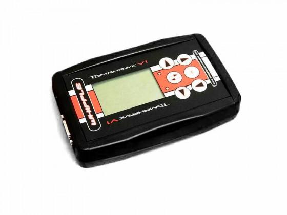

Here's a direct link to the Whipple tune and Tomahawk Flash Device:
NOTE: The Tomahawk flash device does not store the stock file for your vehicle onto it. Once you flash your Bronco with the Whipple calibration the stock file is no longer available.
To flash back to stock you would need to go to a Ford dealership.
That is correct. When I spoke to Whipple they told me that you can request a stock calibration (if needed) from their calibration department if you ever needed to go back to stock.

I'm a little surprised they don't back up the configuration before you flash, most tuners do....this give me a little pause.
Same. May be worth waiting to see what numbers the Ford Performance Tune does as my understanding is the Procal device stores the factory tune on it.
