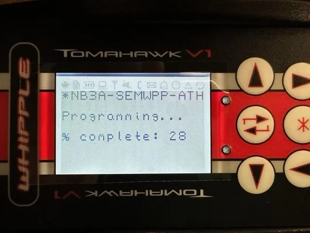

You first need to purchase the Whipple Tomahawk tuning device, but it arrives without a tune, yes an empty SD card. You need to follow the Tomahawk included directions and hook it up to your Bronco Raptor for the Tomahawk to read the VIN number *.REQ file, then email that file to Whipple. Appears this *.REQ file simply captures the VIN # for confirmation for Whipple to associate to the tune. Whipple emailed the tune file to me within a day of the request. Once you have the tune file from Whipple the remaining portion of the installation/tuning process is on your time schedule. The process is easy just follow the included directions.

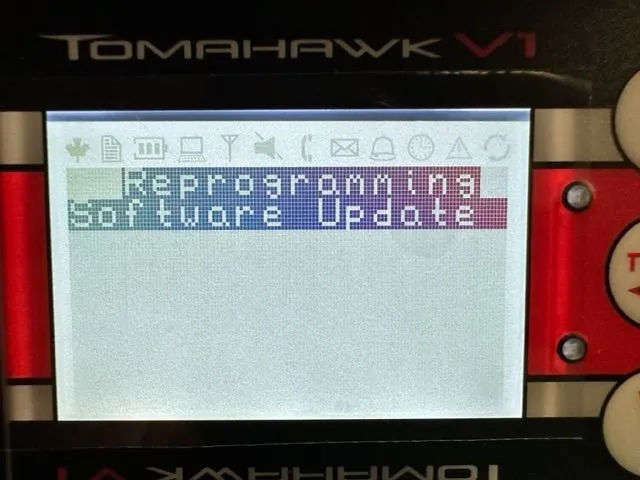

Installation of the tune with the Whipple Tomahawk device took less than 10 minutes before receiving the highly anticipated “Module programming complete!” message.
Simply follow the prompts:
As it's programming there is this status count to 100%
Per instructions I had the Tomahawk read for DTC errors, there wasn’t any found, but I choose to delete (clear) anyways, can’t hurt right... Instructions advised there may be possible errors at startup, I didn’t receive any.

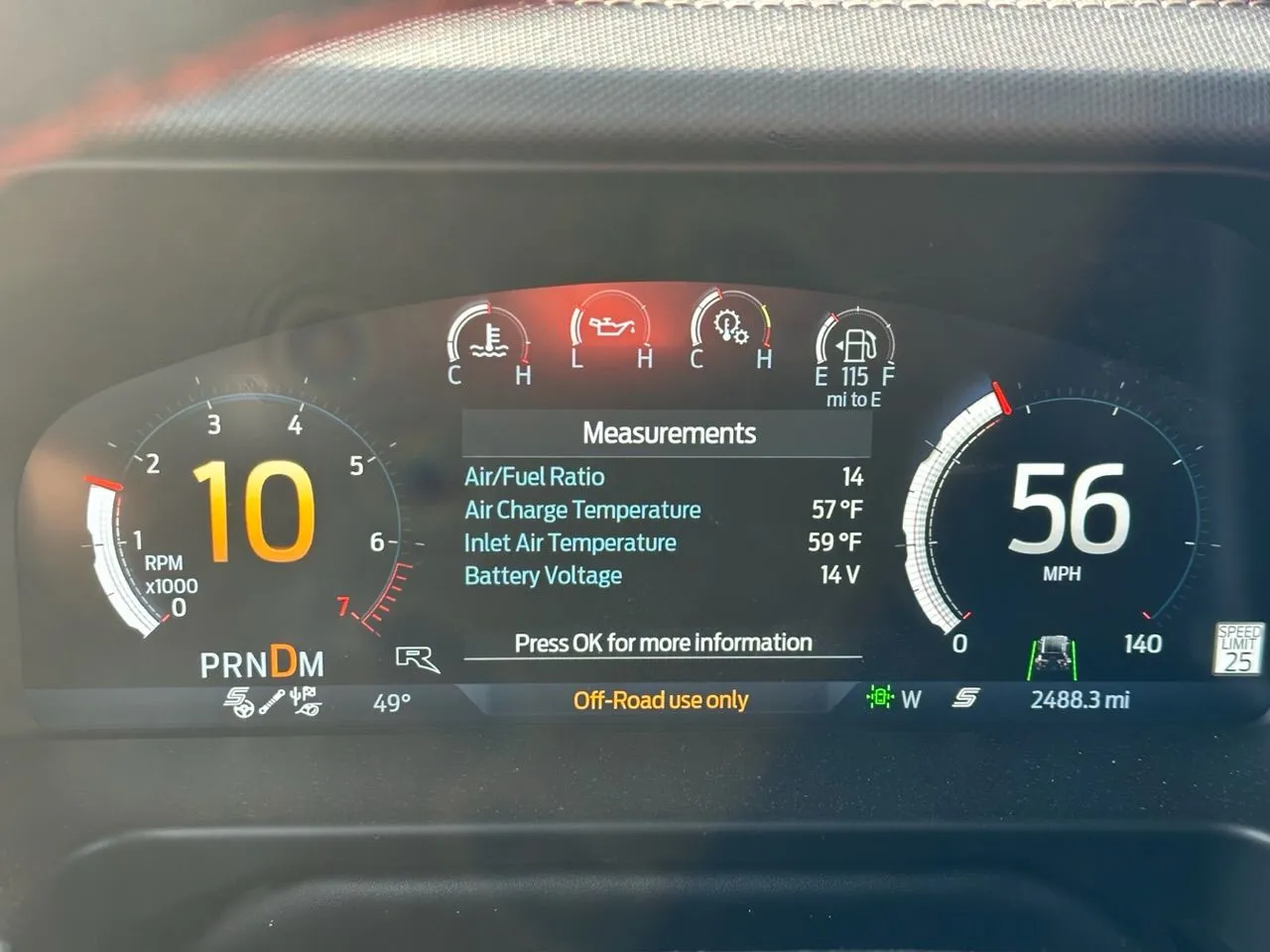

Prior to the tune, the air inlet vs air charged temp was usually in the 5-15 degree differential, with the air charge temp always warmer. However post tune, at any steady driving speed the temps are identical and sometimes the air charge temp is even lower. For some reason post tune the shutters are staying open, this seems to be a Good thing. On acceleration in the 3-5k range the air charge temp will get to ~20 degrees higher but quickly cools down when you stop accelerating which doesn’t take very long. When I tried full throttle once it exceeded 5k the air charge temperature with the stock intercooler starts rising rapidly even in 40 degree weather, one run to ~6300 took air charge temperature to 120 degrees quickly. I proved to myself we really don't need the exterior shutters on the intercooler, at least for performance. I now know I really need to install the Whipple intercooler.
I never noticed the air/fuel ratio in stock tune to vary from 14, or maybe I wasn’t paying close enough attention, but now at a steady speed it toggles between 14 & 13, so a little richer mixture. On off-throttle coasting it will go as high as 25 and I have seen as low as 11 momentarily. I wish I would have taken notice in stock tune.

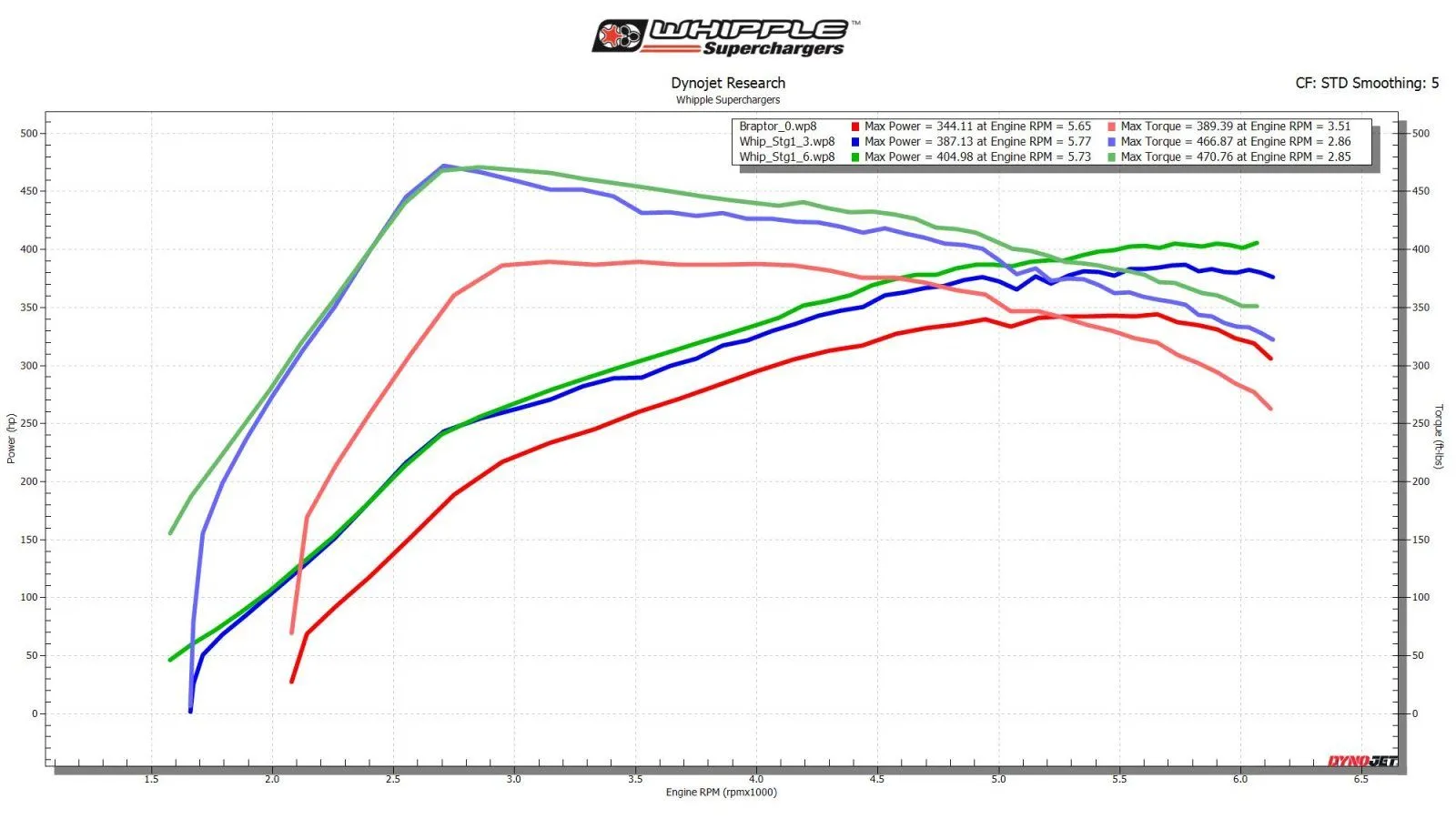

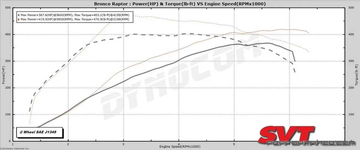

As expected, under 2k rpms there doesn’t seem like much noticeable difference in power as seen in the dyno graph below. At 2500 rpms the Whipple tune continues to increase in HP & Torque over stock, this is exactly where I feel the Bronco Raptor continue to pull hard. Overall very happy with the Whipple tune but I’m expecting to be happier post the larger Whipple intercooler installation.
Above dyno source: SVTPerformance
Update: 11/14/23, added below dyno chart from Whipple, note both these dyno charts include pulls with the Whipple intercooler and tune.
Based on Ford's ratings of 418 HP and 440 ft/lbs Torque, with the pull above using 93 Octane that is an estimated 490 HP and 530 ft/lbs Torque.
