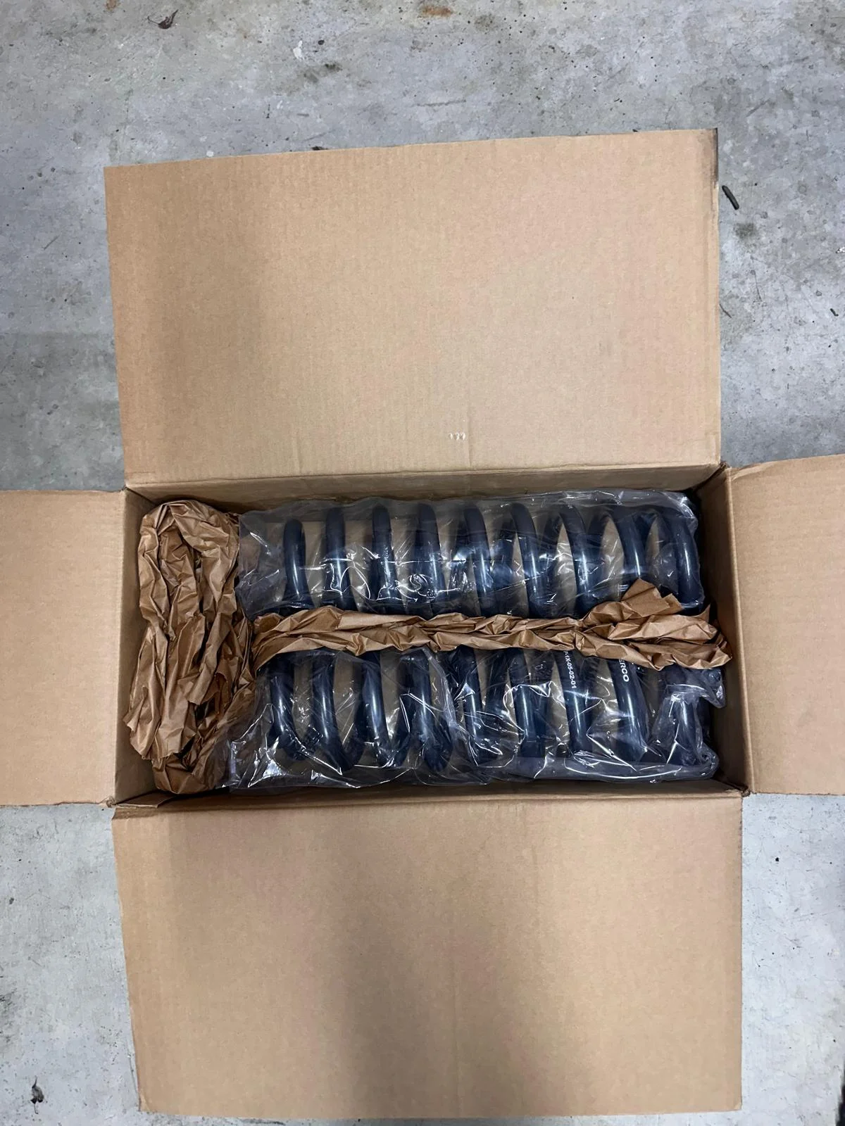

I have hypercos and top hats. There is no requirement to install the top hats, the Hypercoil springs work fine with stock.
However it appears that the point of most likely point of failure on Raptors after installing spring (or other) lifts is the top hats. So if you’re running your truck aggressively like @Dgchurch, it may make sense to add the top hats when you’ve got the springs off as there is no additional work/labor cost to do it then.
Limit straps would be the next upgrade to consider.
My general philosophy is when I’m making changes outside Fords engineers original specs, upgrade for reliability. This approach makes mods more expensive, but may better reflect the true cost of making the change.
Yep, agreed. Got the springs in. Top hats come in today. Install tomorrow!!!! wooooooooo.....
Thank you for taking the time to explain it to me, that's ones of the many things I like about this board, so much knowledge and not afraid to share.
Are those lift springs powder coated?
According to our good friend AI:
Yes, Hyperco springs are typically finished with a durable blue epoxy powder coat,
which provides excellent corrosion resistance and protection for the high-tensile chrome silicone steel. This signature coating is standard across their various product lines, including coil-over and conventional springs.

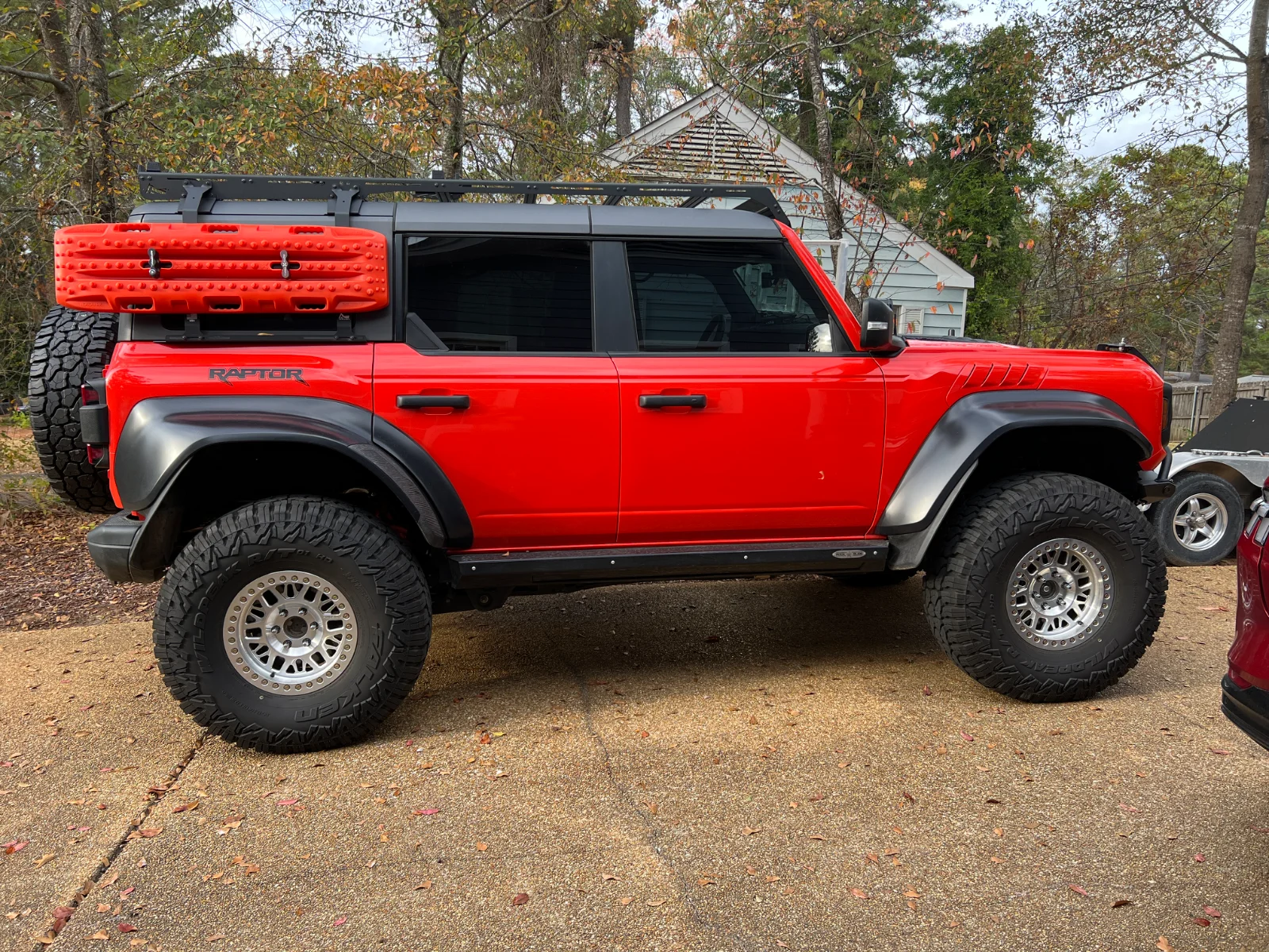

As a review: My overall experience thus far has been very positive with the 2" Hyperco shocks, FMI no lift top hats and 39" KO3 tires with D sidewalls. The on road manners are essentially stock, which I value quite a bit. Off road there is more stability and functionality. I haven't noticed a drawback to date.

I just finished a pretty long trek from Sacramento to the Mojave, camping for the week along the way and home with @JohnGalt. Balance seemed fine throughout. Not as good as the stock 37's or smaller tires but not bad either. Nit picking.
When I first got the 39s, there was a shimmy. I took it to an off road shop and they were able to both Static and Dynamic balance and the shimmy went away. That would be my only recommendation - have a 4x4 shop that deals in large tires balance. It'll be worth the cost.
I hit a good chunk of Rubicon Sunday with @JohnGalt on camera work, via Wenthworth Springs and the old entrance. The set up worked amazing. A little tire rub on the rear bumper at one or two points during the day but with 39's and 2/2 hypercos it was a much better run. Watch my debead at about the 13 min mark if you wanna see a rookie move!!! duh..... :)
