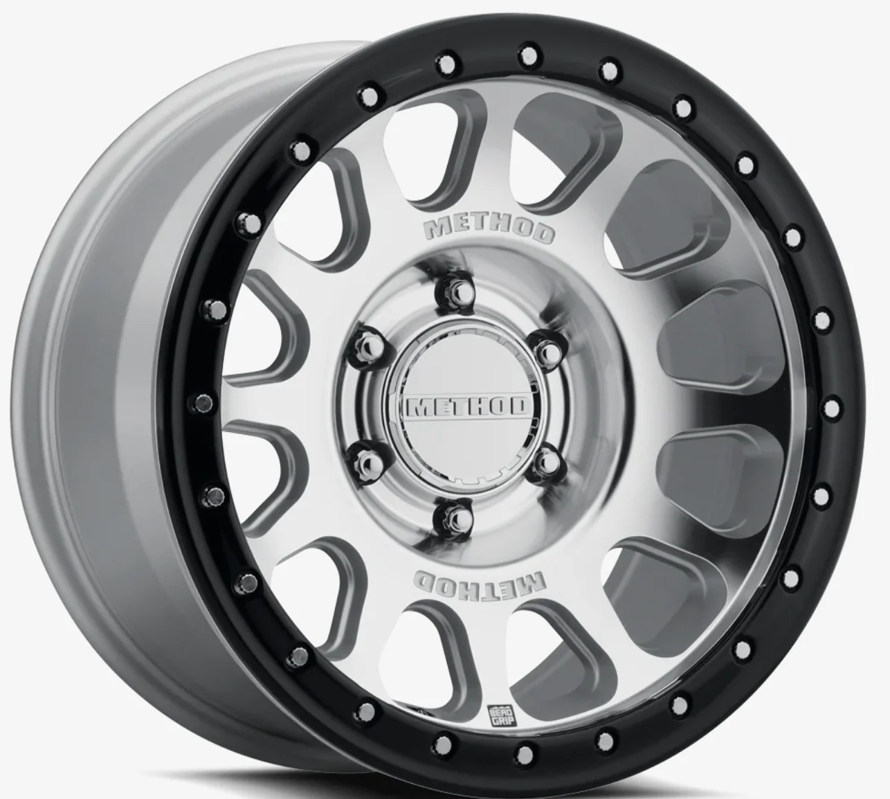

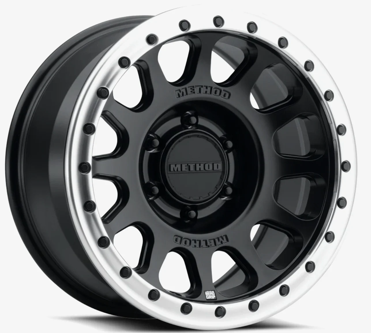

I want new wheels for my 2026 Bronco Raptor. I have an oem stock gloss black cast wheel. Decided on Method bead grip wheels and probably 709HD with the removable rash ring.
I was considering the Icon Recon Pro 17x8.5 et6 but they are lug centric and not hub centric so they are off the table!!!!.
The Method 709 17x8.5 can be ordered as et0 offset or et25 offset. The 709HD also has the correct hub size at 87 so the wheel is hub centric. I see some here doing 0 offset but that is a big deviation over stock suspension geometry. Where et25 is only 9mm difference from stock and this won't mess with scrub radius too much. I do not want to rub and knock off a fender and I do not want to change the stock Bronco Raptor suspension. Pushing wheels out as far as 0 offset I worry about causing damage.

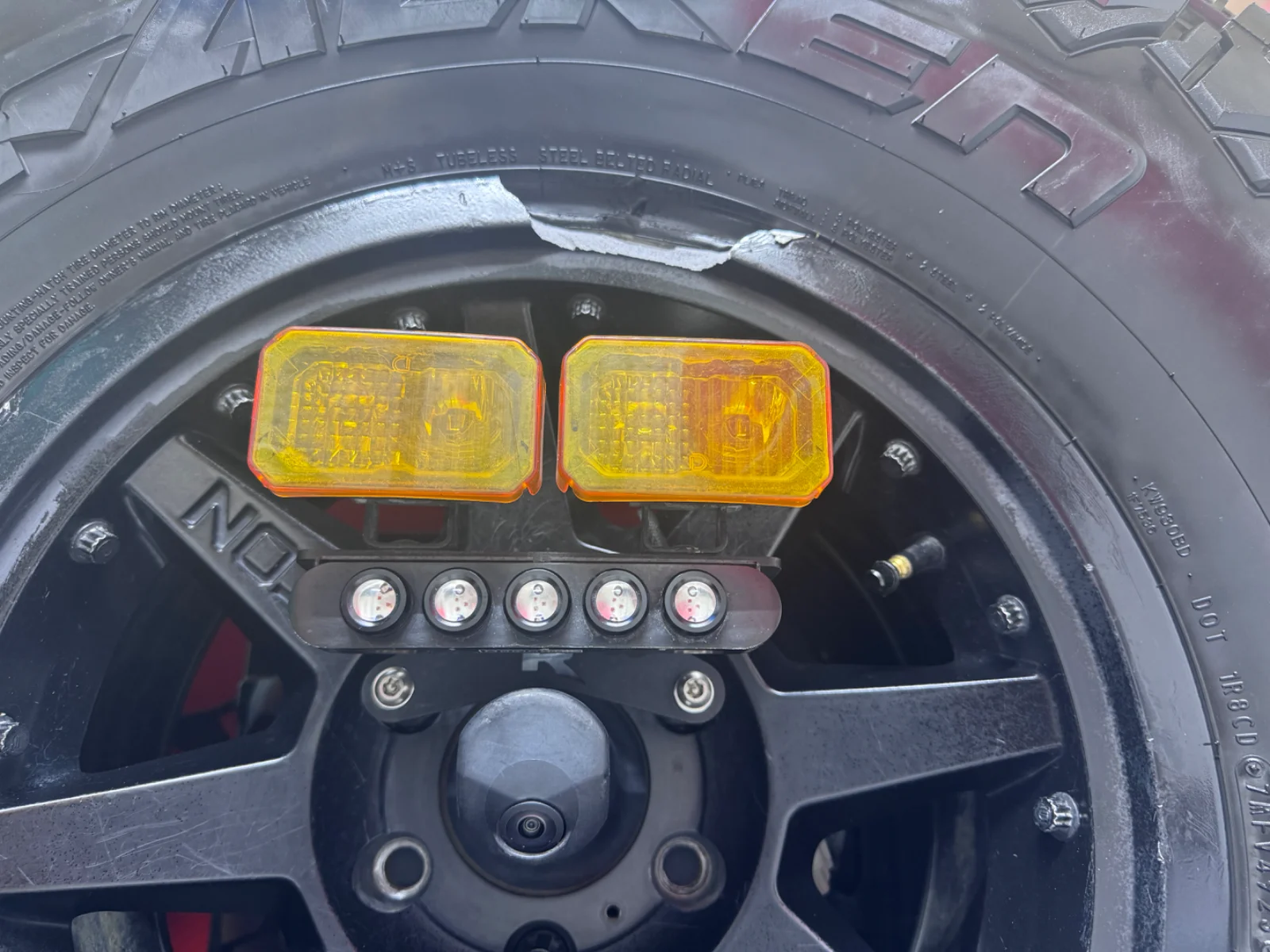

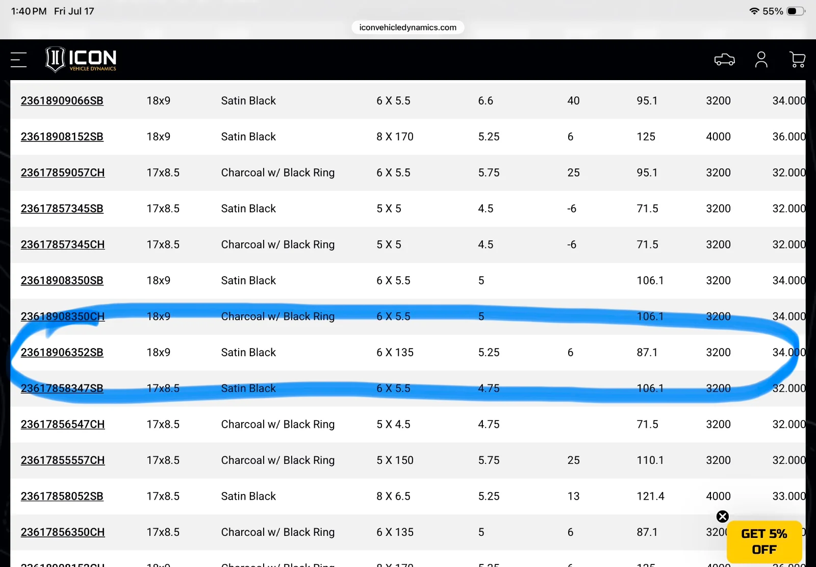

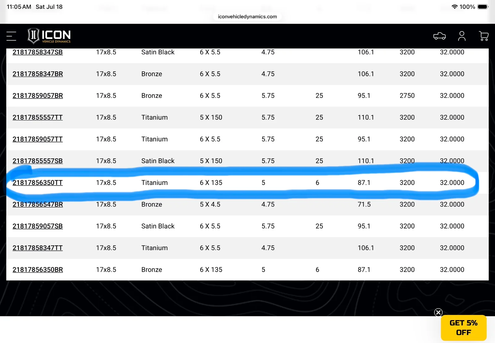

Icon Recon Pro is DEFINITELY hub centric with 87.1 bore for Bronco Raptor in a +6 offset, 6x135, 17x8.5” in Satin Black, possibly others. I have Rebound Pros with same specs. See attached pic.
It’s possible you’re looking at standard Bronco hub bore?
I have Rebound Pros Installed for about 3 years now. I Wheel extensively, and had them at single digit PSI on many occasions never lost a bead. In fact I hit a very big boulder in Mojave and broke a 2-3” chunk out of the rim bead (see pic), didn’t lose bead or leak. I then drove another 40 - 50 miles of trail and swapped in the spare at camp that night.
The Methods are light which is great, but Rebound Pros are almost as light and crazy light for the actual beadlocks.
If you wheel in rocks, the valve stem on the Rebounds is deeply inset, not sure about Recons. The Method beadgrips (which are also fine wheels) all have the valve stem very exposed to rock strikes.
I’ve got two friends I wheel with almost weekly running Method Bead grips, beside the valve stem issue, I’ve seen them lose a bead twice once on the end of an unseen log end in deep snow hitting the sidewall just right and once descending at the bottom of the Whale Bones on the Rubicon slipping off a rock in a full lock turn (it was extreme situation!). Their big advantage is they hold a bead really well AND a tire shop doesn’t charge extra for mounting.
So for the Recon Pros expect to pay $25-50/wheel for mounting. It’s a lot of shop time to remove and replace all those bead retention bolts. But the wheels are DOT legal so any shop will mount tires for you vs. standard bead locks.
Lastly with the +6 I’m running 38x13.5” tires without rubbing in very articulated situations if that’s of interest. Plus the +6 gives enough poke to keep my flares off the rocks, haven’t lost one…..yet.

Those are 18" I need 17" in 8.5" width 6x135 with a 87.1 hub

Yikes, sorry I grabbed the Recon Pro specs too quickly. The Rebound Pros I have definitely come in 17x8.5, hub centric but they are +6. I’ve had zero issue with rubbing, flare contact and I’ve had mine airborne and fully flexed out on numerous occasions.

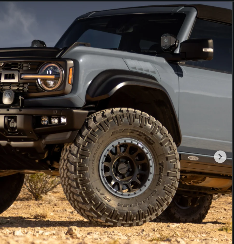

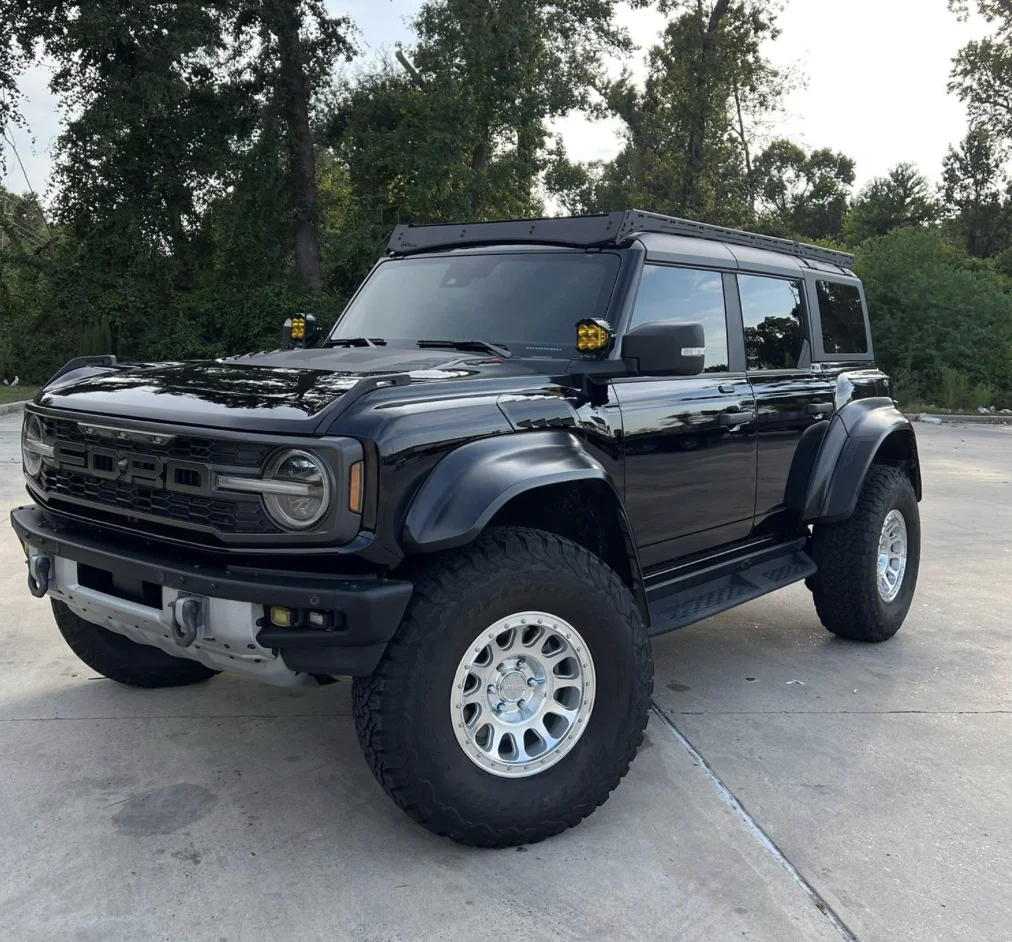

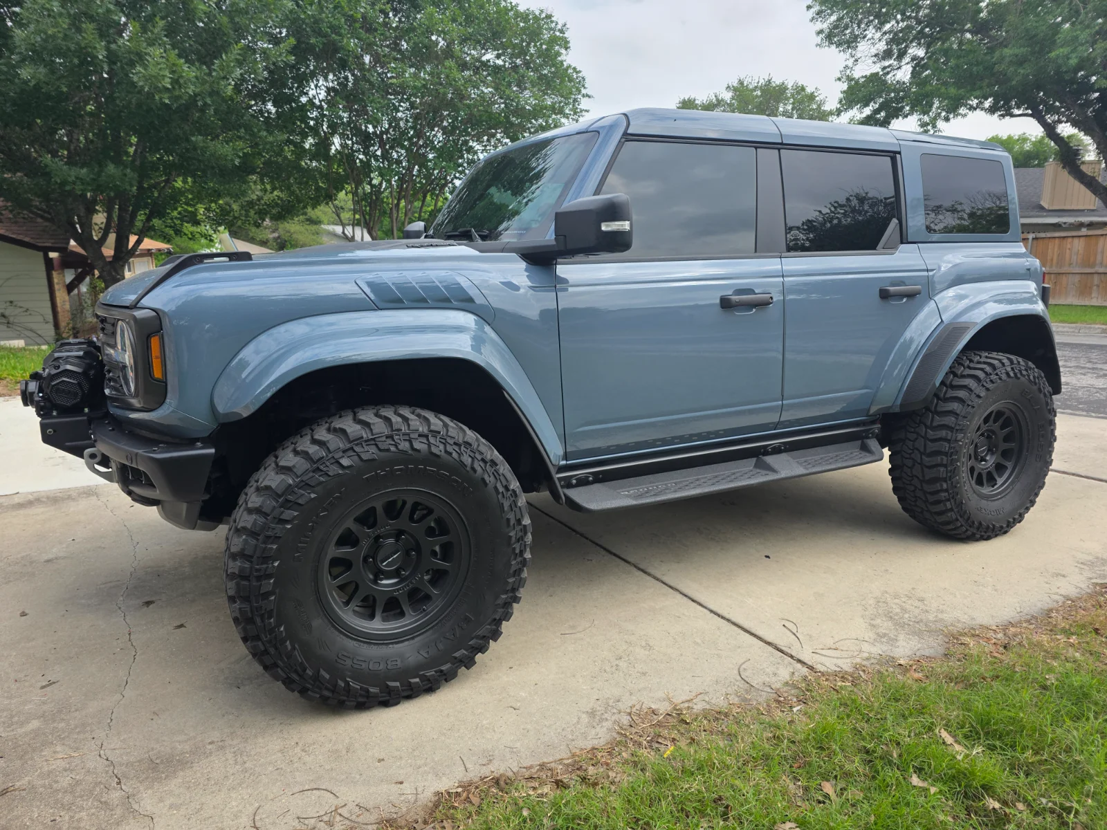

I don't know about weight but I love the Method 703's with Mickey Thompsons. You get the benefit of beadlock without the ring. I've run at 4 psi with zero issues.

What offset did you go with? Those come et25 and et0 like most Methods in this size for our Braptor. Thanks! 😊
Also those are classic and will always be in style. I’m looking at the Method 709HD but I also keep going back to a simple classy wheel with the great benefit of bead grip like these 703’s.
My buddy runs the 703's. They look good. I, too, am looking at the 709 HD's. Both are good style wheels. I like the idea of having a removable/replaceable ring. They are a few donuts lighter than the Braptor beadlock capable wheels. I think 36lbs vs. 34lbs for the Methods. 703's are even lighter.
