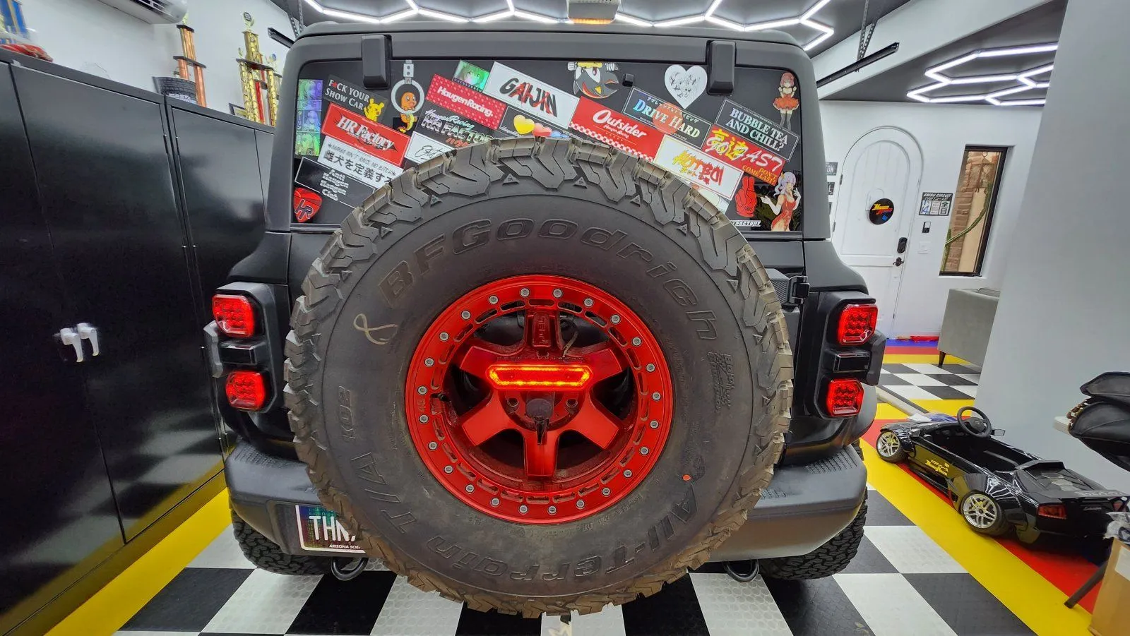

I have the rigid. Just bend the bracket and get your own lug nuts and bolts. Wasn't too big of a deal
I have the rigid. Just bend the bracket and get your own lug nuts and bolts. Wasn't too big of a dealView attachment 10657
Cool. Thanks for the response. It looks super clean from this angle. Which bracket is this? Did you use someone’s harness or wire freestyle? TIA
It's just the bronco bracket. I just bent it to fit our bolt pattern. It comes with a harness and you just chop the 3rd brake light harness and wire it in
