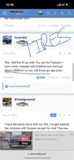

Also spedo is off a little
When I’m doing 55 my GPS says about 62
When I’m doing 63 GPS says about 70
that’s also my fault partially
As we were in such a rush Friday night to go home
I was not able to use the scanner and reset the wheel diameter to that maximum number
If I’ve done my research right, it would be this number that I found using the search function
