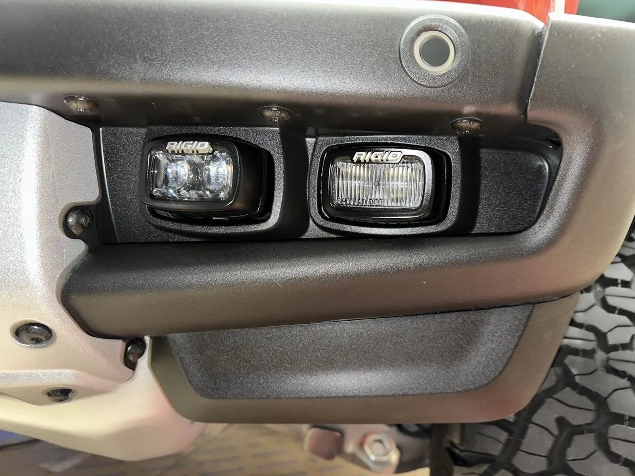

Upon installing the Ford Performance Rigid off-road driving lights I discovered the passenger side fog light bezel was missing, looking back at my photo's and I discovered it was delivered that way. I called my Ford dealer and no problem, he said I'll have my parts guy (George) order a new one. Well, the bezel is shown in the parts catalog but it appears to come with the duel fog light assembly at $550 dealer cost. Couple days later assembly arrived at my dealer but without bezel attached, so to confirm, puzzled George found another Michigan Ford dealer with the same fog light assembly in stock so he called that dealers parts guy and it also didn't have a bezel attached. Even more interesting, is that dealer also ordered for the exact same reason, customers Bronco Raptor was missing the passenger side bezel but they hadn't found the correct part (bezel) number yet.
George then called his internal Ford contacts, nobody seemed to know the part number. George being a career Ford parts guy set out to figure out what the part number should be based on the F-150 Raptor bezel part number, made his best guess, and ordered Not knowing if it would be the correct bezel. Well, George was spot on.
To install the part I needed to remove the fog light assembly, took about an hour to complete but it looks so much better.

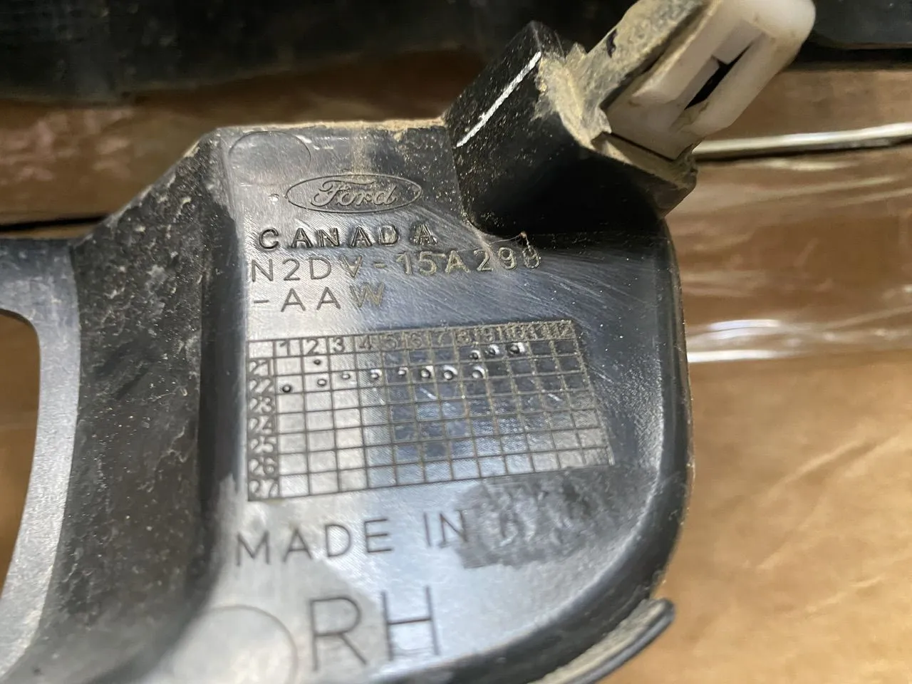

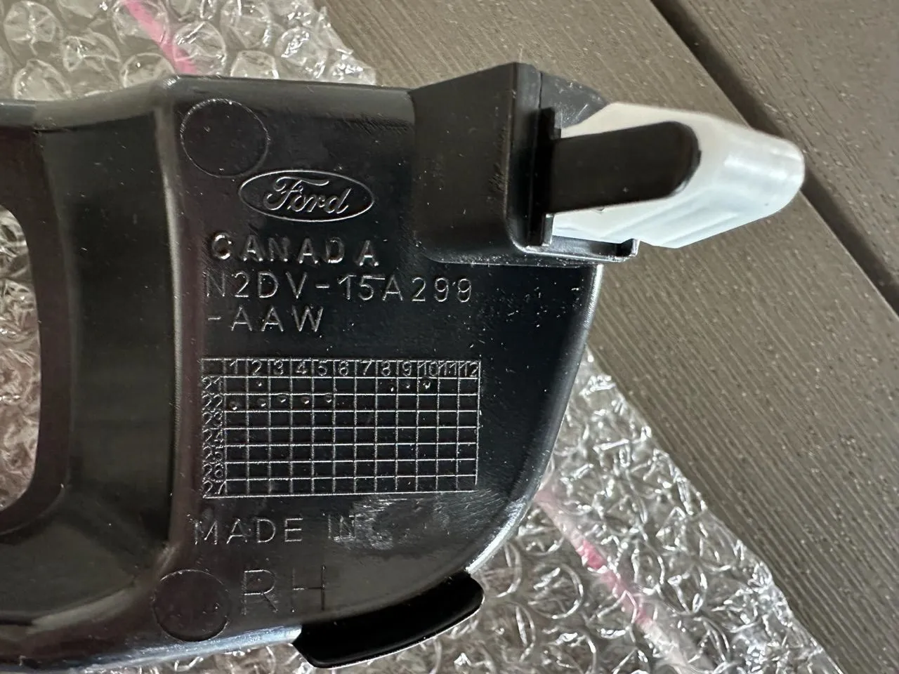

Passenger Side (RH) fog light bezel: N2DV-15A299-AAW

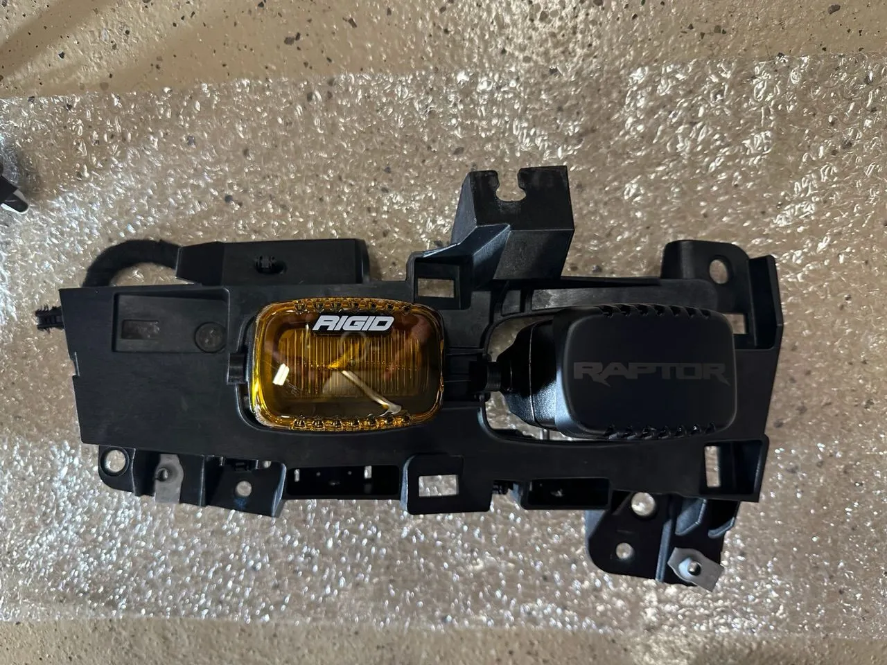

Fog light assembly removed
Before pic of passenger side missing bezel
Drivers side with bezel
Install completed
I'm posting the part number here in case anyone else is missing the left or right side bezel, so you can provide this undocumented part number to your Ford dealer parts guy.

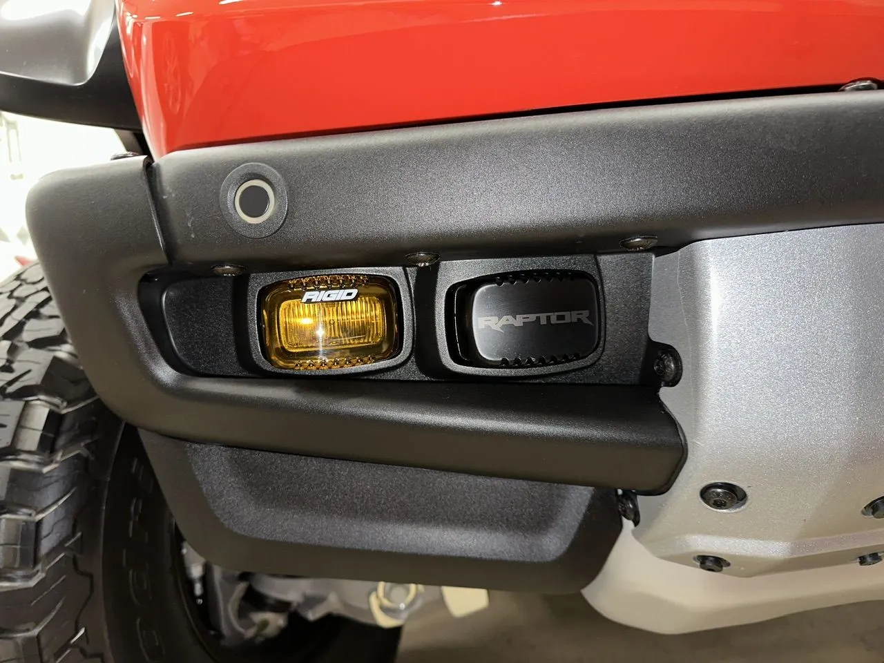

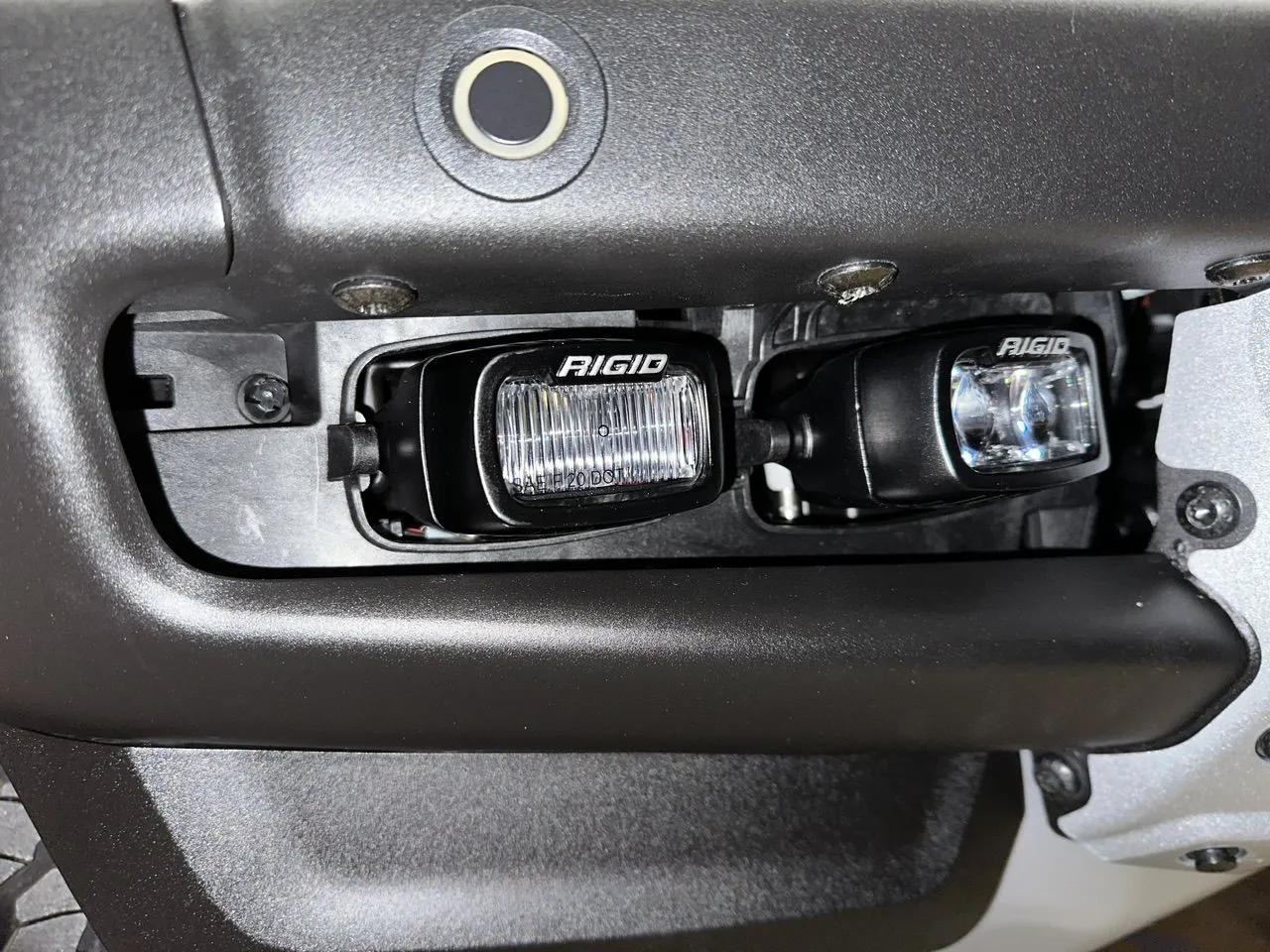

I took mine off so I can use the AUX-1 lights anytime I want. Same with my light bar, Aux-6, and rear Rigid cubes, Aux-2. Also removed the plastic "air dam" trim that hangs down from the fog/driving light area.
@TurboS , did you put an amber film on your fog light or buy a new light?

The amber fog light is Rigid amber fog light covers from Lethal Performance.

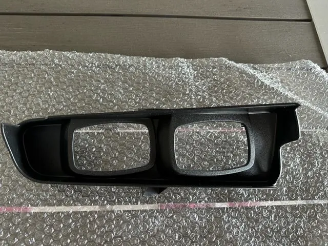

@ChiliPepper , the needed LH bezel part number is on the backside of the bezel which may need to be removed (snaps on/off) from the fog light assembly to see. As of winter 2023, there wasn't any listed part number for these bezels. If you could check for @Alburkatusmc tusmc that would be very helpful. Thanks in advance.

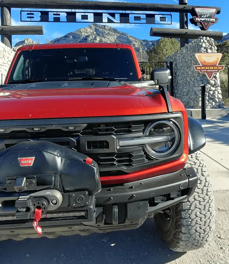

I took mine off and replaced them with the Baja Designs kit. Walked outside and snapped a quick pic of both sides.

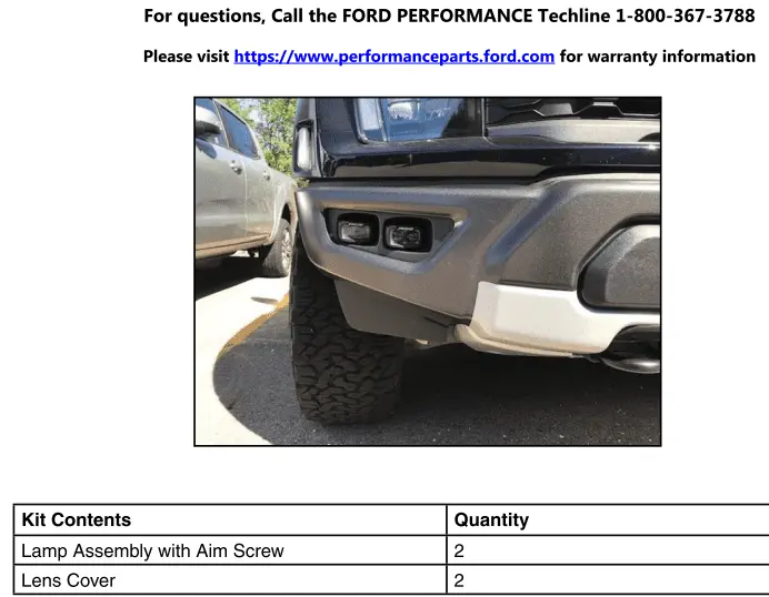

Some confusion on my part regarding bezel vs. lens cover.

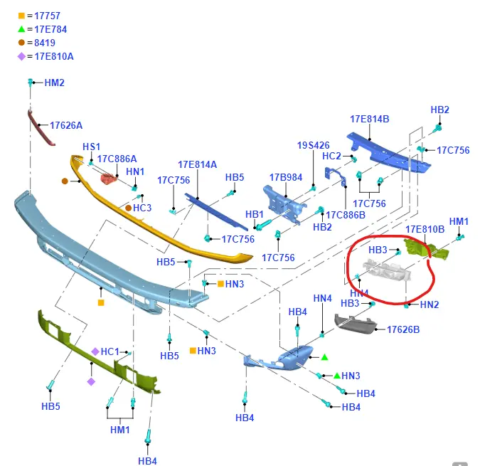

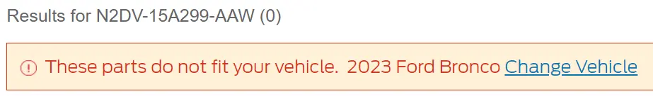

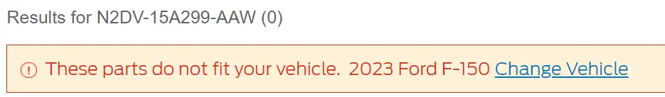

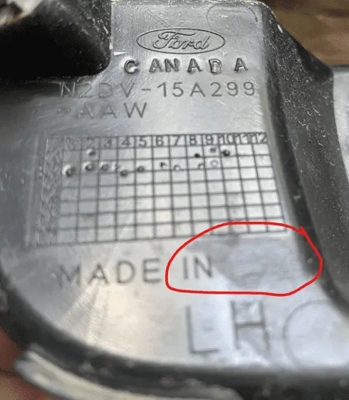

However, as noted in post 5 of this thread, the official Ford parts catalog shows no PN for said bezel; either F150 or Bronco Raptors. See parts screenshot. It almost appears as though these are non-Ford parts obtained through Ford Performance or a 3rd party. That said, the photos show there is clearly a PN on the fog light assembly. Maybe you need to go to Canada?
:unsure:
Interesting decoder ring for Ford PNs. Does not seem to work for the PN in question.

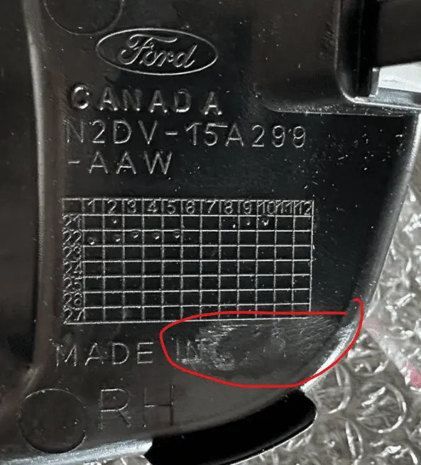

Something hinky going on here with the "origin" country. Why does it look look the name has been removed? And CANADA stamped under the Ford oval?

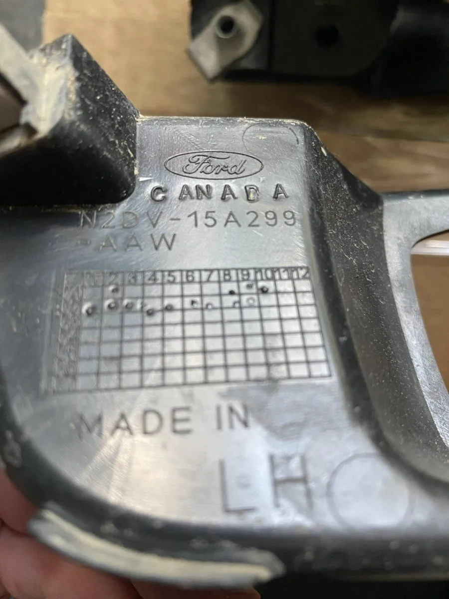

View attachment 9172 View attachment 9173 View attachment 9174
You’re definitely right about something being odd about the country of origin being sanded off and “Canada” being stamped on it.
There’s another number on the opposite end of the part, but not sure it’s a part number.
I checked every number on that thing and nothing dealer also has no clue

Right, that's the capable bumper. The screenshot in post 5 is the best I could find for BRs and modular bumpers. George probably saw the same thing earlier. ;)
