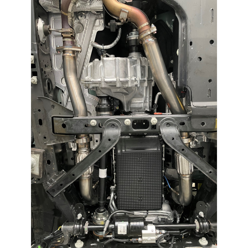

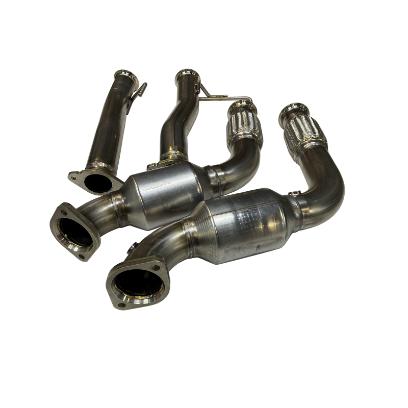

I'm expecting this exhaust mod to have the largest increase in HP & TQ over any other exhaust mod. I modified my Cayenne TurboS with same type of mod and the difference is drastic. On my Cayenne before I was always selecting sport mode as the Garrett turbos are continously spooled up just like our Bronco Raptors are in Baja Mode. After replacing the downpipes and secondary cats with 3" custom mandrel bent pipes my normal mode is much more responsive than sport before. It's more than just increasing the HP but how quick the turbos react with less back pressure.
"Needing more performance, MPG's and sound from your 2022-2023 3.0L Ford Bronco Raptor? Look no further! All of SPD's catted downpipes use the UHO ULEV EPA approved catalytic converters or GESI G-Sport UHO EPA catalytic converters and larger 3" diameter mandrel bent tubing which improves throttle response, mileage and overall performance while reducing turbo lag and exhaust temperatures (EGTs). Our downpipes do not require custom tuning and can be used as a factory downpipe replacement. Our catalytic convertors are made in the USA and are designed to be used in racing applications.
P/N DP30BR23SS MSRP $1699.00"

What is the install like? how many hours?
From the looks on our Bronco Raptors it shouldn't be too bad. If you don't have a good selection of socket extensions you will by the time you complete this install. The Ford repair manual should have number of hours for replacing a downpipe/catalytic converter. I'm guessing a couple hours per side.
Does this install void the manufacturer's warranty?
Not sure, I wouldn't expect it to void the warranty, at least not in Michigan, state laws may vary when it pertains to emissions.
thanks! I have a few extensions... lol
Just checked on my BR, OEM downpipes are one piece on each side to the muffler flange. Looks like the stock pipes get cut out or need to also remove the trans brace to remove each side in one piece. I will probably remove the trans brace to preserve the OEM pipes, and I seem to always take the more difficult route.

Looks like they have an option for an upgraded GESI Spor Catalytic converter which increases the price tag by $1100.00 ($2800.00 total). I contacted SPD about it and here was their reply:
"In all of the videos we have on our website, ceramic core cats were used (non-premium).
The GESI cats (premium) will flow 20-25% better than the ceramic core cats. They have a stainless-steel core that makes them virtually indestructible. The ceramic core is what OEM cats have so the quality is very good but they are limited to about 800rwhp worth of air flow. Any more power than that and you will destroy the core."
I',m not sure if almost double the price is worth the spend for the upgrade. Seeing as the stock engine on our Braptors puts out 418HP...even with adding a cold air intake, and software upgrade, in addition to these downpipes, we can probably add another 80-120 HP...far from the top rated 800hp capacity of the stock ceramic Cat. Maybe not worth it?? Any immediate thoughts, or flaws in my logic?
Looks like they have an option for an upgraded GESI Sport Catalytic converter which increases the price tag by $1100.00 ($2800.00 total). I contacted SPD about it and here was their reply:
For myself, I will probably go with their standard high flow ceramic core cats. Unless I was building the engine to the extreme for competition, I don't think I would realize the extra value in the $1100 upgrade.
Considering the best scenario, the 3" downpipes alone, even without cats, may bring 10% HP gain, and the upgrade to GESI cats is at best 25% of that 10%. So if other engine mods brought the 3.0L to 500HP (unlikely) the 3" downpipes would add 50HP, and the GESI cats would add another 12 HP (at best) for $1100. I know from experience that adding 10-12 HP to a 500+ HP street car is not enough for myself to notice, not to mention off-road in the sand.
Ideally we need some 0-60 times for stock, vs. SPD ceramic cats, vs SPD GESI cats, vs... 3" downpipes no cats.
