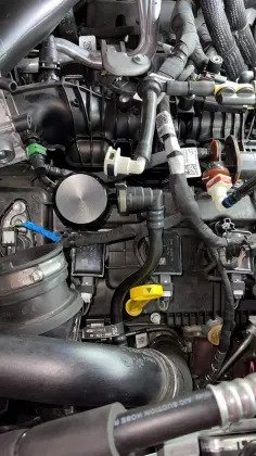

Just got some pics from Steve over at UPR. He’s got the single valve setup done and it came out great. He’s working on the dual valve setup today. I’ll be sure to post more pics as they come in.

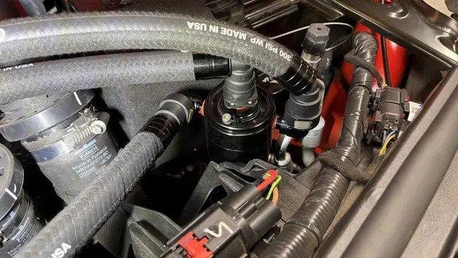

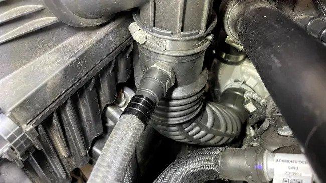

The UPR Bronco Raptor dual valve catch cans are now live and available for purchase. This is the same one that they used our Braptor for to test and develop the kit. I haven't checked the can for oil yet but will follow up with a video once I get a moment to check on it.
In the meantime here's the link and some pics of it installed on our Braptor. If anyone has any questions feel free to reach out and we'll be glad to assist you.

Yes, that is correct. Single valve catch can requires no modification to the factory tubing or anything that cannot be simply put back to OEM, therefore making it untraceable. In theory, it could take less than a minute to remove it if you know what you're doing.
And correct, the dual catch can does require the modification to the turbo inlet tube that isn't easily reversible. Another thing with the dual valve is the addition of a CSS (clean side separator) to the driver side valve cover. This can be removed as well and without irreversible modification, but just an additional step with the dual valve.
