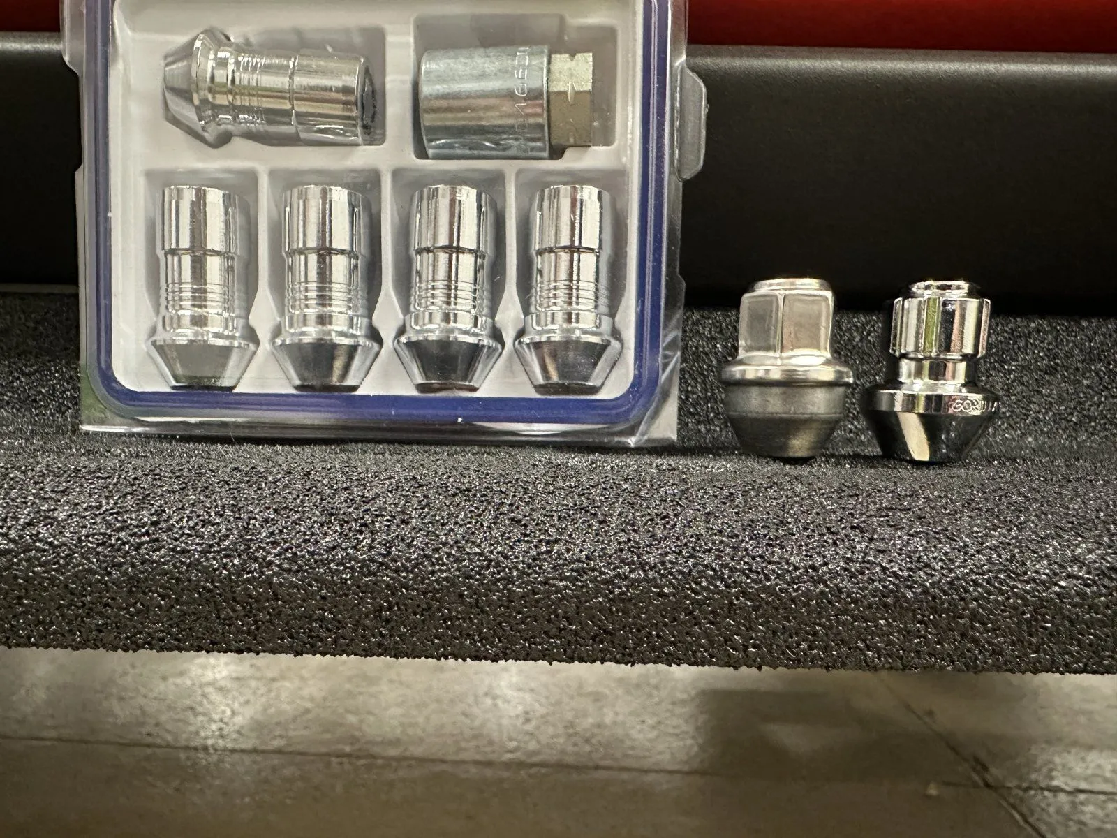

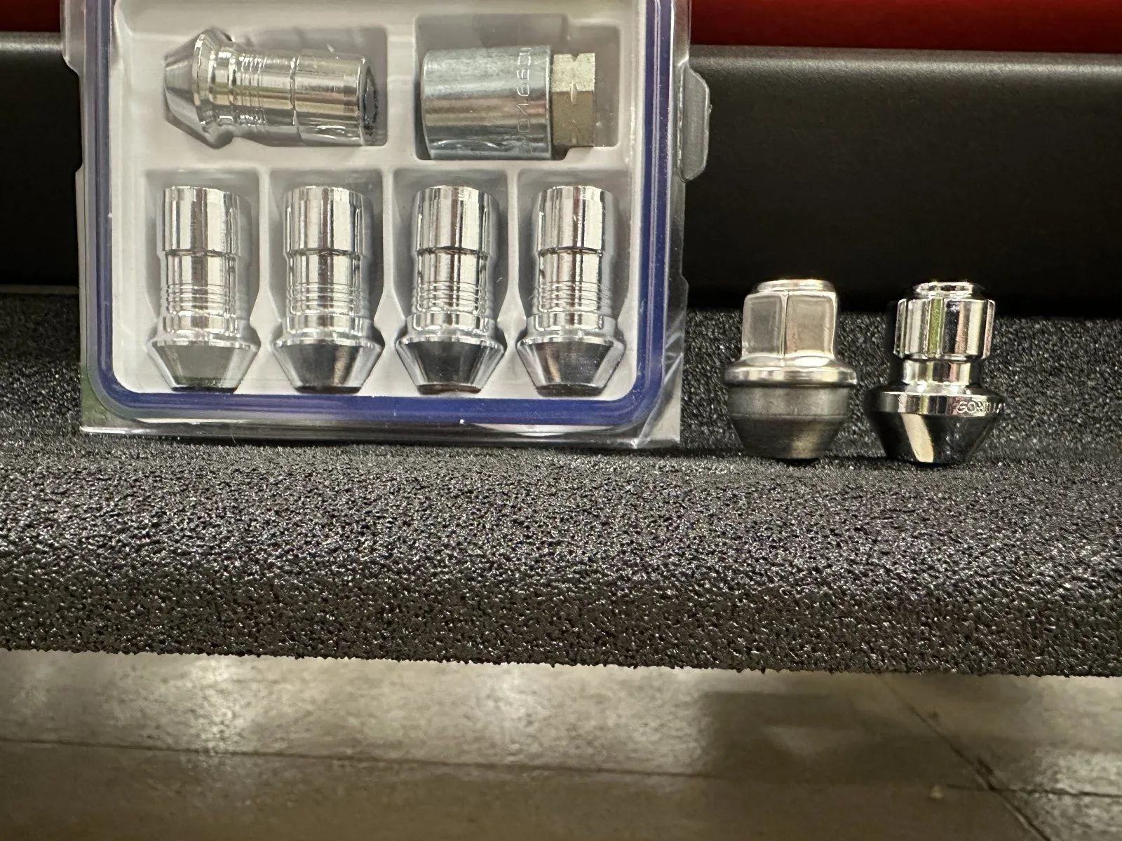

So, I get my new Bronco Raptor home, I pull off one of the spare tire lug nuts, and of course the locks are about 1/4" longer that the Ford lug nuts, not even close to similar. So I ordered Gorilla Factory Style Buldge wheel lock kit which is the same length, ~1.62" long, as the Ford lug nuts vs the Ford McGard locks that are ~1.87" long. Ford kit was $99, Gorilla locks from Summit racing was half that. I think these look much better, I may purchase all Gorilla lug nuts later just so they are all Chrome. I have ran the Chrome Gorilla lug nuts and locks on my Wrangler thru 3 Michigan salt spraying winters and there isn't any signs of corrosion.

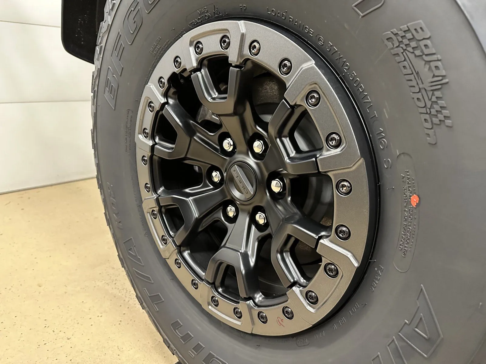

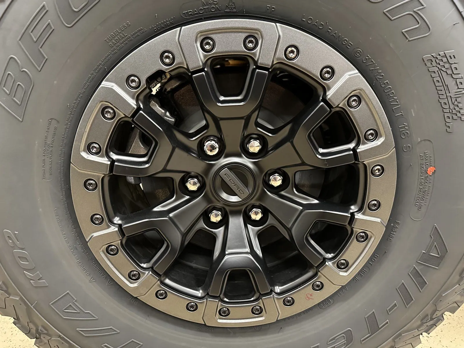

Left to right: Ford lock kit, Ford wheel lug nut, Gorilla lock nut

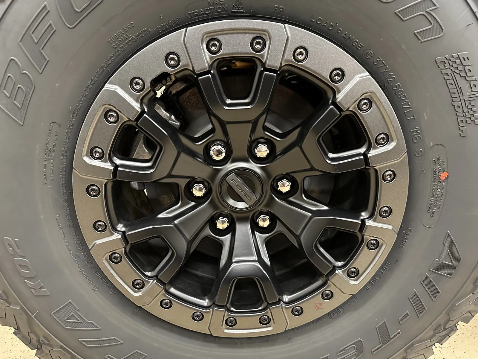

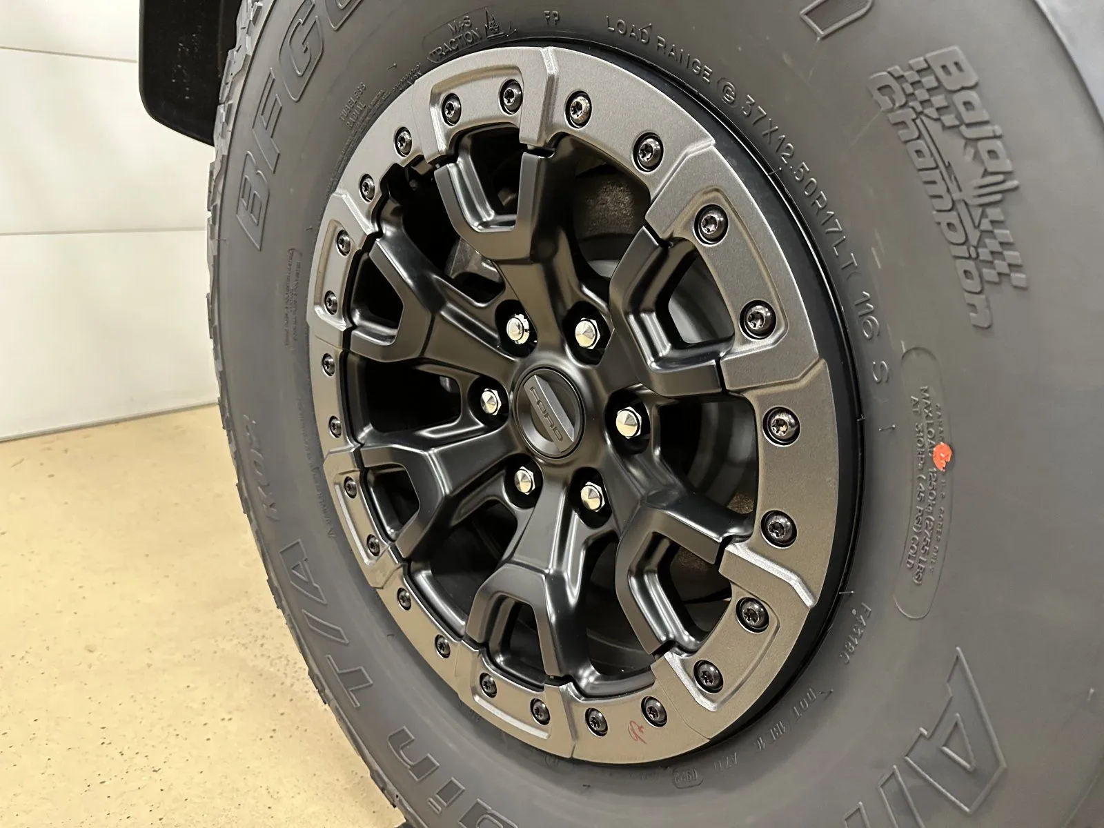

Gorilla lock nut installed

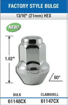

For reference here is the matching Gorilla lug nuts (to the Gorilla locks as shown above) 14mm x 1.5 in the 13/16" socket size, same size as OEM

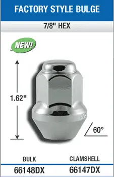

However, the diameter of the Gorilla locks where the socket fits is .900 in diameter, therefore these 14mm x 1.5 in the 7/8" socket size may match even better.

Left to right: Ford lock kit, Ford wheel nut, Gorilla lock nut
