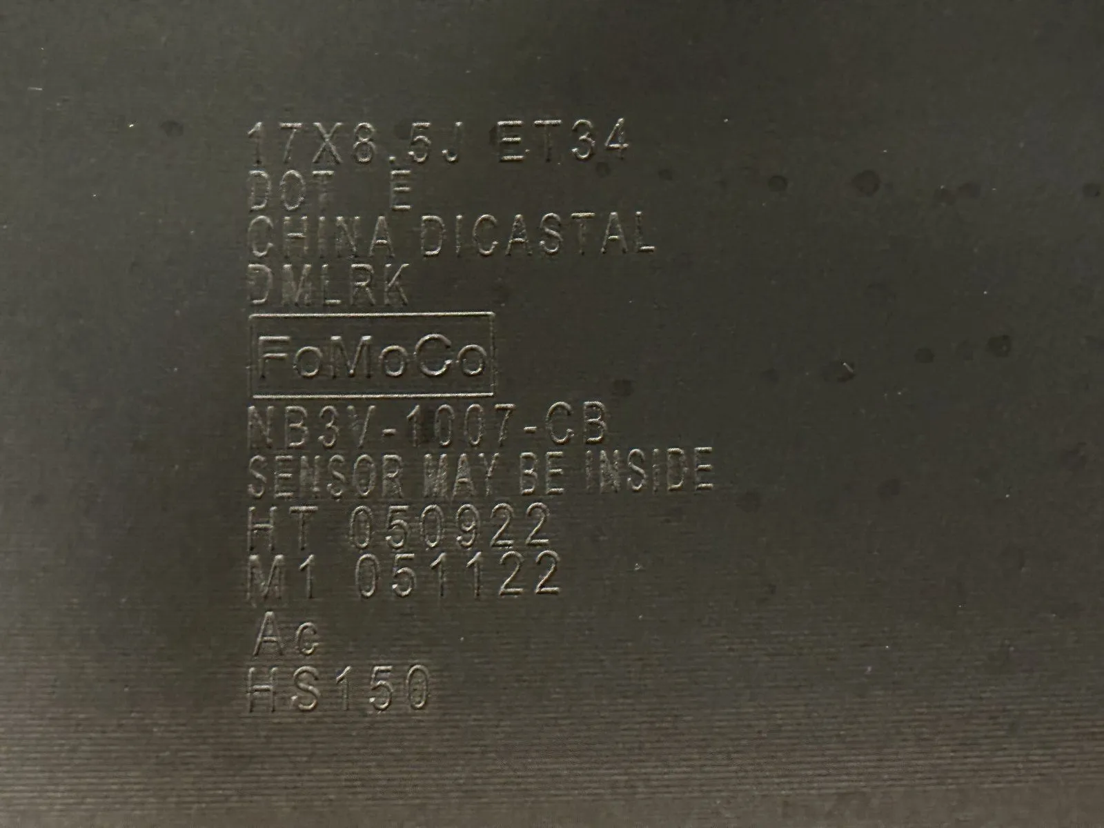

Our Bronco Raptor Forged Beadlock-capable OEM wheel weights about 36.4 lbs. 17x8.5 with +34 positive offset.
Weighted the spare tire/wheel combo on a bathroom scale, maybe not the most accurate so I tried a dozen times. highest was 102.2, lowest 101.4, most common was 101.6 reading.
So, if we use 101.6
minus 2.25 oz wheel weights, -.14
minus 3 oz for motorcraft TPS, -.187
minus 64.8 lbs for the KO2 according to BFGoodrich site.
Totals to approximately 36.4 lbs., a little lighter than I expected.

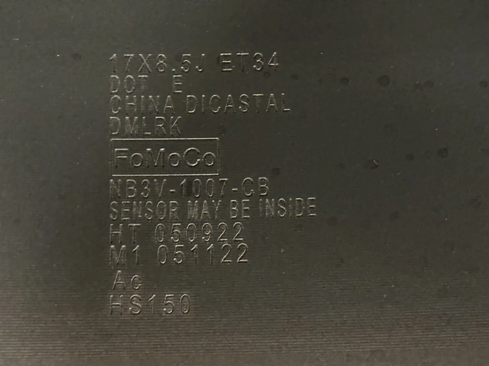

Our Bronco Raptor Forged Beadlock OEM wheel weights about 36.4 lbs. 17x8.5 with +34 positive offset.
So, if we use 101.6
That's a lot more offset than I thought it would be. So if my math is right then 0 offset aftermarket wheels will poke out about 1.3-inches more per side than stock wheels?
Yes
