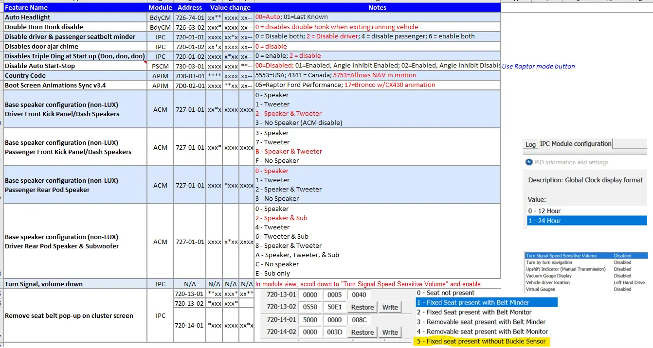

Haven't used FORScan on the Bronco Raptor yet, but I have on wife's Bronco Badlands. Link below to Bronco Module/Address/values spreadsheet.
Google Bronco Module mapping spreadsheet for use with FORScan.
I used that sheet on my 2023 BRaptor,
Lights, chimes, seatbelts, cluster and others… works great.

Made several changes and the only change that did not work was the Auto Start/Stop disable.

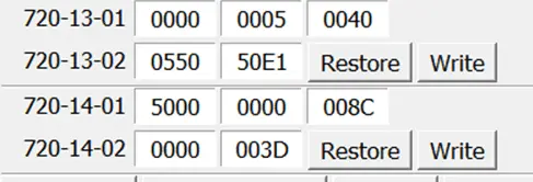

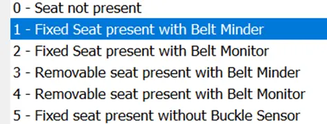

Ok, after a couple hours of fooling around, I wasn't keen on just zeroing out the 720-13 and 720-14 blocks without knowing what they controlled. When using FORscan, it is often easier to use the module mode instead of the "as-built data" mode.
Navigate to the IPC module as @BlackOval noted, then scroll down to Seatbelt Configuration. The Bronco Raptor only has seats in Row 1, Col 1 and 5; Row 2, Col 1, 3 and 5. The default setting is #1. Choose setting #5 on all active seats to remove the seat belt pop-up menu on the cluster screen. Write the new settings to memory.
My as-built data from Ford (before changes are highlighted). To get a copy of your data go here.
720-13-01__ F100_0001_002D
720-13-02__0120_207D
720-14-01__ 2000_0000_005C
720-14-02__0000_003D
View attachment 14169 after change
