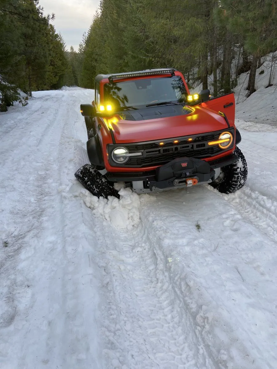

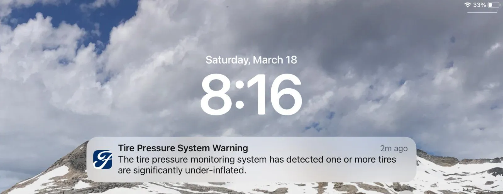

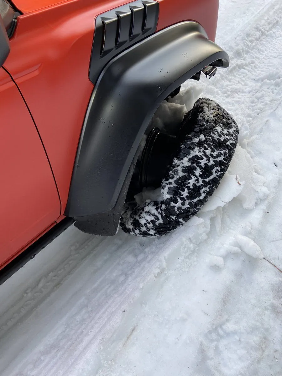

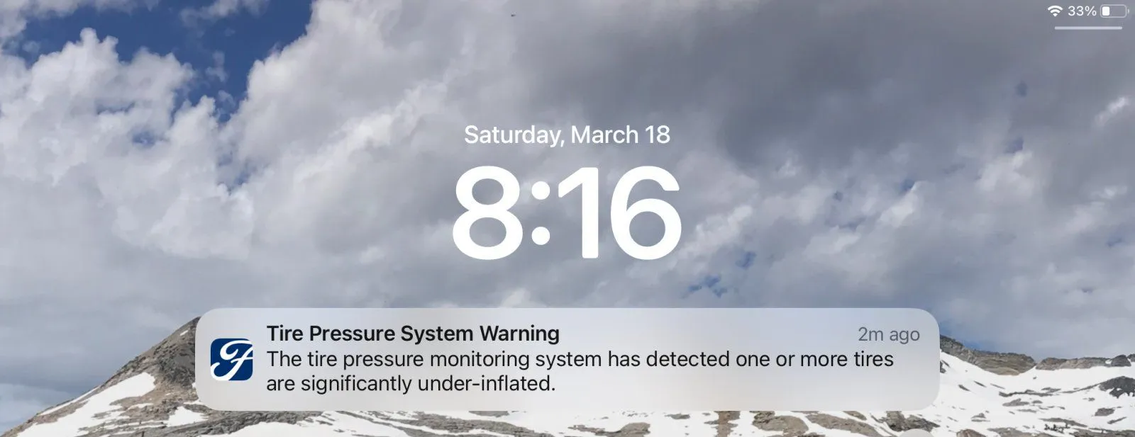

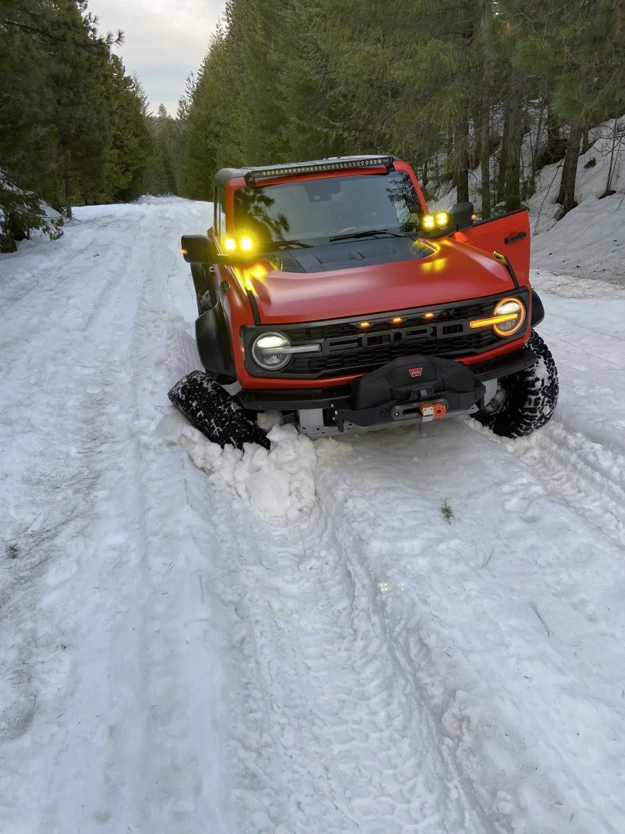

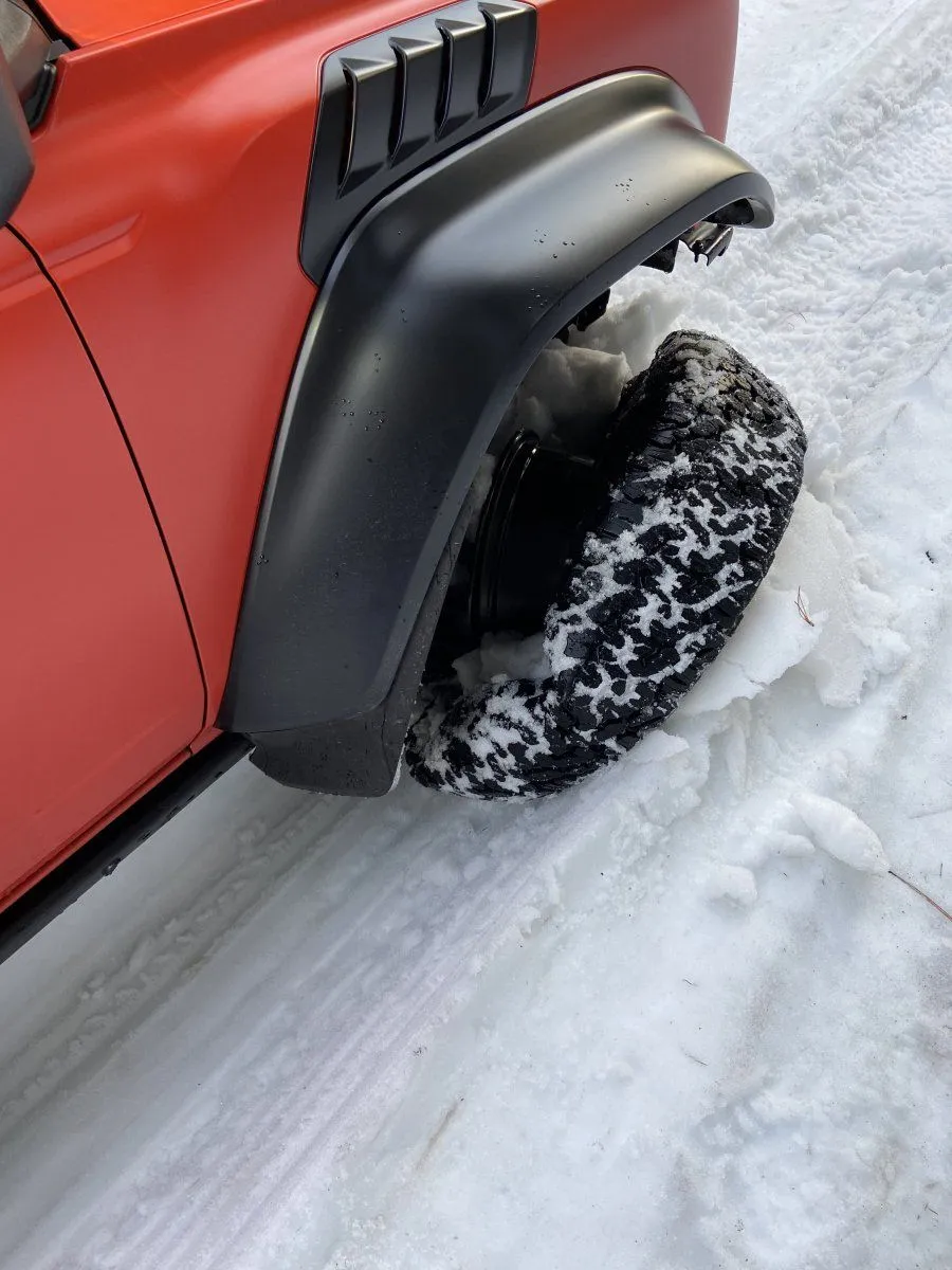

After no one showed (yet) I decided to head back out. I ran into a few of my group on the way out, then about 400 yds from pavement I lost the bead on my passenger front tire. Fortunately I had the tire pressure displayed on the instrument panel and realized what happened immediately.
A de-beaded tire with the The bottom of the truck sitting snuggly on the frozen trail presents some challenges. So I spent my alone time while waiting for the Calvary (contacted by radio) digging (chopping?, Ice Axing?) out the front end and jacking point under the frame.
fortunately, I had the presence of mind to remove side steps before leaving home. This allowed me to save a step as digging out a jacking point with those on would be impossible.
since this was front end and how the truck was sitting, the easy jacking solution was out of play (frame too high for my jack). The Calvary arrived with a high lift but the orientation of the truck didn’t allow safely lifting with it (why I don’t own one). Finally dug out enough snow to insert max tracks and used factory scissor jack after almost all digging, spare ready and lugs off the front tire.
pro tip: learn how to use your jack before you need it! It did take me a few minutes to figure out that the bolt used to hold down the jack is the same bolt you need to attach the extension to your jack. Beyond that it’s a simple scissor jack. Just something you don’t want to figure out when tired and stressed.
pro tip: I could manage the wheel/tires okay, but they are heavy and getting the spare on the front end while down in a rut is hard. Make plenty of space before lifting the truck. I thought I did, but had to do a little more. Better yet, don’t wheel alone (I didnt think I was going in) or at least bring a friend. It took to people to get the tire on. I would have got it eventually, but it would have required a LOT of time, effort and swearing.
After getting the tire, everything buttoned up nicely. Fortunately, despite not having someone immediately with me, I had everything I need and the ability to extract my self. But it would have been a much longer night without the cavalry.
and if I wasn’t able to get out, I had satellite messenger, radio, food, water, sleeping bag, mattress etc. and even a back pack stove for coffee in the morning. When you’re an idiot like me, you need to be prepared.
Root cause? I think the air pressure was too low for the conditions. In fresh snow, I’ve gone lower, but the deep, frozen, snaking ruts created more side low stresses than figured on.
View attachment 6841View attachment 6842

Would having the tires mounted on beadlock capable wheels with beadlock rings helped prevent this inside bead from breaking loose? I'm a beadlock newby so pardon if this is dumb question.
