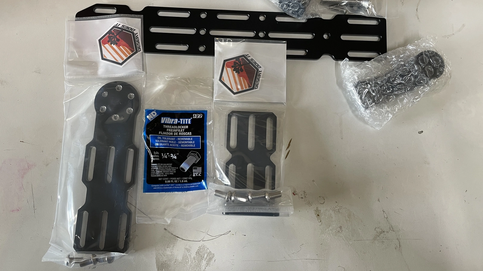

Installed the Desert Does It front under seat molle panel and adjustable angle bracket.
A little expensive for what it is but it'll serve my needs well and most importantly no new holes in interior panels.

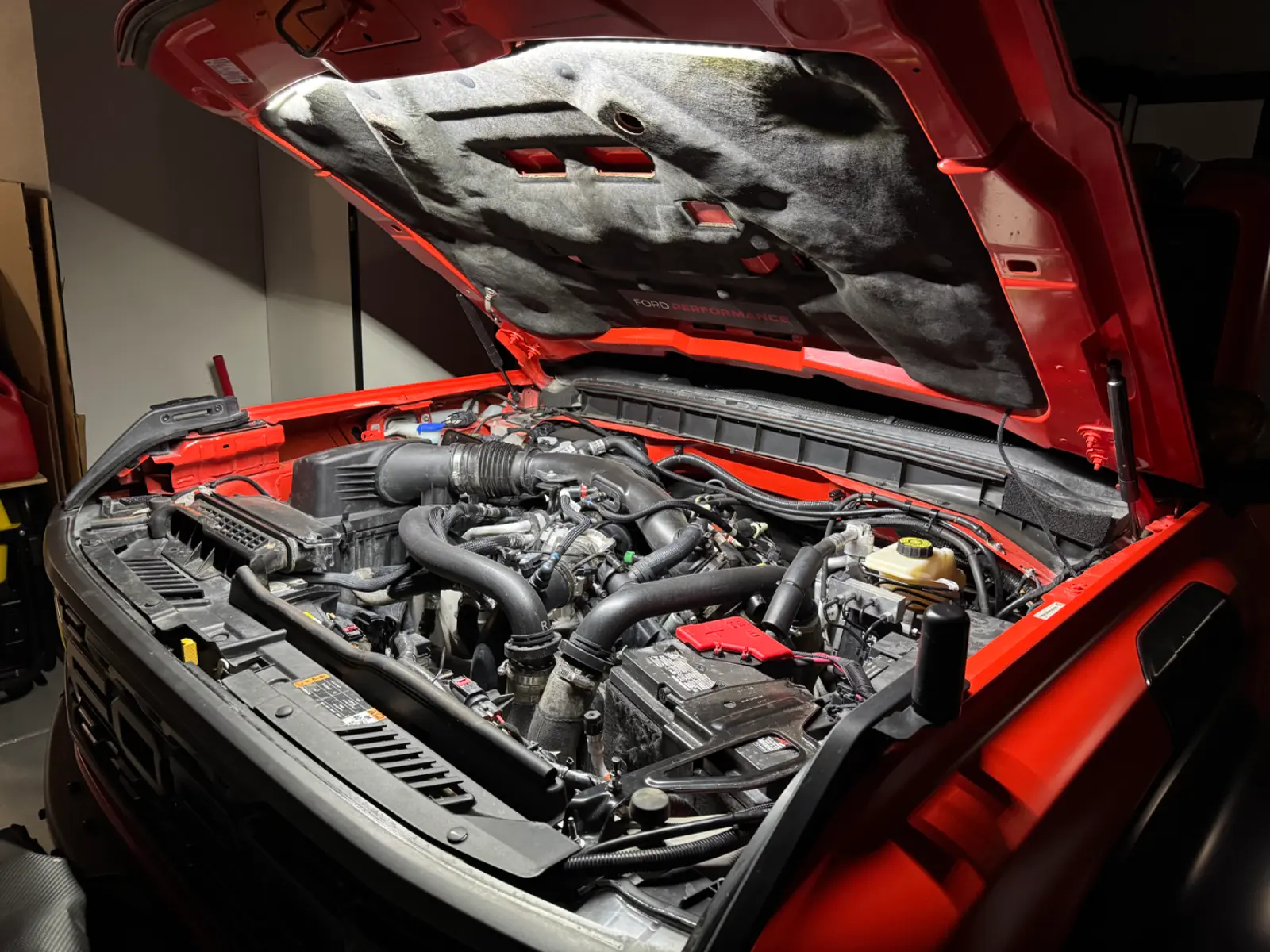

After seeing some posts on engine bay lighting I installed the TEQ Off-road under hood lighting today. I’m amazed that the “generic” version (TEQ is a Yoda shop) fits perfectly.
It’s not the cheapest option ( compared to Amazon 12” strip kits), but it’s currently $55 instead of the suggested $115 price from TEQ.
It comes with a 40” LED strip that provides plenty of light, shielded cable harness, inline fuse, a negative switched plunger and override button switch. Also includes plenty of cable management bits to tidy up the install. The finer points, the amount of light it throws and the perfect fit make it good value IMO.
I centered the strip on the hood in the only logical place it will go. It adhered nicely, but I had to leave a couple of gaps to conform to the under hood contours. I popped a two of the big plug clips using a panel tool on the insulation and routed the cable under the installation. The clips took a little coaxing to get out but went back in firmly.

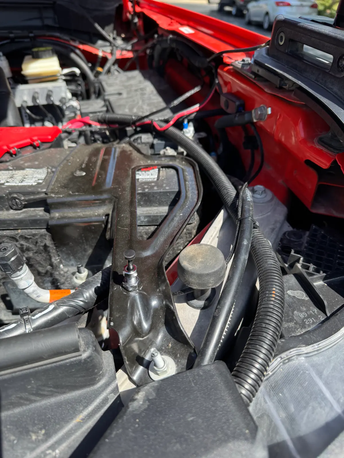

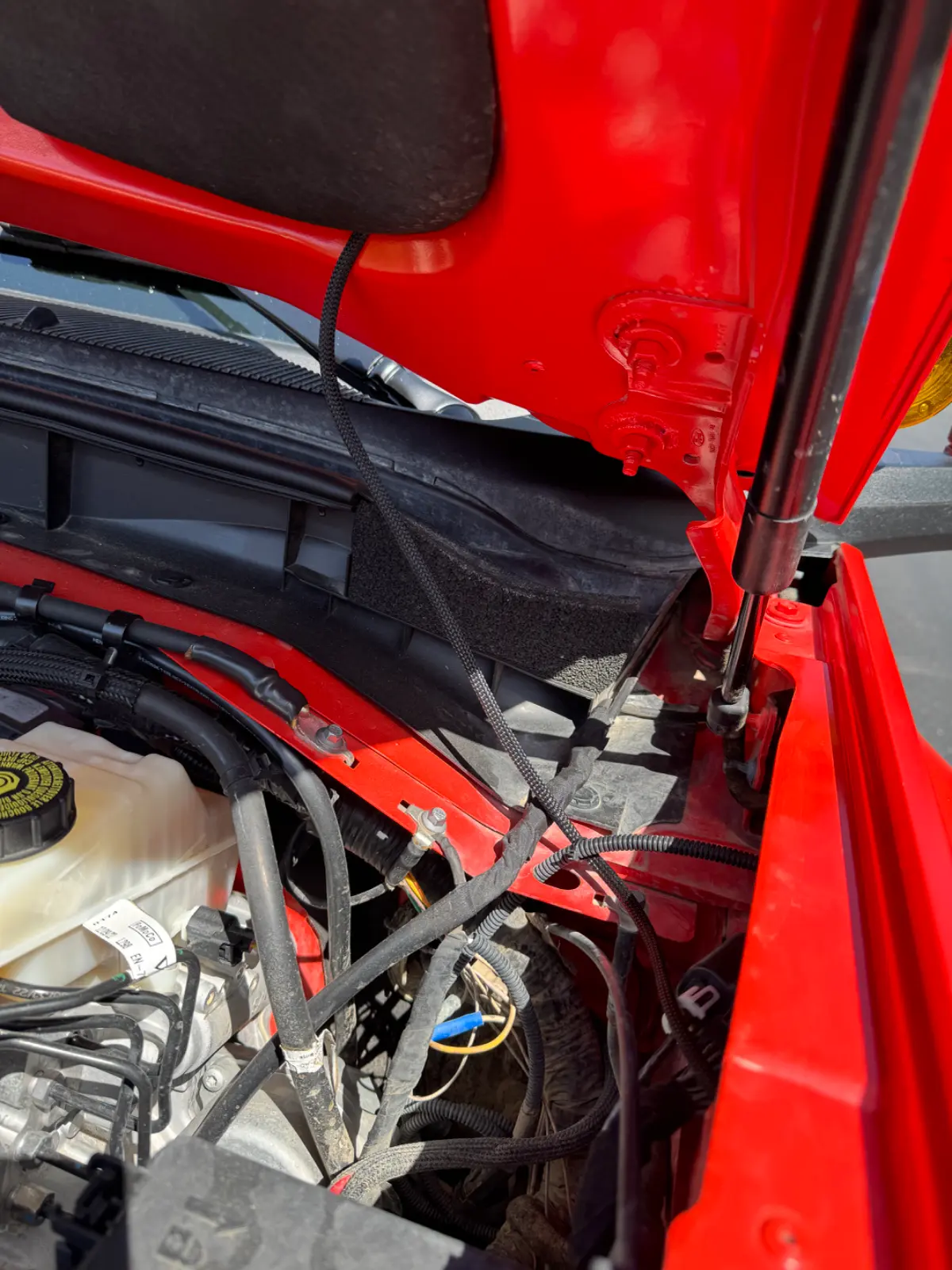

Routed the wiring “harness” along some existing cables on the drivers side. The positive connected to the battery with just the right amount of slack, nothing extra.
I chose to drill a hole in the battery hold down bracket to mount the plunger switch. And again just the right amount of cable to be able to reasonably attach the spade connection, but nothing more. I mounted the switch to the inside of the fender well using the provided doubled sided tape. Used a few of their cable ties to secure everything, but there really wasn’t any excess cable flopping around.
Took a couple tries to get the plunger set to the right height, but it was easy enough with a couple 12mm wrenches.
Overall install was about 30 minutes taking my time to make sure the harness routed nicely.
Lights up well and evenly.
You can see the override button switch on the fender behind ground and the plunger switch mount here.

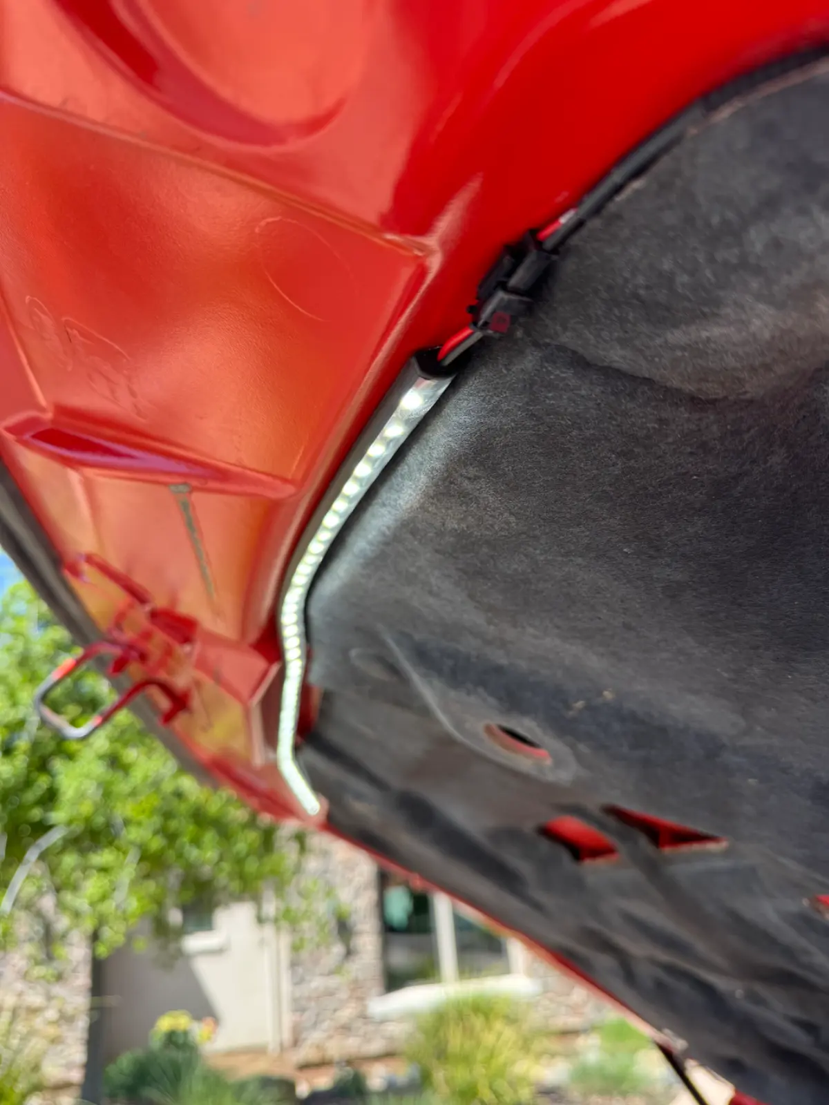

Cable exiting the hood insulation
Cable entering hood insulation and the light strip.

Seems like a reasonably priced (at $55) and well thought out kit. I'm not sure I would ever need this on the Raptor- I just don't need to go under the hood... but I may buy one for my '75 Bronco that has alot of gremlins!! Thanks for sharing!
I typically spend a lot of time under hood on all my vehicles. I'd sorta forgotten I'd installed the LED light and popped the hood last night to get battery info (will be doing an Antigravity lightweight lithium soon, should remove about 40lbs from the nose).
It was a very nice surprise when the LED's lit up the entire engine bay and made it super easy to see everything I needed, hands free. And the quality of light is also quite good.
I'd like to do the same, but use a switch mounted in the engine bay. Any suggestions on where I can find the light strip by itself?
You can do that with the Yoda kit. Just hook the negative to ground instead of to the hood switch and use the included switch to turn the light on and off.
As @Ape Factory said, it includes a manual switch. I’ll probably use the manual switch most of the time, but I decided to install the plunger switch as well to have the option.

Were you happy with mounting the 40” strip? The hood contour is kind of irregular.
There were two spots where the hood had rather abrupt contour changes and the strip wasn't flexible enough to maintain 100% contact, so it passed over the area and had an air gap about the diameter of a number 2 pencil. I filled each void with RTV so there was a continuous bond throughout the entire length of the strip. My confidence level is high that the light will remain in place for years to come.
I ended up living with the air gap as well. It’s not going anywhere. But after 400 miles off-road traversing Death Valley the plunger switch worked itself loose. I cut it off and am relying on the manual switch now. One less thing to worry about
