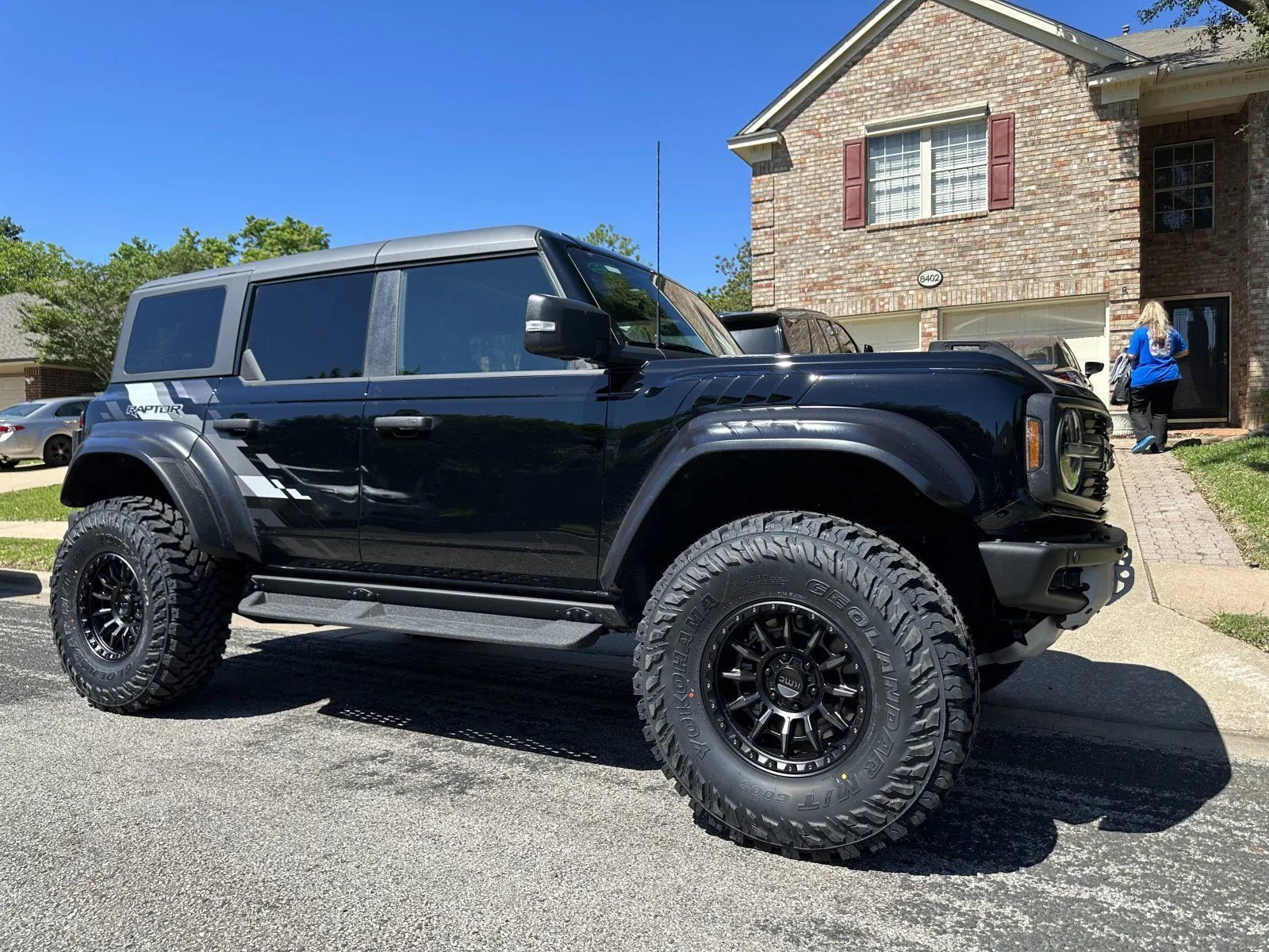

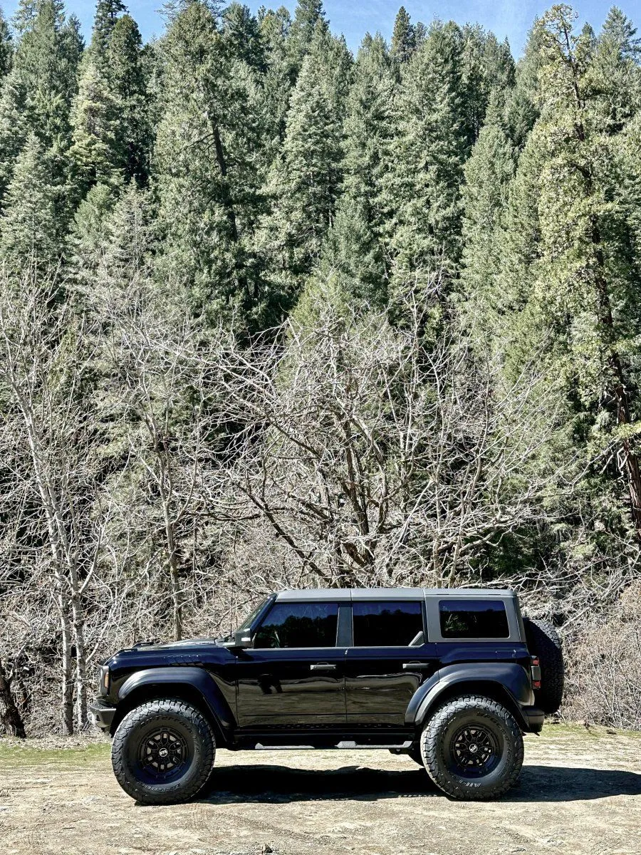

Looks Great! Our 37's are starting to look... small. I like the tire to flare stick out, looks perfect, Well Done! :cool:

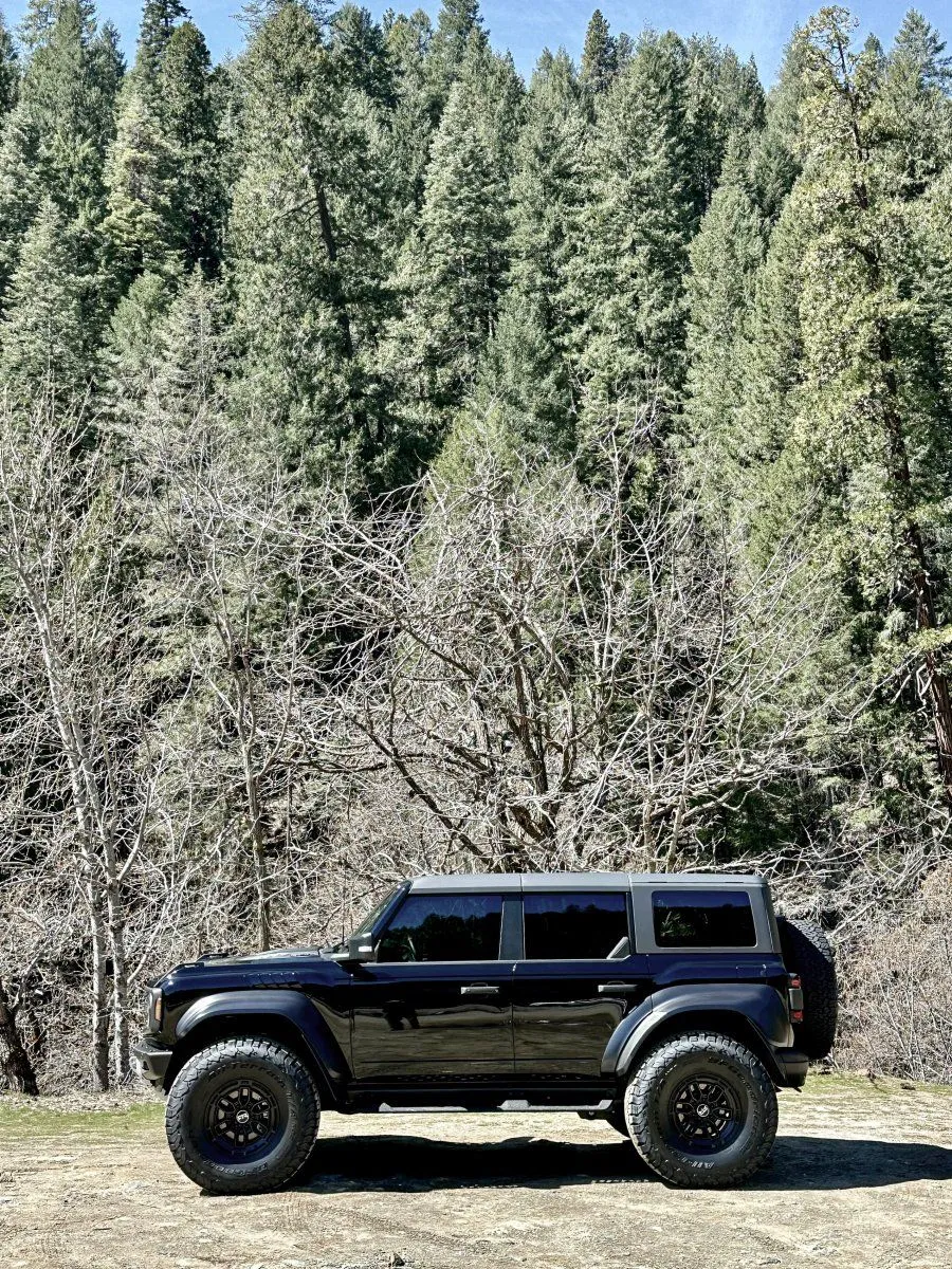

How does it drive? You noticed the -10 lbs per wheel when you went to the RTR wheels, you must notice gaining the tire weight along with the taller tire/gearing.
yes the additional weight of the 39 over 37 is noticeable, but it still drives very nice. Still handled great on a recent trip on the twisties of hwy 50 up to south lake tahoe. Weight wise its about same as forged beadlock capable + 37.
Are you guys getting the same size colars all around, or a bigger colar in front than rear, to make it level?
I want to retain the factory rake, so going 1.5 front and 2.25 rear
Did you notice any rubbing during your trip?
If you want to keep the factory rake why wouldn't you lift it the same amount front and rear? The factory rake is about 1" higher in the rear. If you raise the front 1.5" and the rear 2.25" your rake front to rear would be roughly 1.75" higher in the rear.

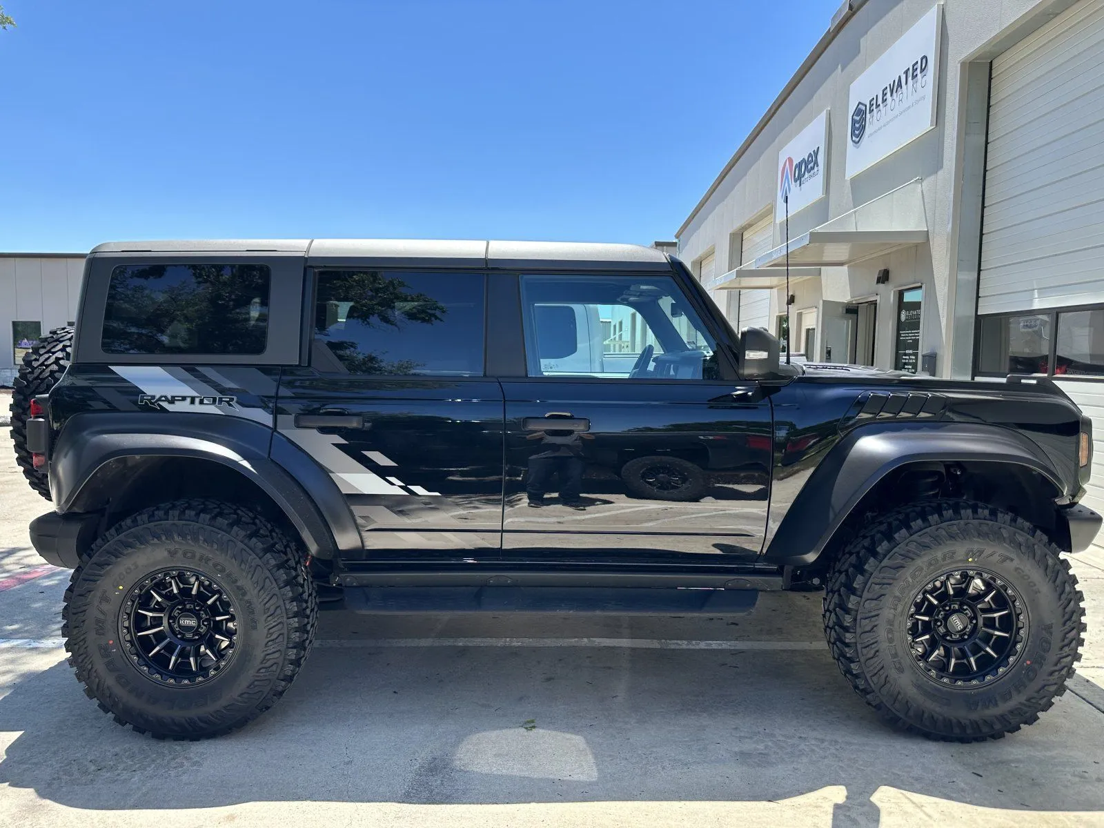

Will be another week before I get it back but it is progress.

Looking good. It appears the Foutz 2" front and 1" rear has the vehicle sitting level? Is that correct?
It should be I have not really seen it in person and just got these pictures today. Still have LP4's going on so that should look good.

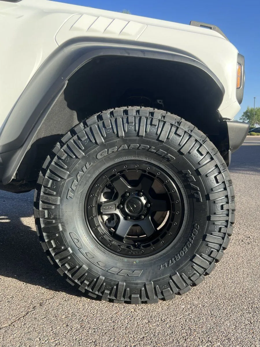

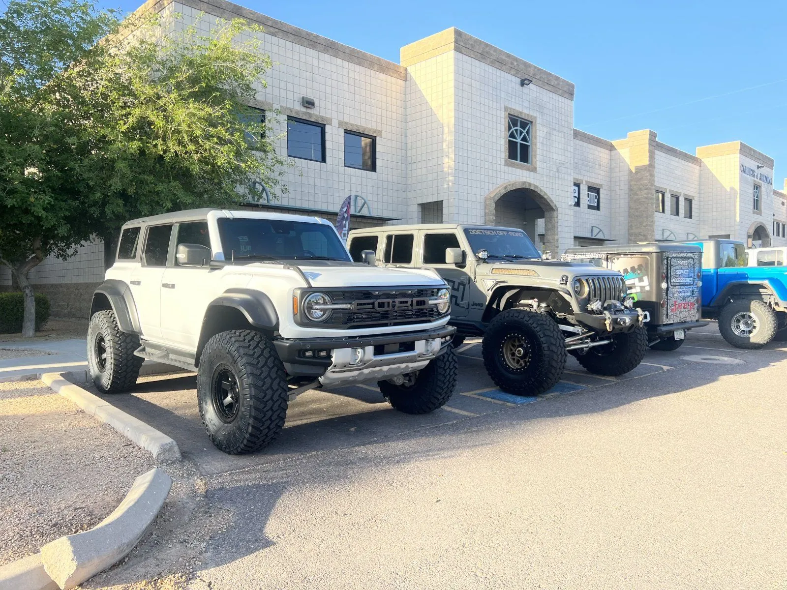

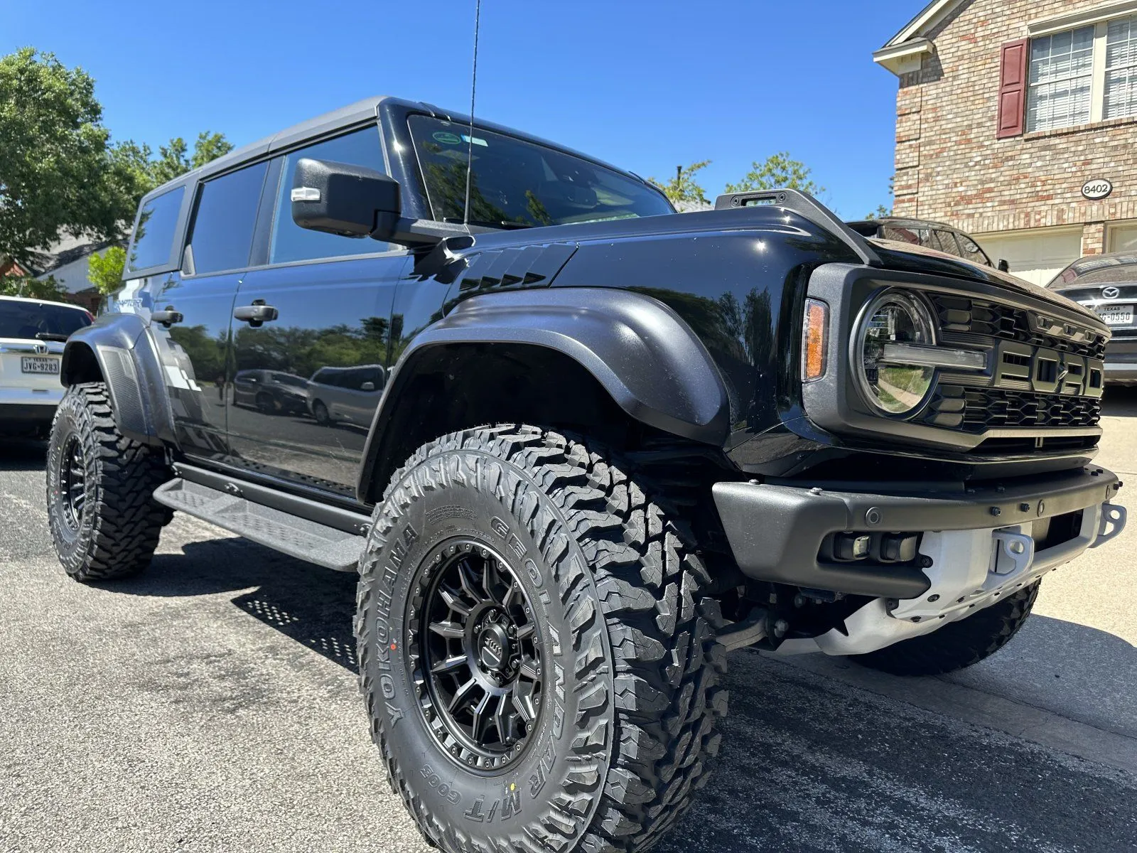

Just finished one up with RPG 3/2.25 and Nitto trail grapplers in a 38.
Sitting next to a 3.5” lifted Jeep on 40”
Welcome to the forum! 🍻 Thank you for posting the comparison photo. Appears the Jeep has a considerable amount of suspension modification to achieve a similiar height to the Bronco Raptor that's just on lift collors.

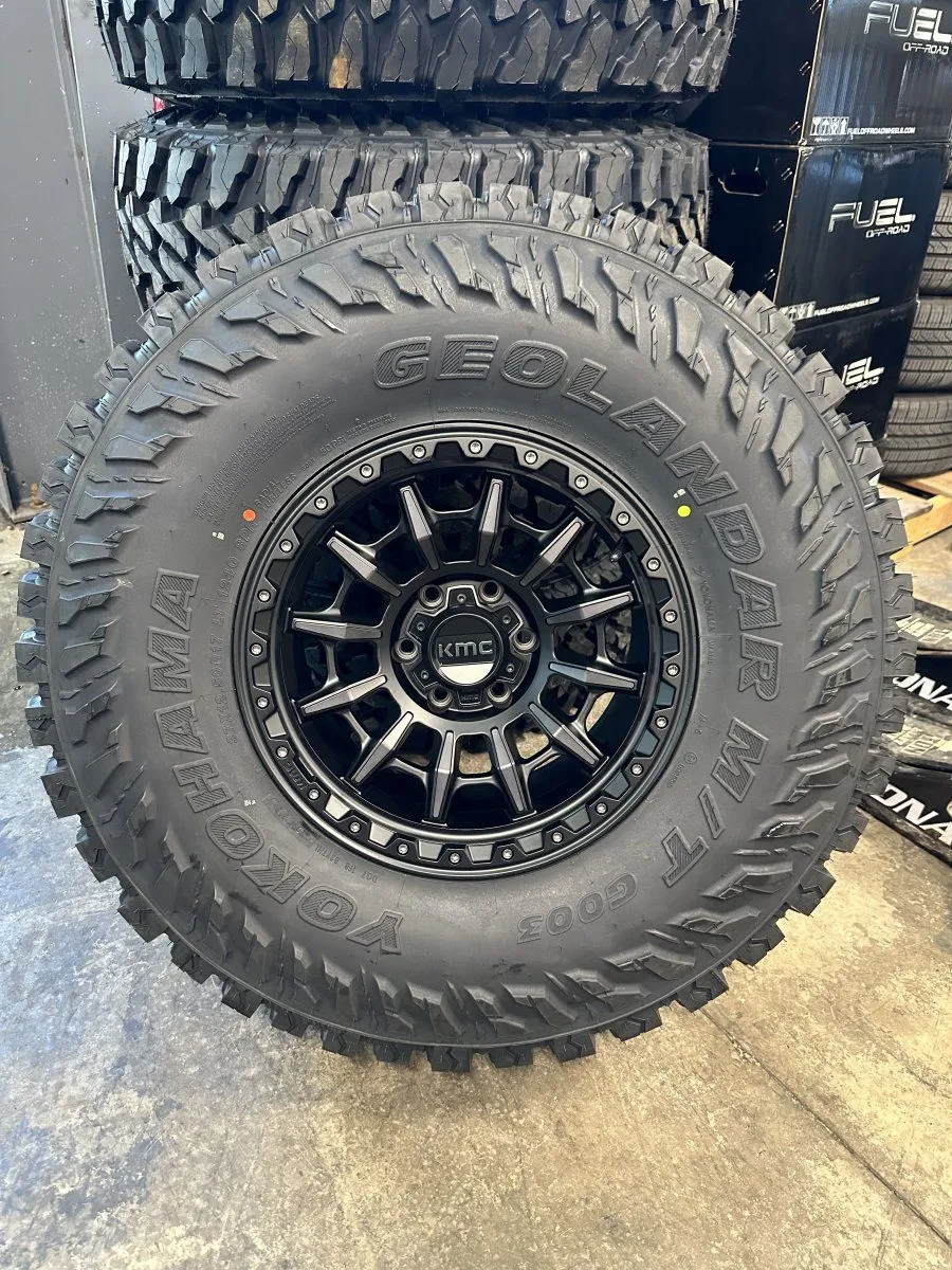

Was about to pull the trigger on some 38x13.50 but decided to stay stock suspension and do a more aggressive 37 and 00 offset wheel.
Went with Yoko G003 MT in 37x12.50 = 76 lbs
KMC Carnage 17x9 0 offset - 27 lbs
Total = 103 lbs
The factory specs (to my knowledge) are
BFG KO 37x12.50 = 65 lbs
Ford Forged, Beadlock Option 17x8.5 = 36 lbs
Total = 101 lbs
Def like the new stance and look while only adding a couple lbs to each corner. Rides and looks great!
But….def jealous of them 38-40’s!! 😁
