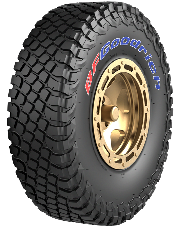

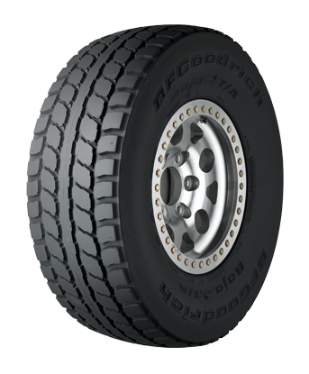

Would any of the BFG Baja off-road racing tires hold up for street use?
Lots of people have run them on the street but they are technically not DOT rated. Plus, they aren’t good in cold temps. Can’t recall the exact temp but they say do not drive on below X temp. I think below freezing but can’t remember.

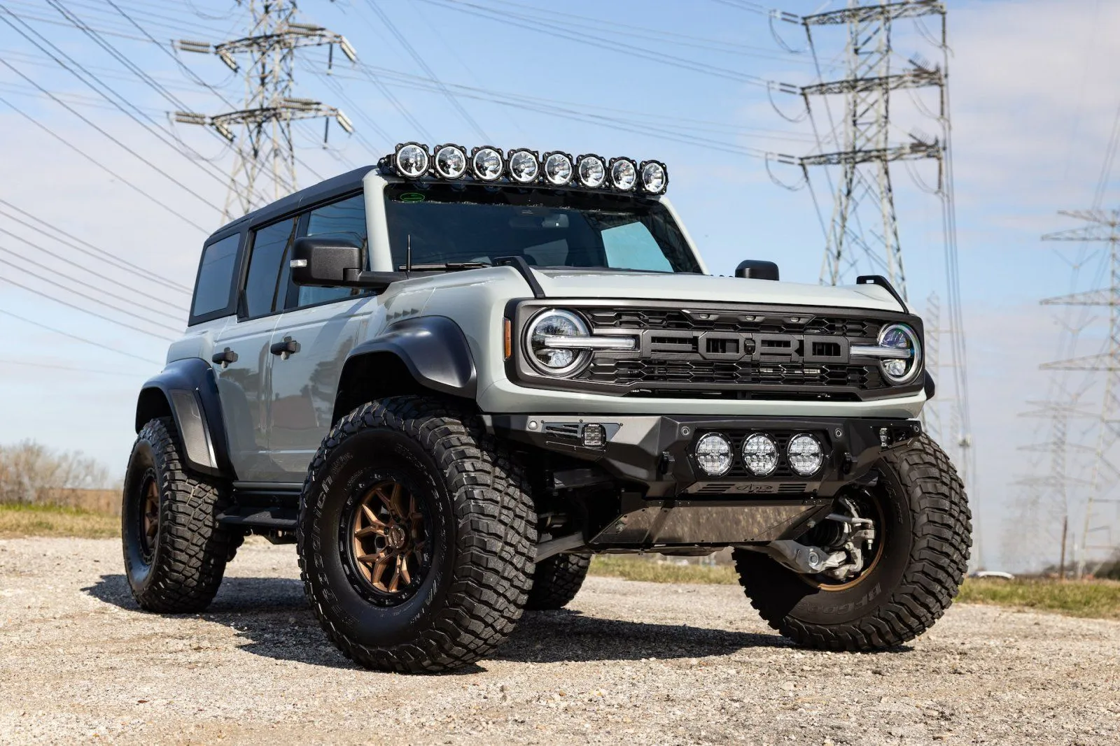

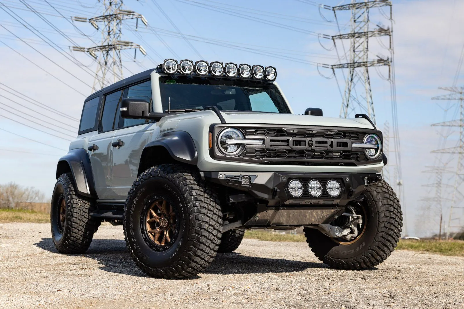

I need to know more about these tires because this setup looks awesome!
Agreed, I added the Maxxis spec chart to the end of the post. 91.5 lbs, but all that rubber is what makes them look awesome!
A 3" collar begs the question does this put the shock out of its working range. Also, can the bronco raptor axles handle 40s?
Forget the tires, that Starwood Signature Finish is awesome! :love: ROSSO CORSA RED
Although, I would hate to coverup my HPR.
Foutz was saying that 3'-inches is the max range for the collars before the spring starts to bind. A heavy-duty 37-inch tire is only about 10 lbs less per tire than these 40s but only time will tell.
