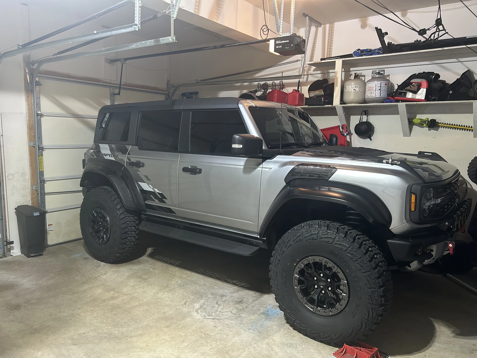

I wrestled with what size lift and tire. Decided 40s were just too much and went 38x13.5.
Glad I did. Still have power- stopping and going and they don’t look too big to be useful. I bet the Nittos are very close in size to the BFG 39
2.5/2 FMI perch collars

@Birdman37 is running OEM stock Bronco Raptor wheels, note that the tires are the same 12.50 section width as our OEM tires. With the BFG 39x13.5-17 you should be fine with the OEM wheels, if there is a slight touch at full turn then add 3/8" or 3/4" Bora wheel spacers.
Aftermarket wheels do not need to be 0 offset, I would recommend a +25mm to +6 mm positive offset in a 17x9 or 17x8.5 wheel.
