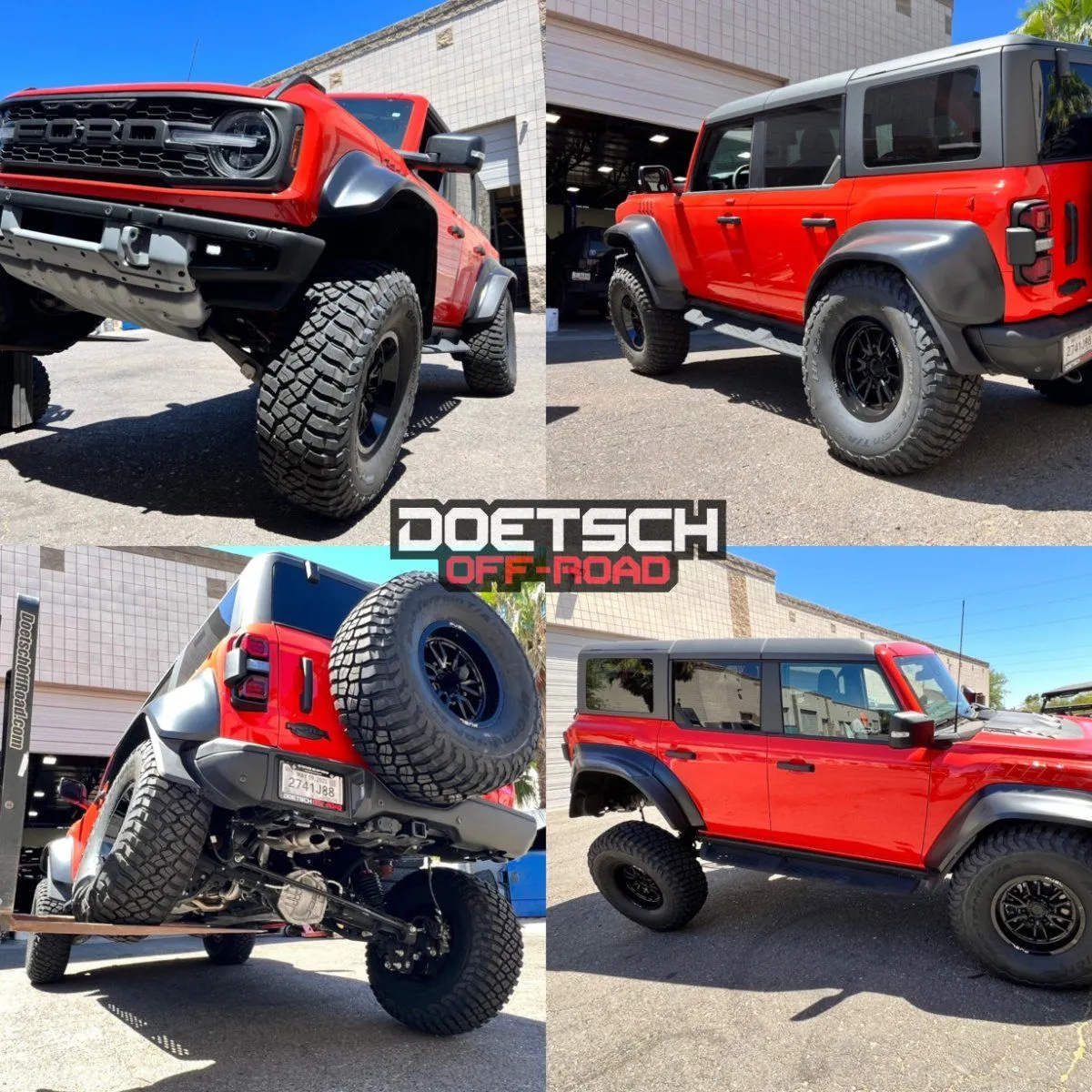

Nice work everyone. I just picked up my Braptor yesterday and had a nice drive back to San Diego from Vegas where the Ford dealer had a big selection of Braptors to choose from.
No the fun begins with the mods. I’m wanting to put 38 x 13.5 x 17 tires on along with some Raceline Beadlock wheels.
I’m trying to figure out what would be the best lift. How much to lift, and what to do about adjusting the speedo for tire size.
With not many options for lift kits I’m just waiting to see what is being used and if the feedback is good or bad.
A lot of guys running 38-39” on factory suspension, but a 1-2” collar lift from Foutz or RPG is the most popular so far. I’m having my 1” front installed this weekend, but I stayed with a more aggressive 37” tire
Let me know what you think about the 1” front collars. I’m thinking about the RPG kit since it seems like they have the most aftermarket suspension items available.

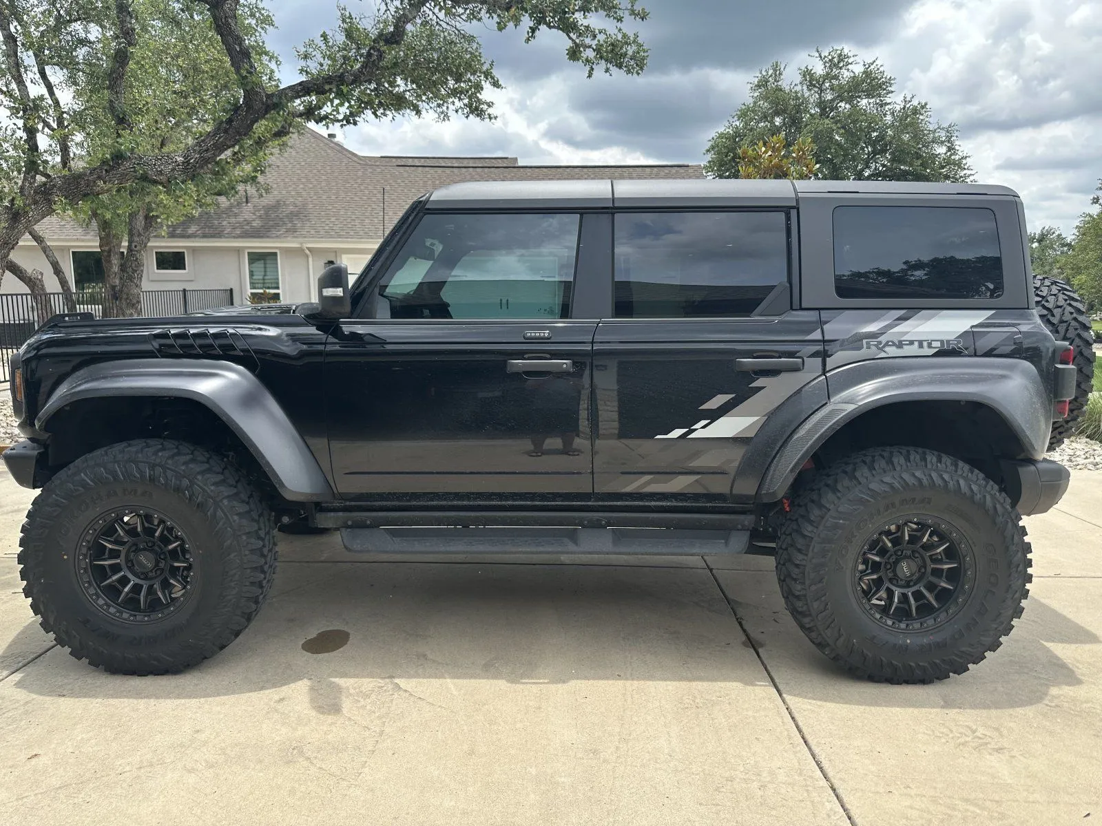

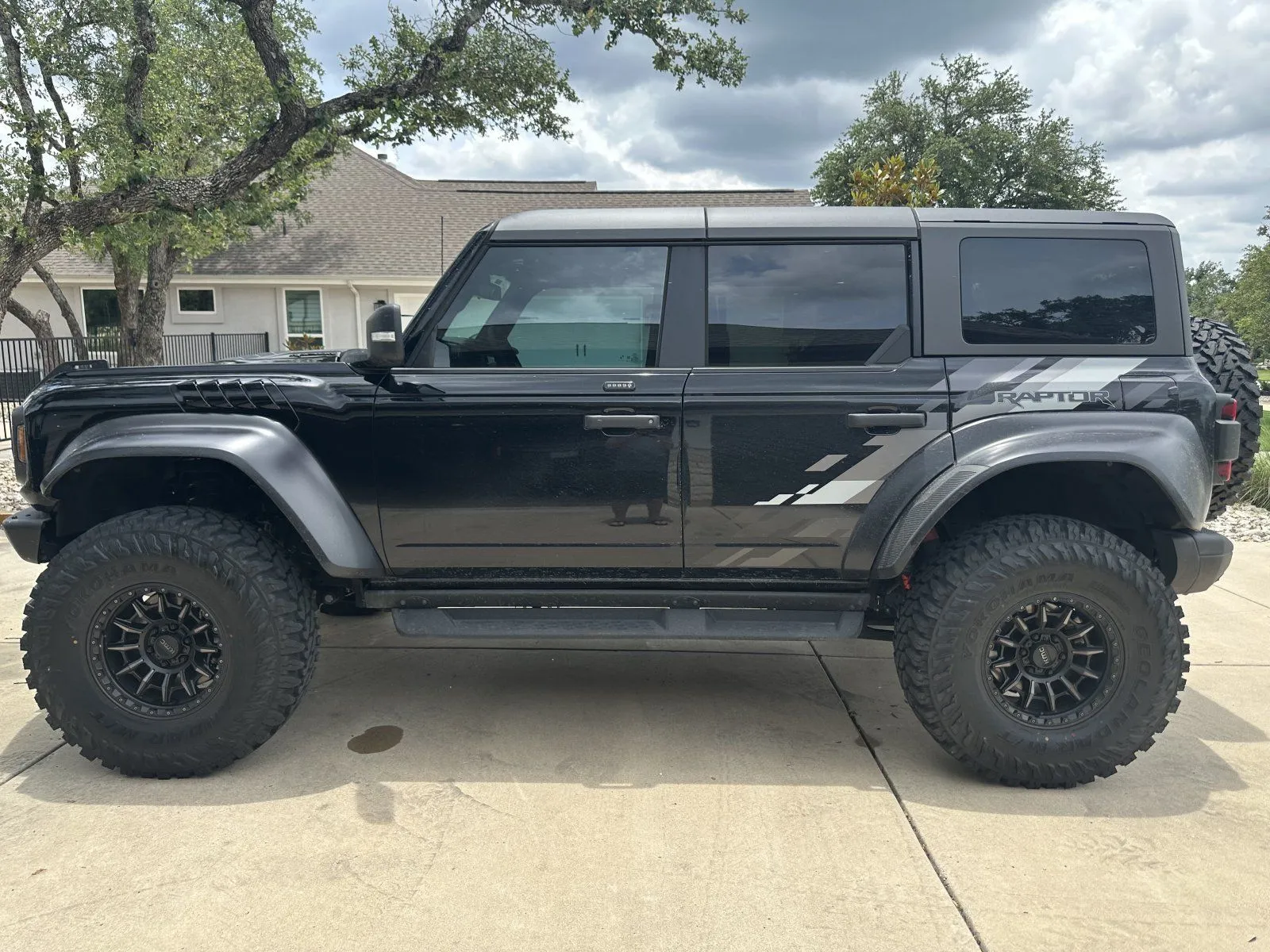

1” Foutz front only collars installed and picked up today
Braptor measurements JFYI:
Before - Front 42 1/4" Rear 43 1/2"
After - Front 43 1/4" Rear 43 3/4"
So achieved exactly a 1" front lift and now offers only a 1/2" rake (perfect IMO) vs stock was a full 1 1/4" rake
Drove it about 20 miles and honestly feels almost the same as stock. Not enough noticeable difference to not install if you are concerned about comfort, etc…

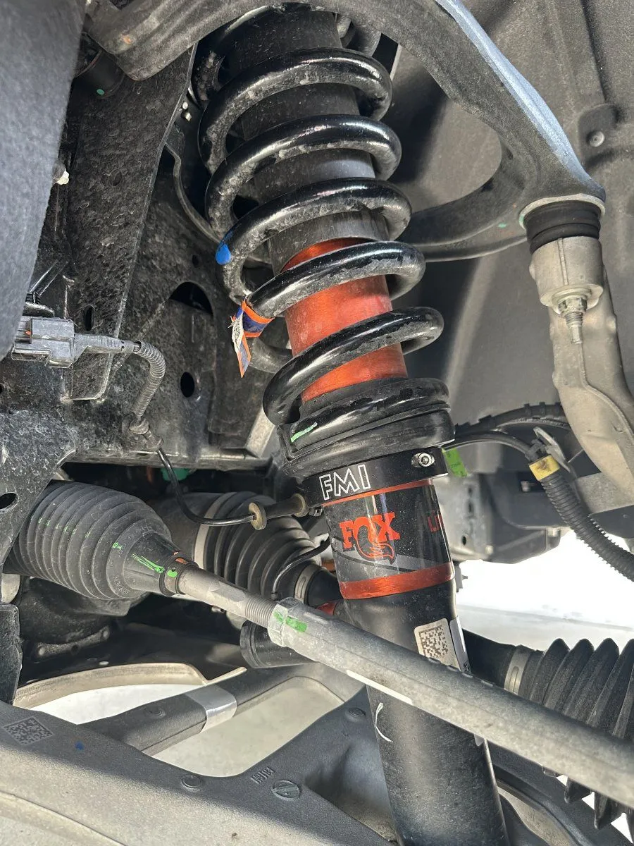

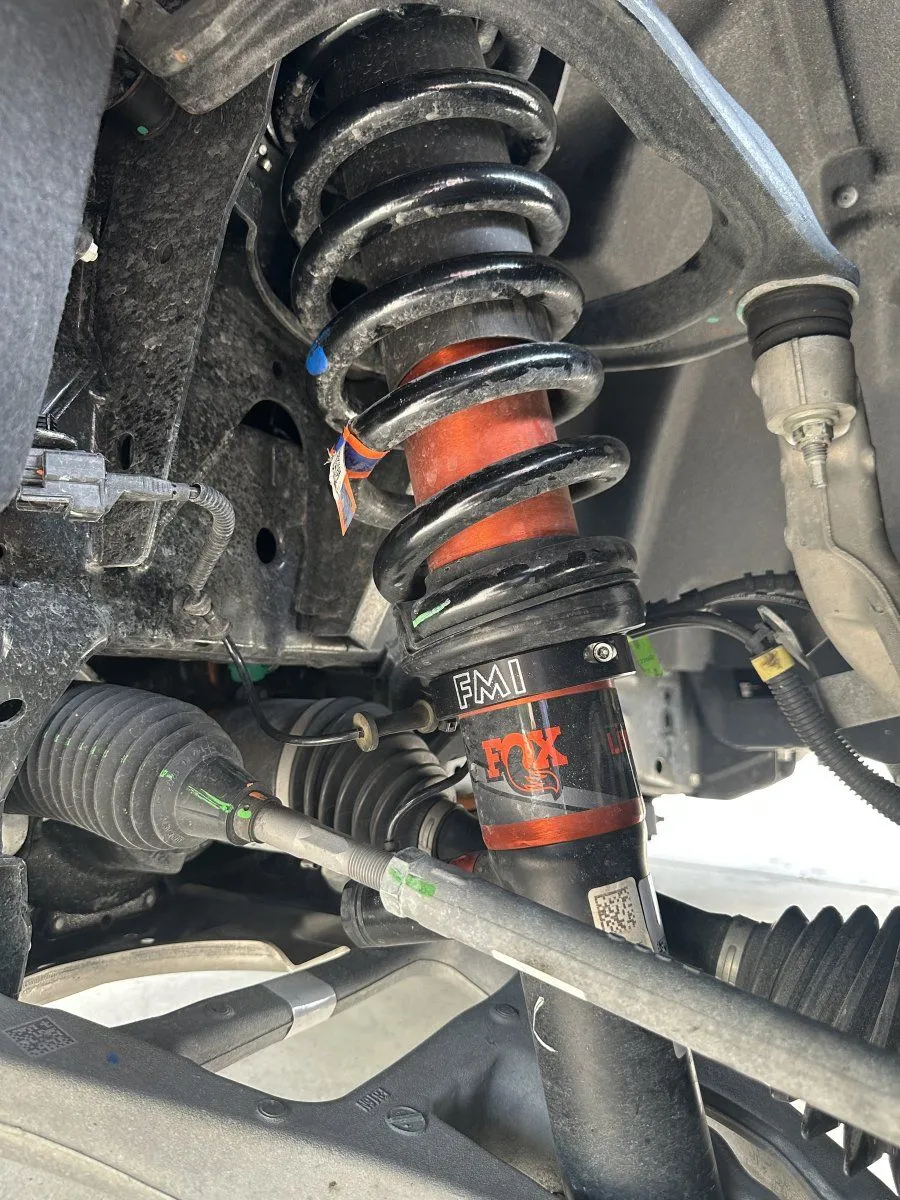

I had the 1.5" FMI Collars installed on the front a few weeks ago and now have a 1/2" rake from Front->Back. Having 1" Collars being installed on rears this Wednesday so should get it back to level if not a little Rear->Front rake. But the rear springs are pretty soft so a chance I won't see a full inch of lift on the rear. But now have an option for 38s in the future if wanted.

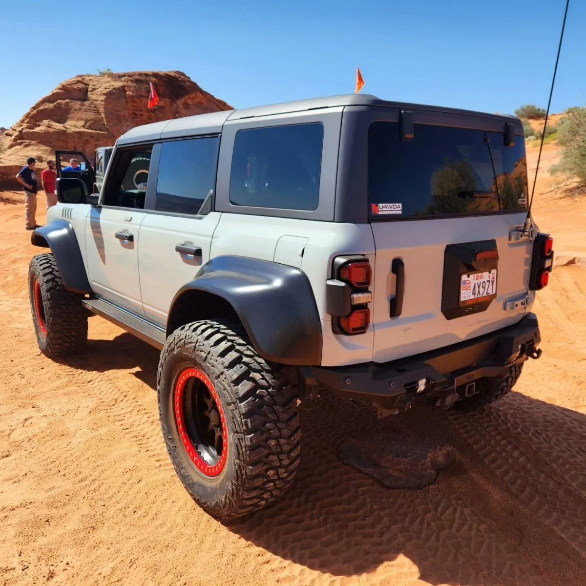

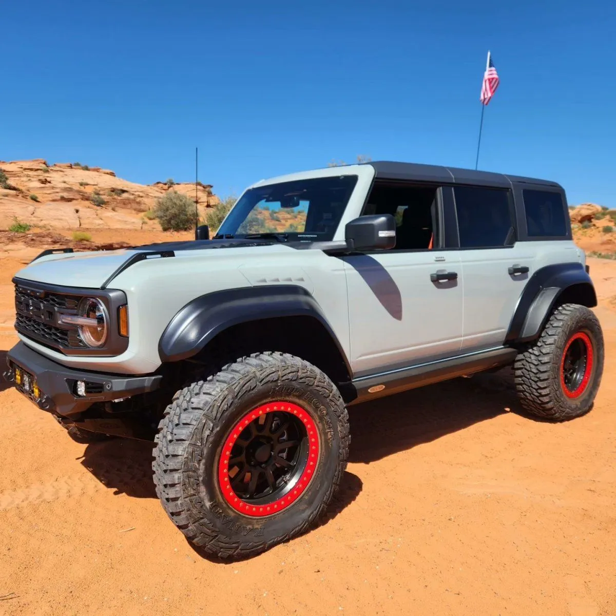

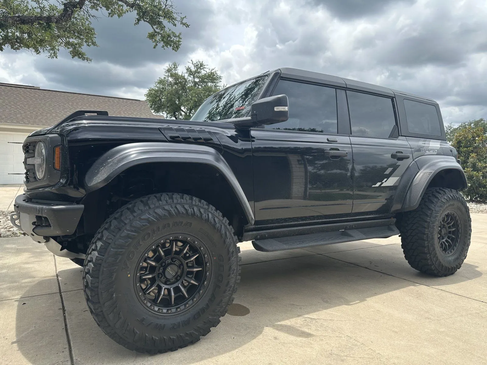

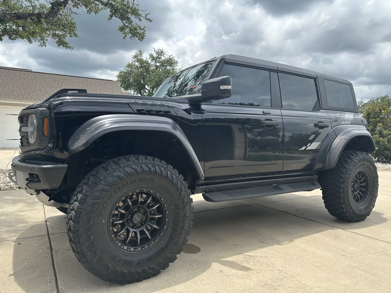

I’m running 39” Kanati Mud Hogs with a 1.5“ RPG spacer. Rides perfect and the Kanati tires are the quietest smoothest mud terrain tires I’ve ever owned. Slight rub on the plastic inner fender at full lock. Nothing a little trimming wouldn’t fix.
I’m running 39” Kanati Mud Hogs with a 1.5“ RPG spacer. Rides perfect and the Kanati tires are the quietest smoothest mud terrain tires I’ve ever owned. Slight rub on the plastic inner fender at full lock. Nothing a little trimming wouldn’t fix.View attachment 9690View attachment 9691
What size wheels? 20's? I like the look
Is that 1.5" up front only or all around?

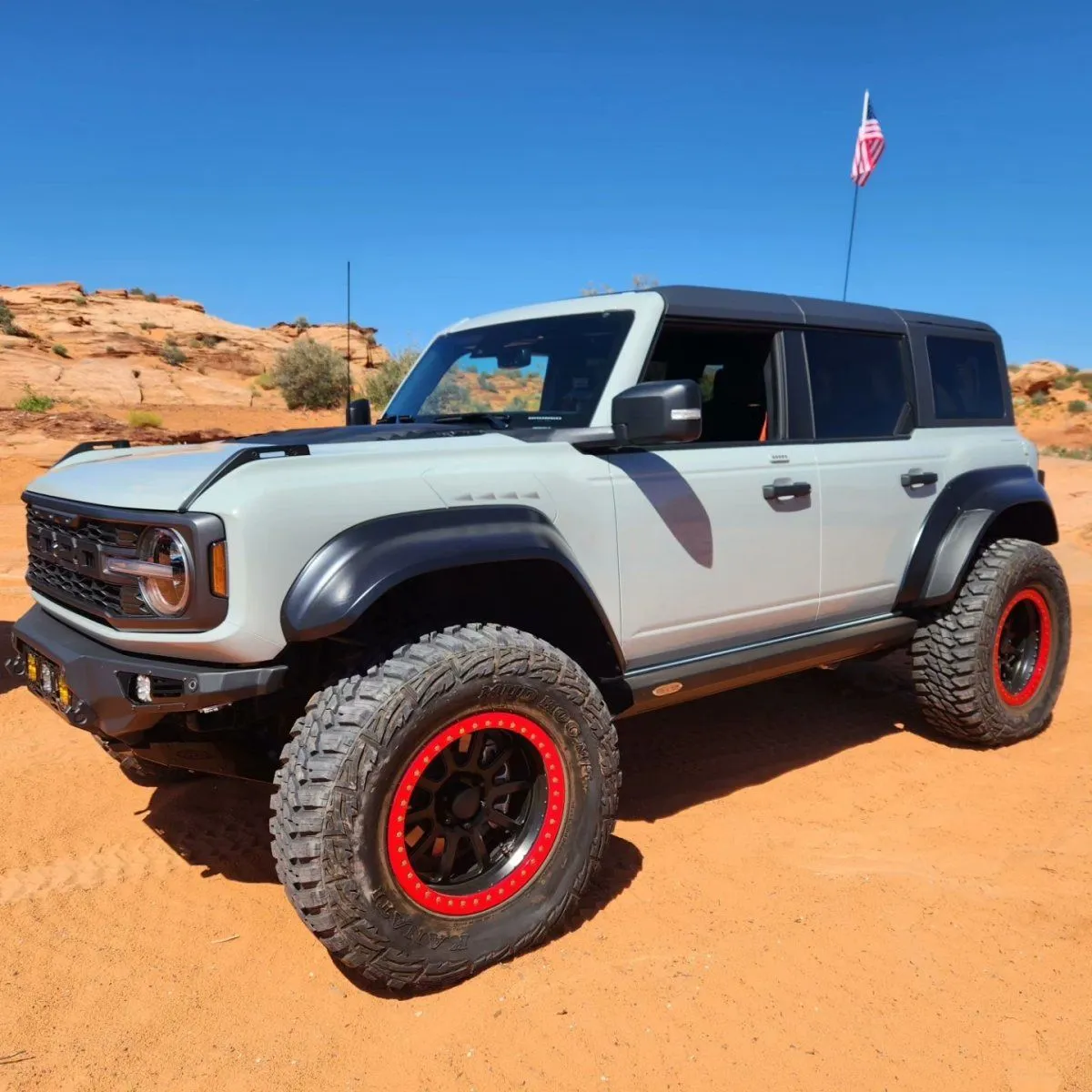

Anyone using wheel spacers to get the better offset without new wheels ?
About 35mm
Something like this ?
About 35mm
Which wheels are those, and any rub when turning with that articulation?

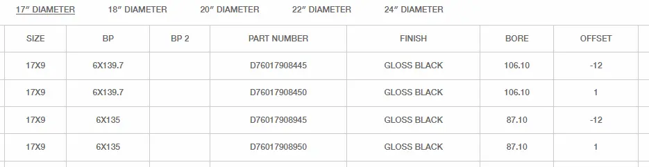

Welcome to BroncoRaptor.com! I'm not sure what offset @Alludc has on his Bronco Raptor above, but they appear to be the 17x9 Fuel one piece wheels.
Guessing the +1 offset (last row below)
This is the perfect combo for me. Can you tell me the offset and specs please? I want bead locks on 20" wheels and want to keep the lift to a minimum. I play with rocks often so I will get full articulation. I hope rubbing is not part of the combo (other than the inner fender).
