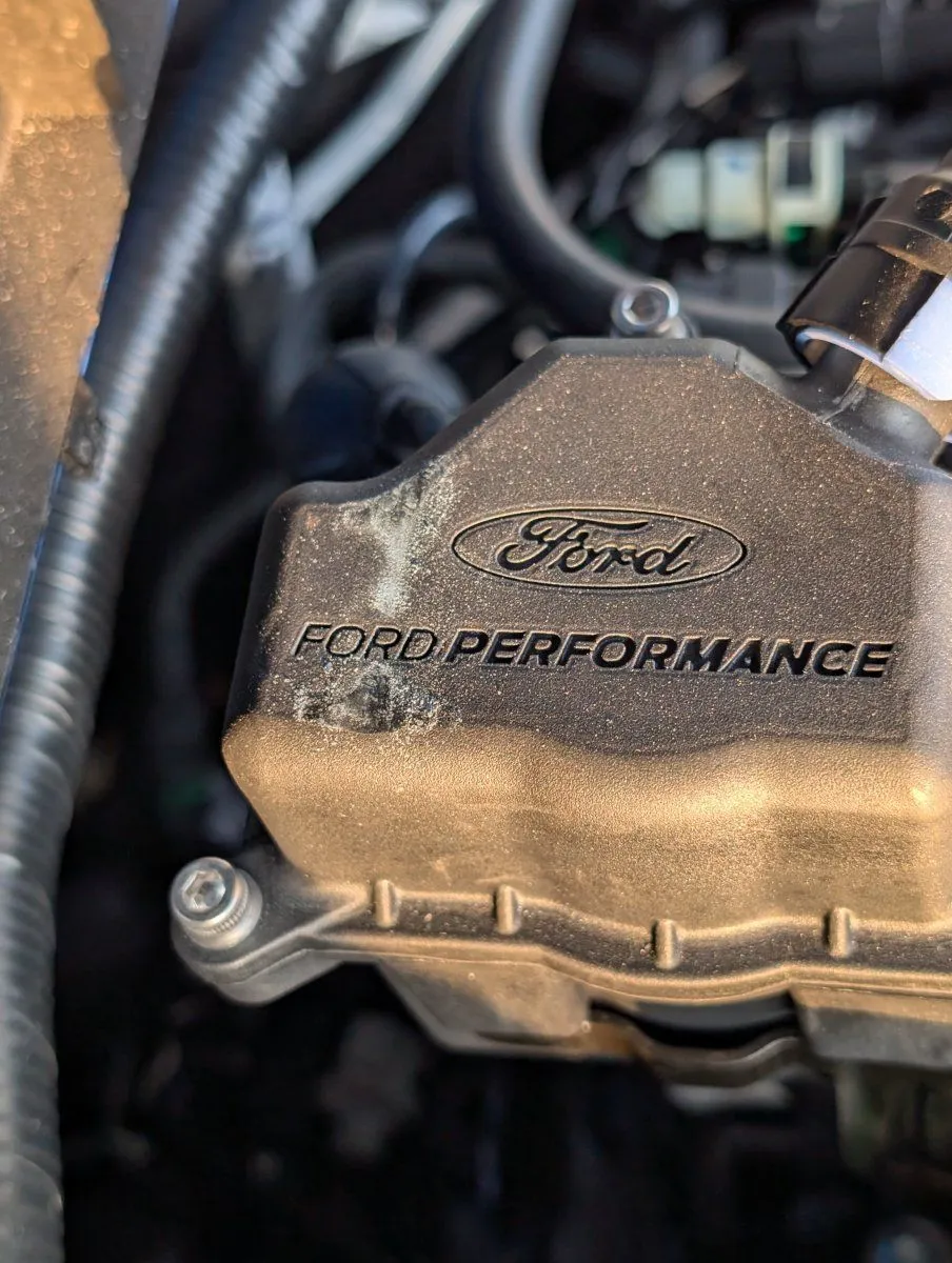

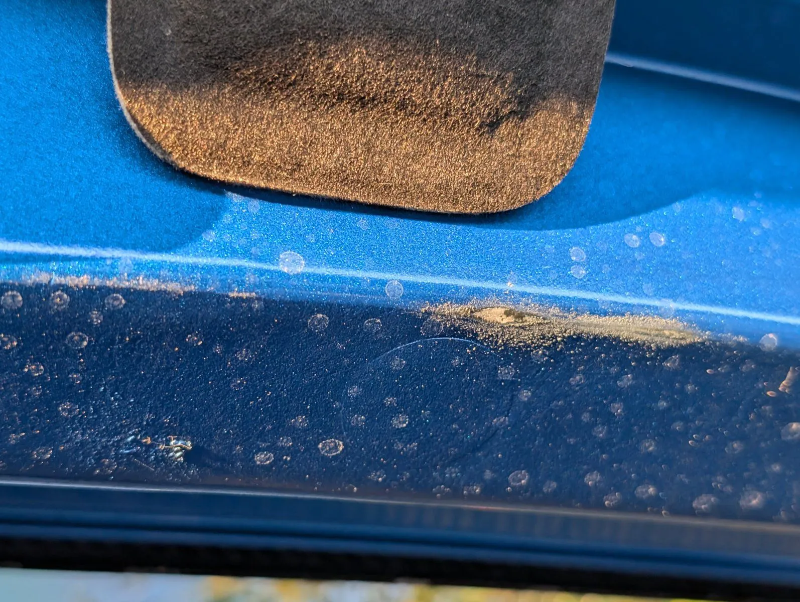

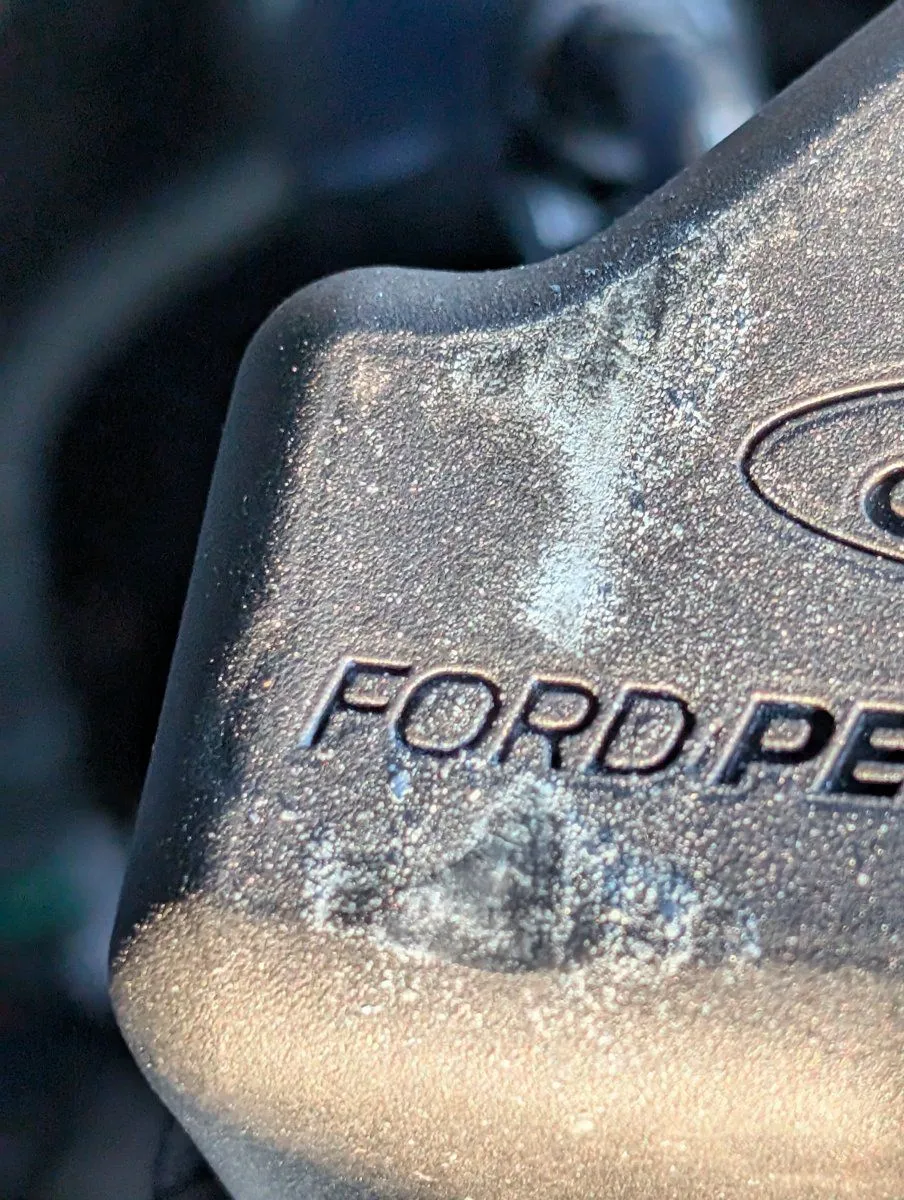

Hood paint splitting, cracking, and peeling off due to FP catch can.

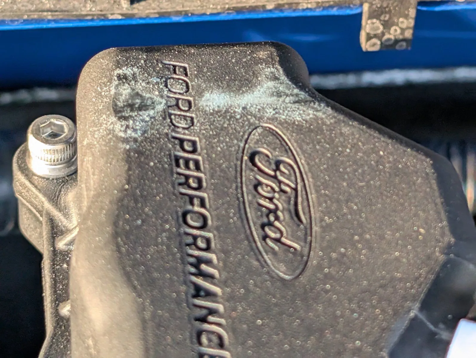

Center FP Catch Can:
I only have 1,400 miles on the vehicle and have not yet taken it for any off-roading (just some very short dirt roads). I have not yet made my dealer aware of this, as I only found this 30 minutes ago.

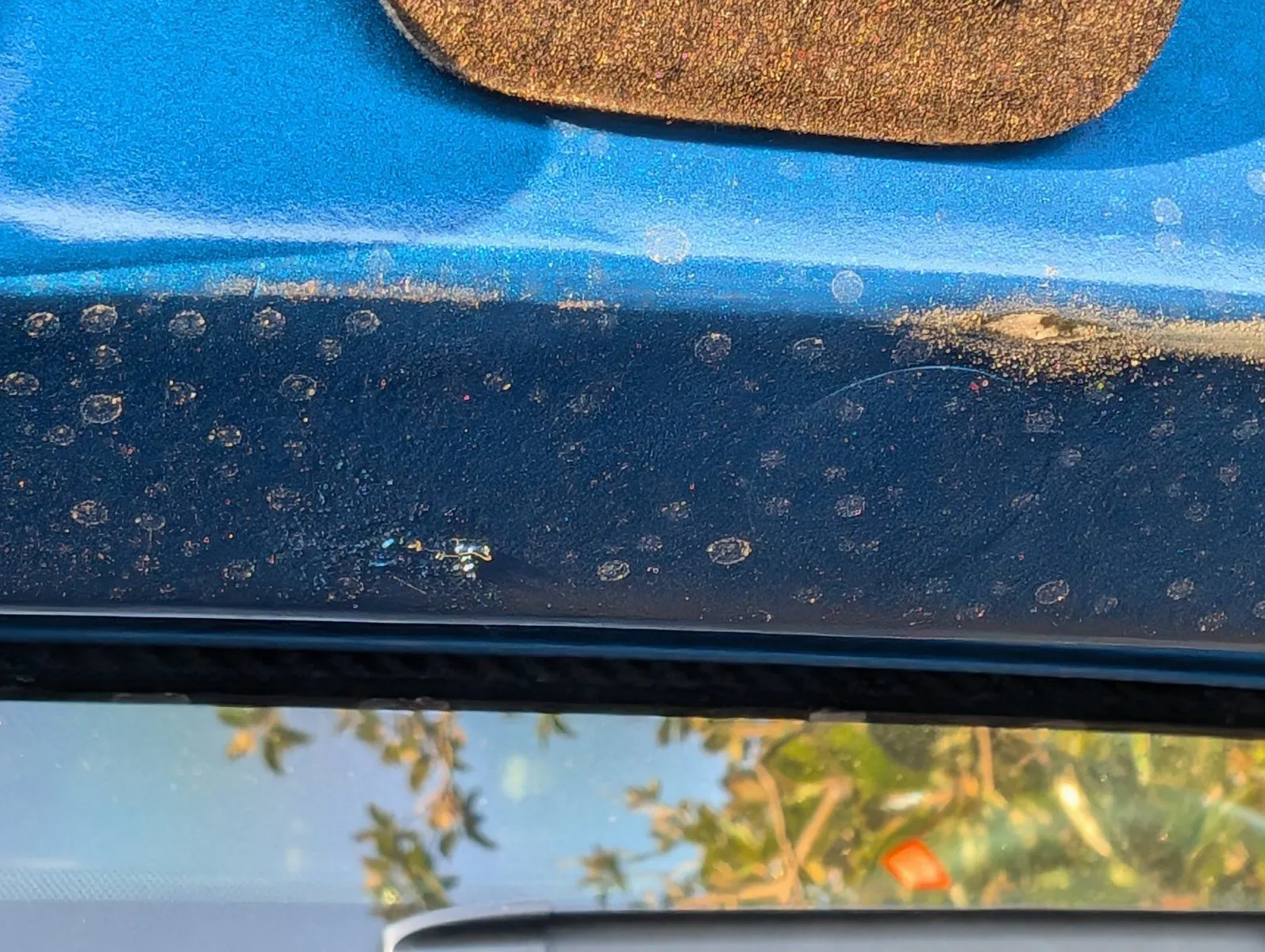

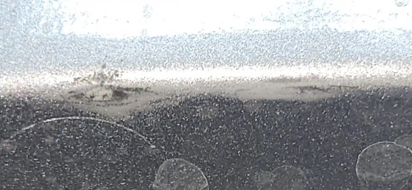

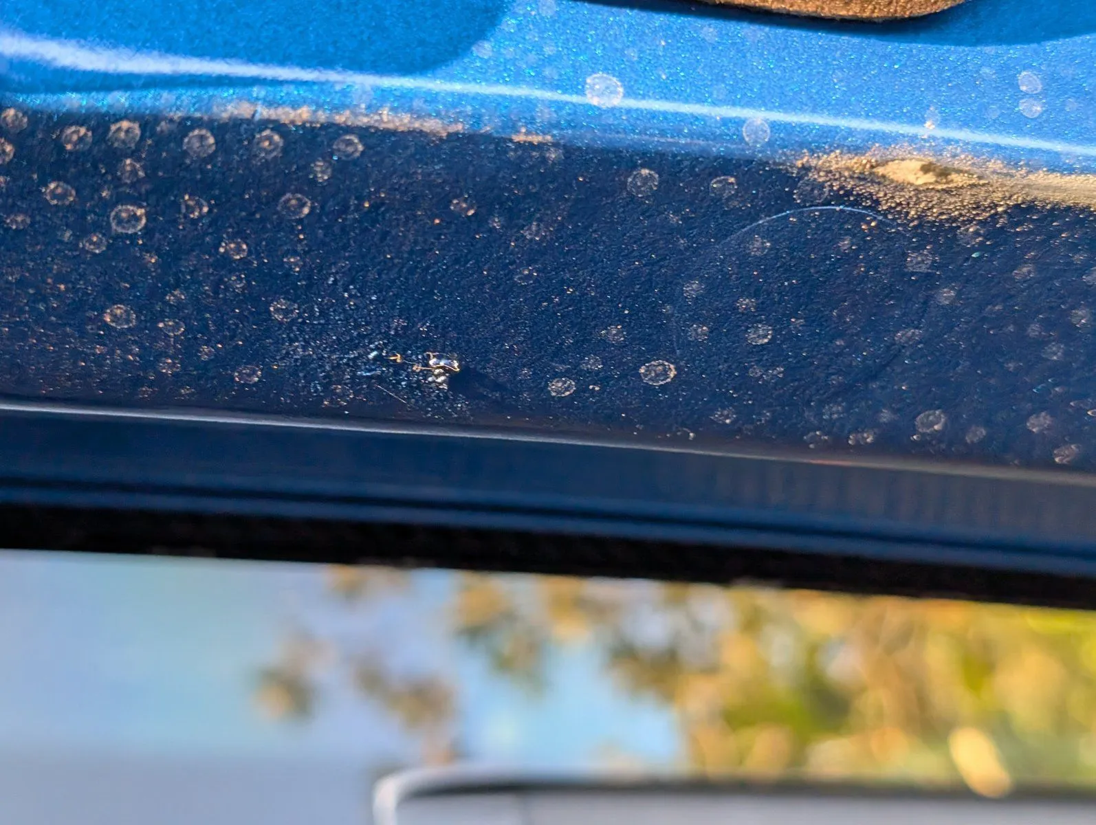

Unfortunate, I'm sure you'll be notifying your installing dealer. I advise removing this canister with the connecting air tubes and reinstalling the OEM air tube until Ford Performance has a solution for us. Hopefully your dealer will get some sort of positive feedback from their dealership F.P. support line. From the front it would be easy to miss this issue if not looking for it.

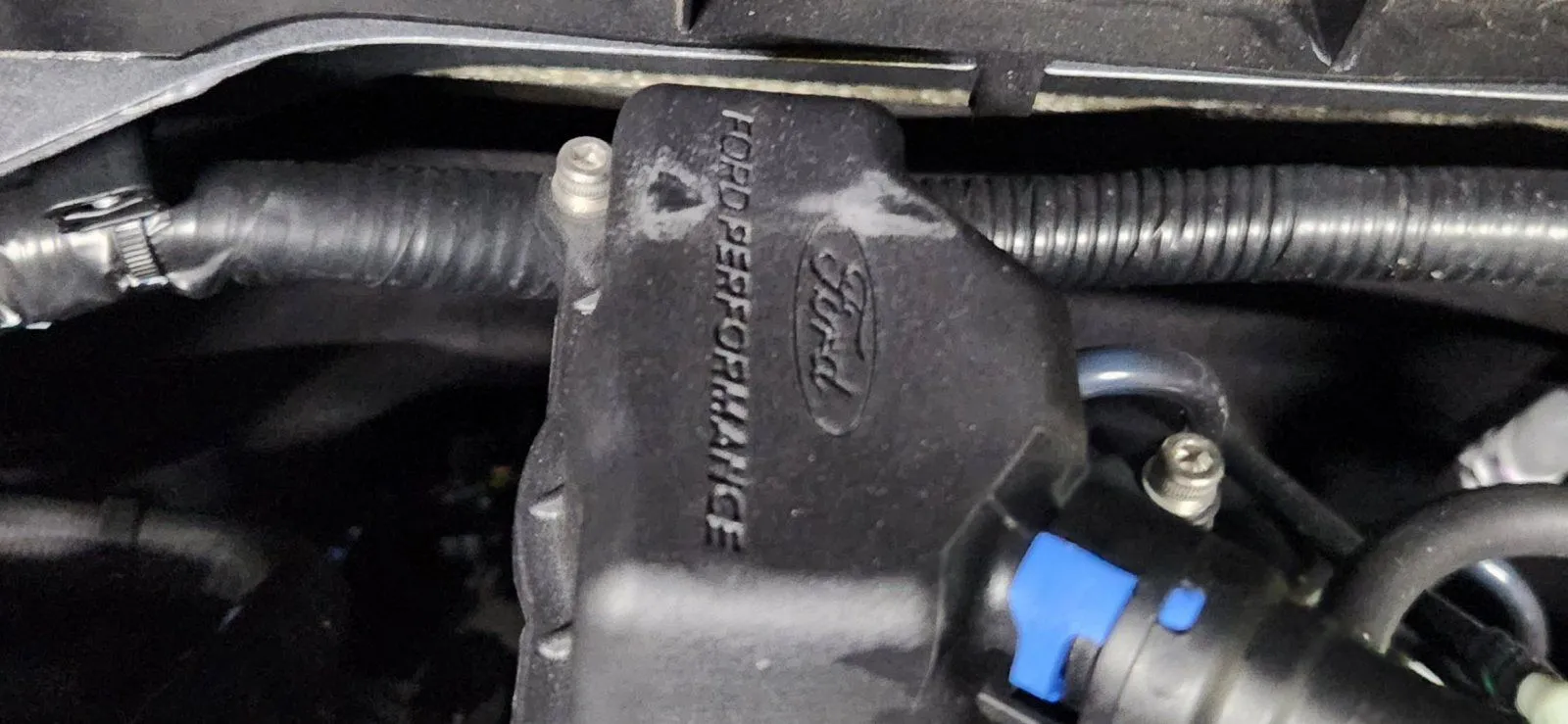

Just joined the site and stumbled upon this. I installed the FP catch cans a few months ago and probably have just over 2,000 miles on them. I was planning on taking a look at how much oil/condensate they may have collected and now I see this issue. I'll take a good look at mine and report back.
I have to say, I was not a fan of the retention method for the cans. Simply pushing them down the thin sheetmetal bracket ears, I kept thinking that certain engine frequencies may have them shimmy vertically and become somewhat loose. The hoses keep them from completely extricating themselves but they may no longer be firmly retained. I was not a fan of the "passenger" can elevation either but beyond that I do believe they are a solid part offering.

Welcome to BroncoRaptor.com! 🍻 Check your hood and mitigate with similar temporary solution as @Roughstock dealer above provided or remove to prevent further damage. Although unlikely, I'm hoping for you that your Raptor has enough build variance that it hasn't caused any significant damage.
Yup, exact same wear patterns and in the exact same locations.

My thoughts...the "retention system" design also has to function in a way so as to allow easy removal. You literally just slide the separator up and off the sheetmetal bracket (once the hoses are disconnected). A noble idea but the execution falls short. There is no retention method once the separator is fully seated. I recognized this may have been a potential issue immediately upon unboxing and studying the parts when new. When I installed mine I not only pushed the separator body down by hand but I gave a few closed fisted thumps to the top when all was said and done. My passenger side separator was down as far as could go and wasn't loose but it still rubbed the hood. My driver side separator was loose (and I tweaked the A/C line like shown above for additional clearance) and I had thumped that one down too, along with grabbing the body after that as well to ensure it was down as far as possible.
I suspect that Roughstock's passenger side separator may not have been fully seated and was barely on, given the wear pattern. If not due to that, he's got some variance in either his engine mounts or in his K-member that resulted in his engine sitting a hair higher than the FP engineers believed to be "normal." My guess would be that this is not the case.
I think Ford needs to design a separator top that has a contour to clear the hood reinforcement and they need to figure out a way to stop the separator bodies from coming loose. Certain engine frequencies no doubt are hard at work to shake these push on bodies, loose.

It was on fine. It sat fairly high but it was secure. I think the reason for all the rubbing is my driving habits. I Baja off road a lot and the engine power train is up and down considerably. When you get air the vehicle is is really bouncing especially if you are not on soft sand.
It seems to me a design issue.
