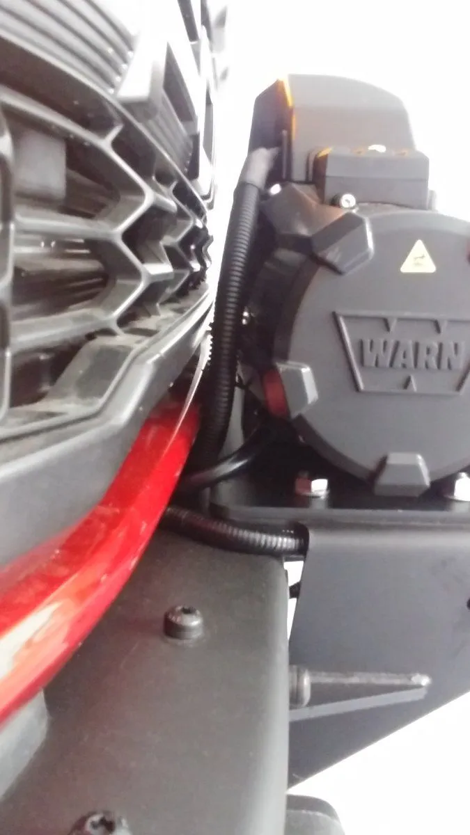

RC - Bronco High Winch Mount w/ 20" light bar51067
M2M - Bronco Front Camera Relocation BracketBR6FCRL
Warn - ZEON 10S winchW89611
Warn - ZEON winch cover102639
Factor55 - flatlink‎00050-04
Factor55 - 1.5" howse fairlead‎00019

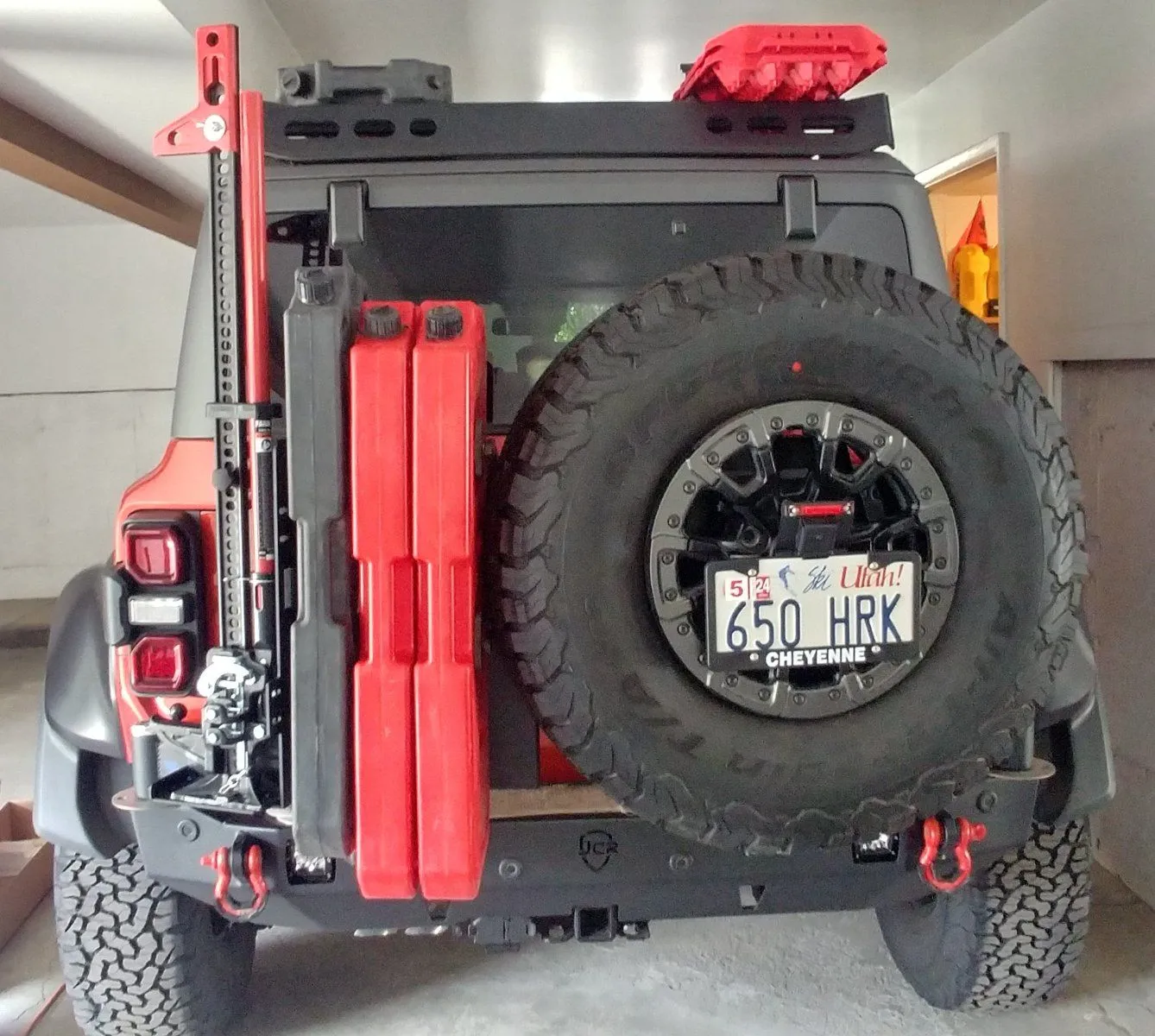

Rear
JCR - Bronco Rear Vanguard BumperBR6RV
JCR - Rear Bumper Swing-out (Left)JCRAC-D
JCR - Rear Bumper Swing-out (Right)JCRAC-P
JCR - Universal Tire MountUNI-TM
TNT Welding - weld bolt studs on tire mount
JCR - Bronco plate/light/rear camera RelocLPRLC2
JCR - Bronco Tailgate Plate (tire delete)BR6-TGC
Expedition One - Geri Mount BracketGERI-MNT-DSTC
Expedition One - Geri Latch w/ EXTLatch
Expedition One - 4-gal Geri Cans: (2) H2O; (2) gas
Rynoskin - HiLift jack mount
Rigid - 3x3 Flood Lights (pair)202113

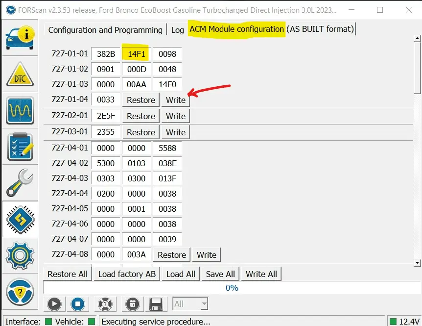

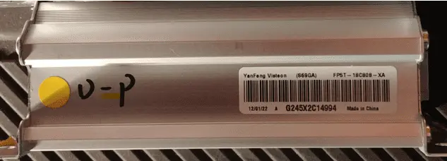

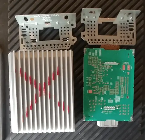

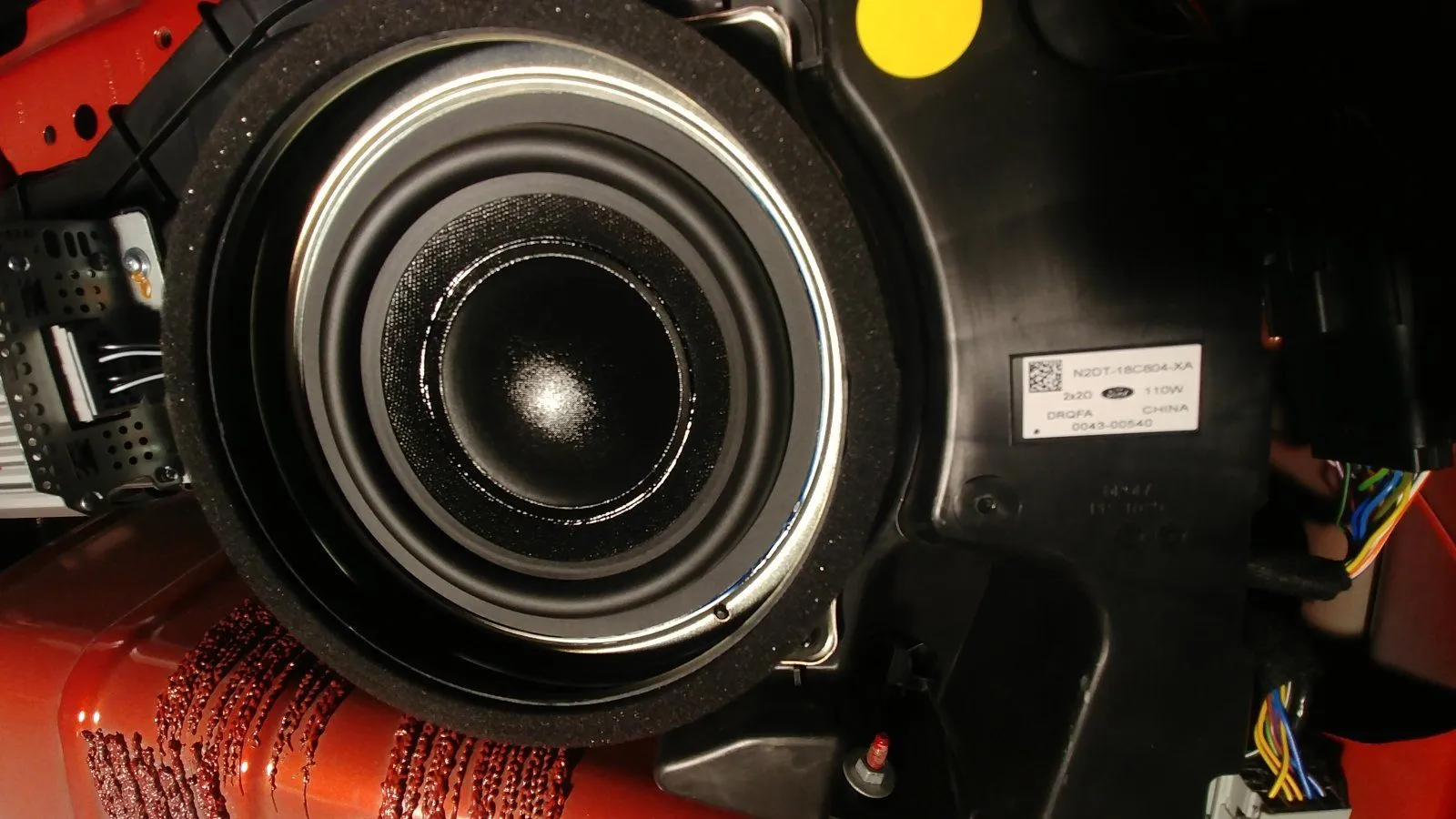

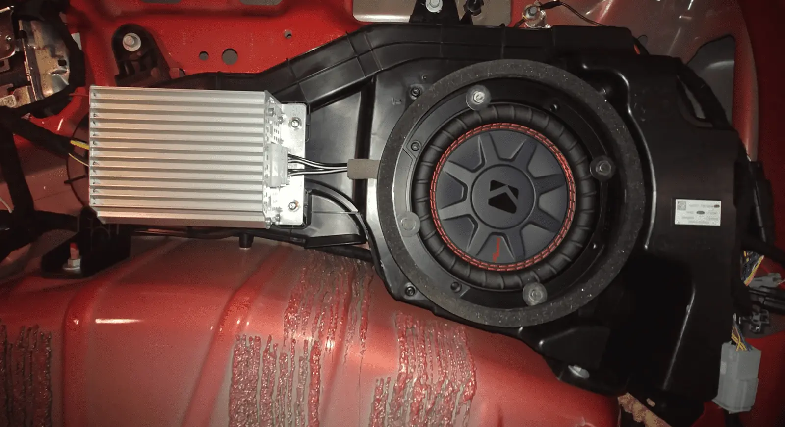

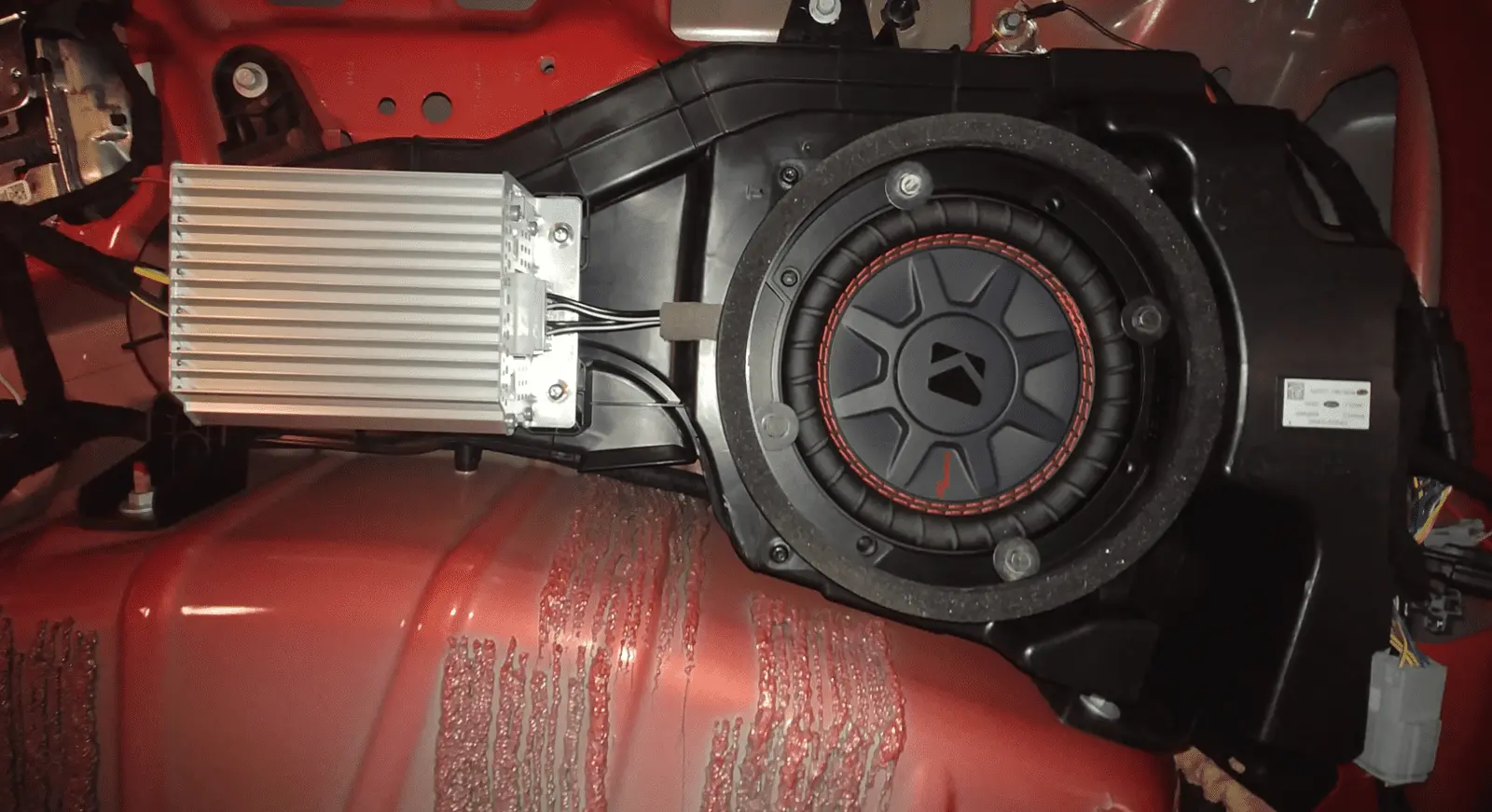

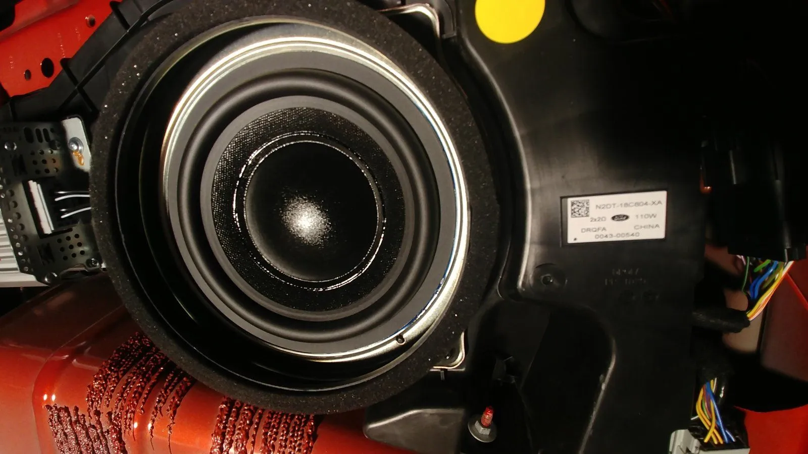

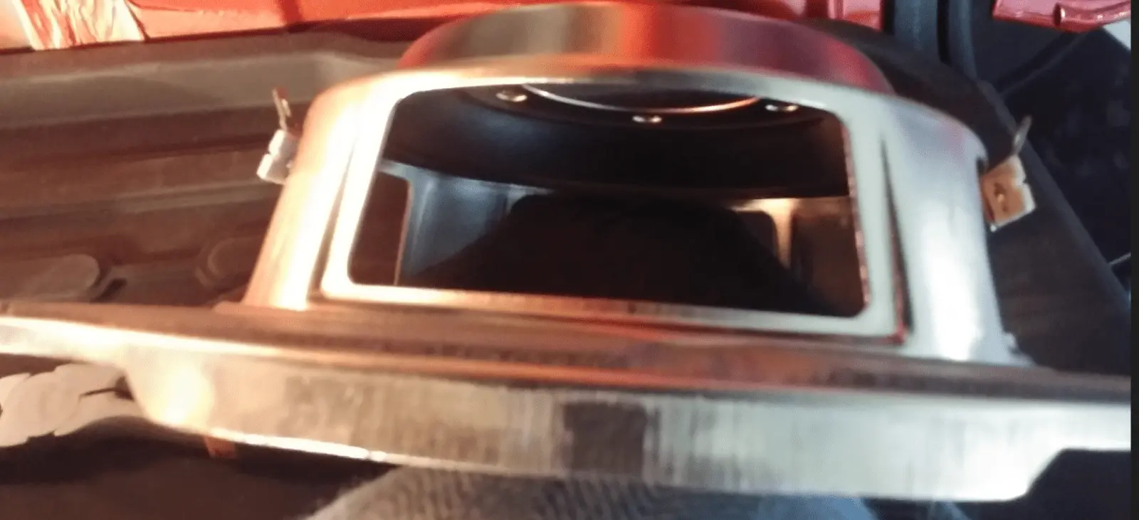

DIY Subwoofer and Amplifier Upgrade
I finally had some time to write up this mod. It is definitely worth the effort for anyone who got caught up in the Option Code 58E, 2023 Subwoofer delete.

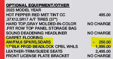

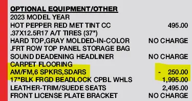

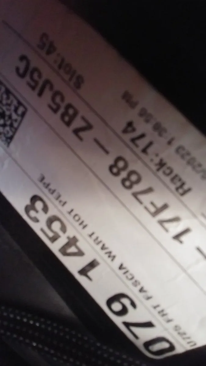

This option code will automatically be added to affected vehicles. Vehicles with this option will be produced with 6-speakers; however, they will be equipped with a non-functional amplifier that does not support subwoofer functionality. The vehicle will not retrofit (meaning Ford will not upgrade this in the future).
" This particular option deletes the subwoofer from models equipped with the standard sound system, which typically has seven speakers including the subwoofer. This option pertains to Base, Big Bend, Black Diamond, Outer Banks, Badlands, Wildtrak, Everglades, Raptor, and Heritage Edition series models. However, it seems as if this will apply to all non-B&O sound systems moving forward. "
The ‘Audio – Six (6) Speakers Subwoofer Delete” option will be listed in the Optional Equipment section of the Window Sticker and customers will receive a $250 MSRP credit on the vehicle invoice.
🌶️ As-built: (note PN N2DT-18C804-XA, where the XA denotes non-functioning subwoofer)
First, a big shout out to @FCoyote at Bronco6G for his informational links.
Second, these are the parts (or similar) you will need:

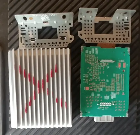

Background, why does the amp and speaker need to be replaced? Short answer: Ford inventory constraints. Dummy amp has no chips on circuit board. Dummy speaker has no magnet. It appears the dummy components are there only to connect the viable wiring.
Follow directions given by a host of others at Bronco6G, 2023MY Standard Audio (6-speaker) Subwoofer Delete Mandatory and Functional Amps Removed.
Note PN of new amplifier; same as dummy except the version is AB.
Installed new components

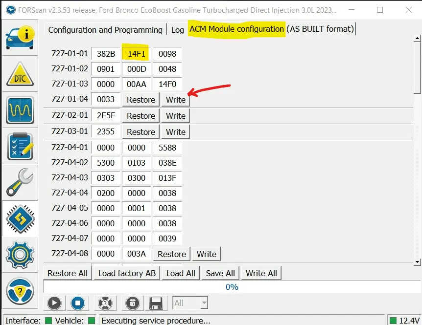

Handy FORscan link at Bronco6G: https://www.bronco6g.com/forum/threads/how-to-forscan-audio-speaker-mods.71145/post-1885939
  • Turn on truck
  • Connect OBD2 reader
  • Start FORscan software and let data populate
  • Go to ACM module
  • Update 2nd HEX number at 727-01-01 node to activate subwoofer; from 14F1 to 16F1
  • Write new progamming to truck
Tweak sound as needed. Enjoy subwoofer.

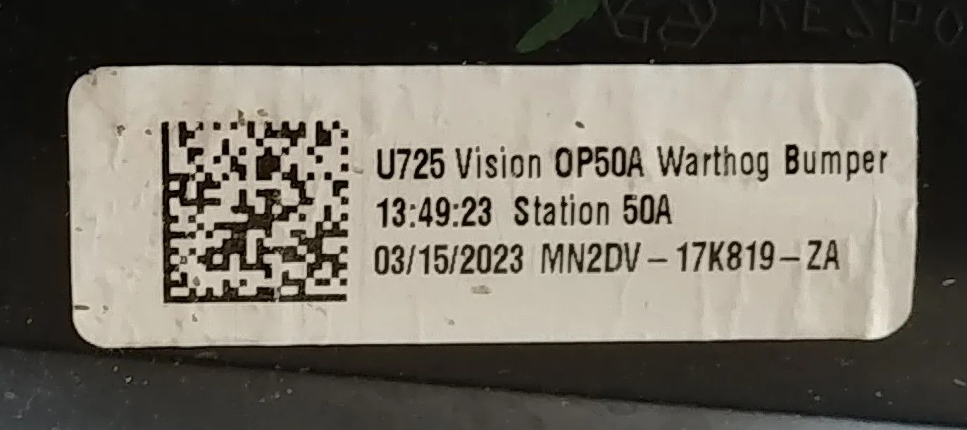

Found these labels while routing wires. Yes Virginia, it is a Warthog!
