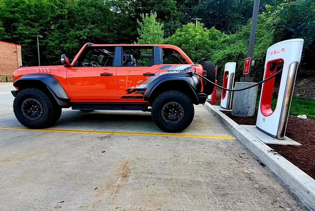

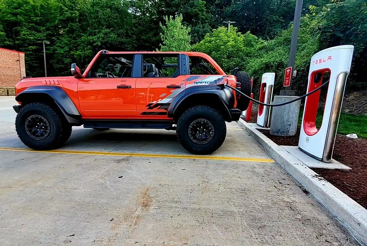

Hmm, so the EV station is a cross between a Horsey & Dinosaur Tail? Appears it's true that history repeats itself...
Hahaha...never thought of it that way. Now with the picture you can even almost imagine it!!!
It was fun taking a couple of pictures while some were wondering what in the world???
