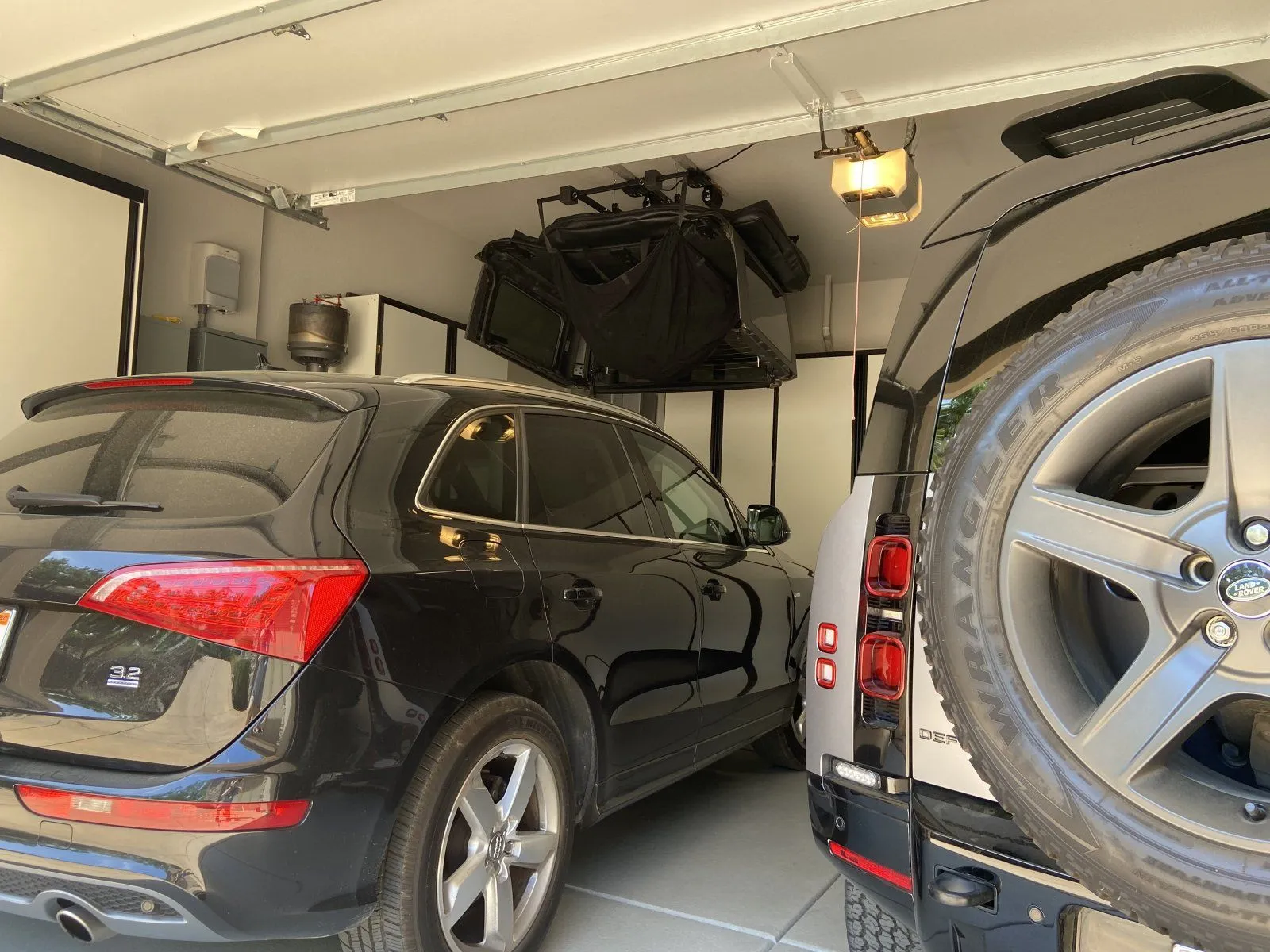

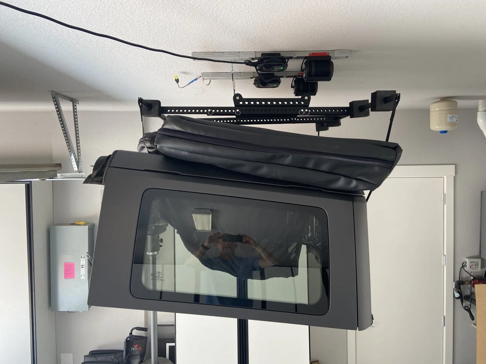

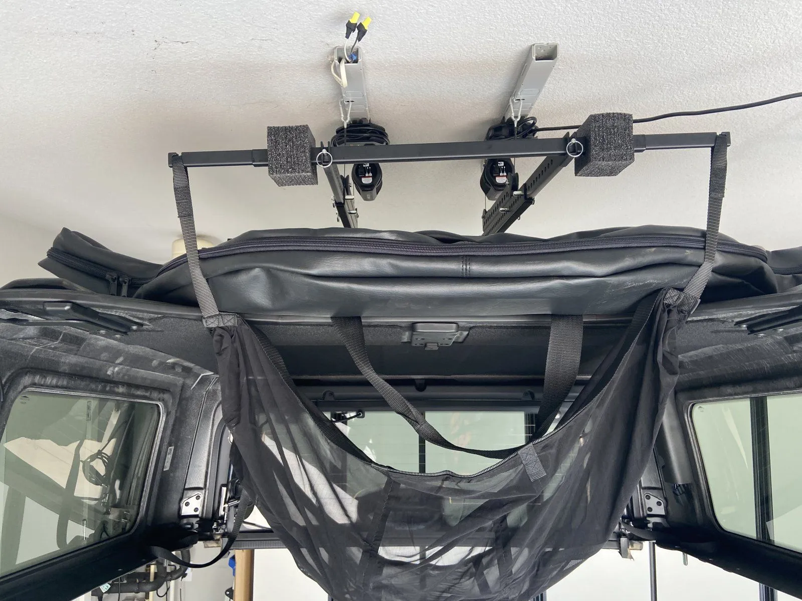

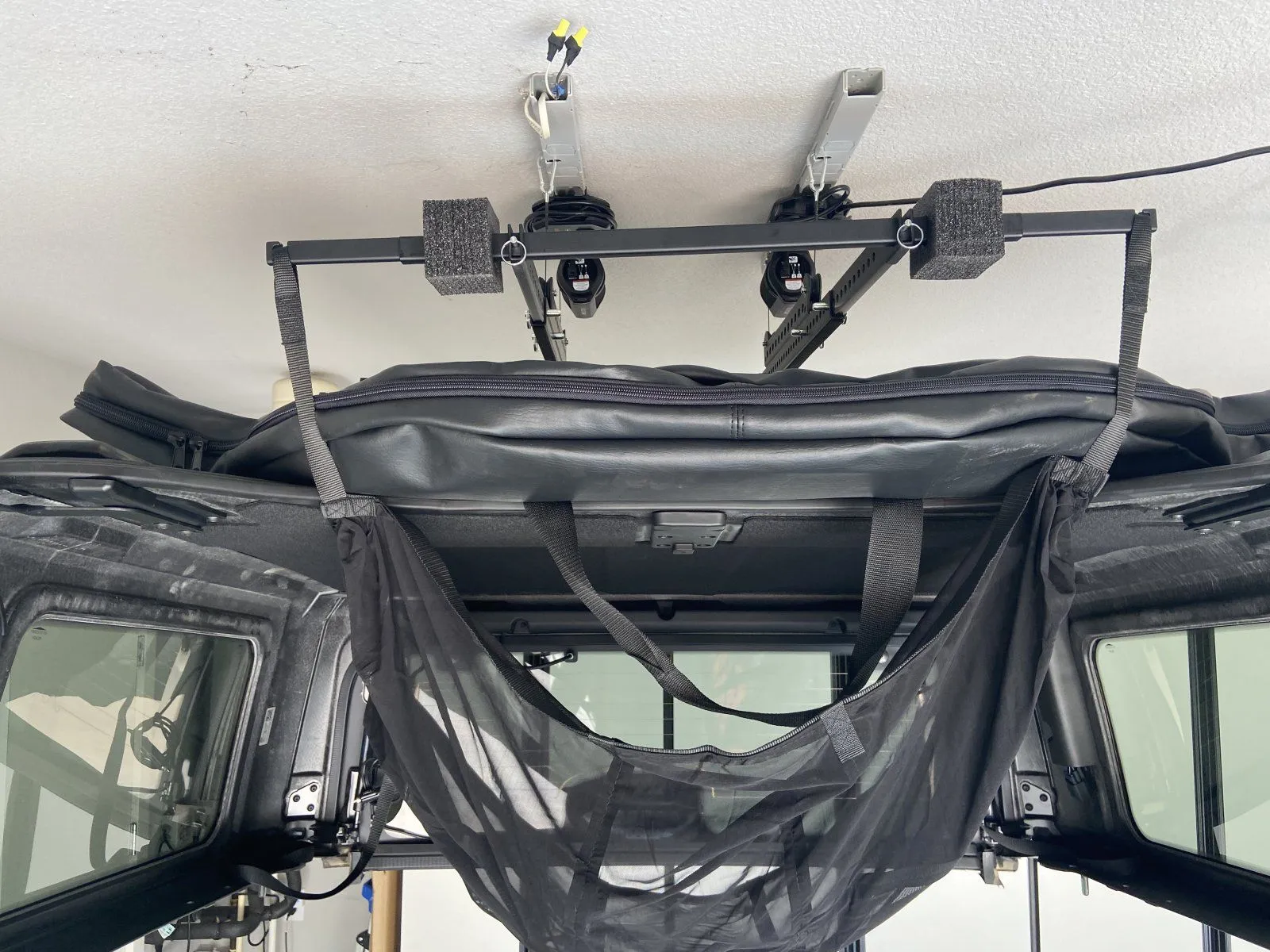

Installed the SmarterHome Bronco Hard Top Lifter today.
Positives:
- great material and build quality
- exceptionally well thought through design, down to clever cable management
- Easy intuitive app which paired with winches without an issue
- great control, super slow for the critical last few inches or faster for running the top up or down to storage
- out of the way when in use or not in use
- pretty easy to install, once you figure out the missing and conflicting instructions
- you can easily walk under it when top is stored with 10’ ceilings, I’m 6’2”
- uses 110v outlet from garage door opener
- no ground based View attachment 7828View attachment 7829View attachment 7830lifter to store when not in use
Negatives:
- despite exceptionally well thought through design, the instructions and company videos are pretty poor. The written instructions contain some conflicting illustrations and don’t contain relevant information, like how wide to set the cross bars. The videos are more marketing than actually helpful. They gloss over most of the installation.
- placement could be a challenge depending on the size of your garage and placement of garage door openers, lights and other items on your ceiling.
Note: ignore the electrical wiring in picture, I am in the process of relocating a light fixture. The lifter is powered by plug in cord.

After a year of ownership I’ve got a mixed opinion.
I think that there are two good off the shelf options and your situation dictates which is better.
i went with it based on the fact that I don’t have room for the Smartlifter Pro because I have to back in (I can’t park the nose under it) and I wanted my top out of the way (you need pretty high garage ceilings to be above head level).
while it’s not hard to operate, it takes a while. Putting the JTops Bimini really complicates things as you have to fish straps between roof and the bimini and taking off and replacing the rear seat roof section is a lot harder for me to do solo. The former may be easier or harder with the SmartLifter Pro, but I don’t think it’s an issue. The latter comment is more of a consideration if you’re thinking of buying the Bimini and removing your top a lot solo with any lifter.
It’s a bit of a challenge getting lined up under the hoist both front to back and side to side, but I’ve placed painters tape on the floor to guide me with the rear camera. The SmartLifter pro looks easier as you roll the lifter to the truck, no guessing if you are in position or not.
the balancing of everything takes a bit of practice and adjustment and leaving the rear window open or closed changes things significantly.
so Overall it works OK for me, but I think if I had the space to stash the Smartlifter I would have gone with that and it would have been easier.
hope that helps
