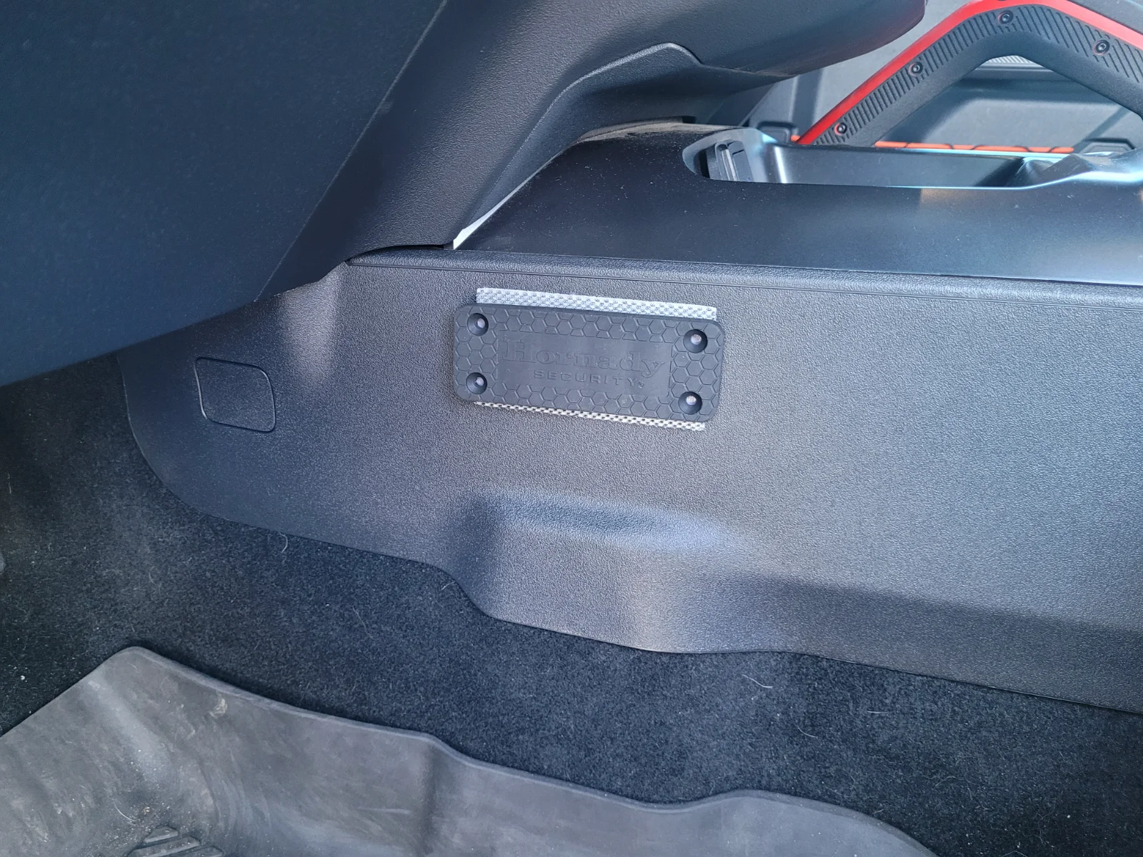

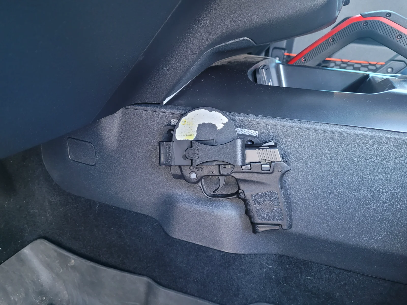

I don't want to trigger anyone today at the sight of what I'm about to show you... so prepare yourselves...
I made some of my "office supplies" more accessible and secure while I'm Rollin' Rollin Rollin Rollin!
https://www.cabelas.com/p/hornady-magnetic-gun-mount
A man's got to do what a man's got to do...Looks good
