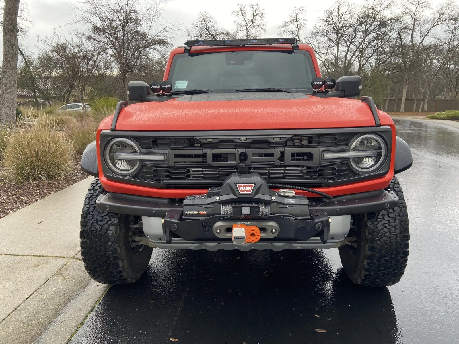

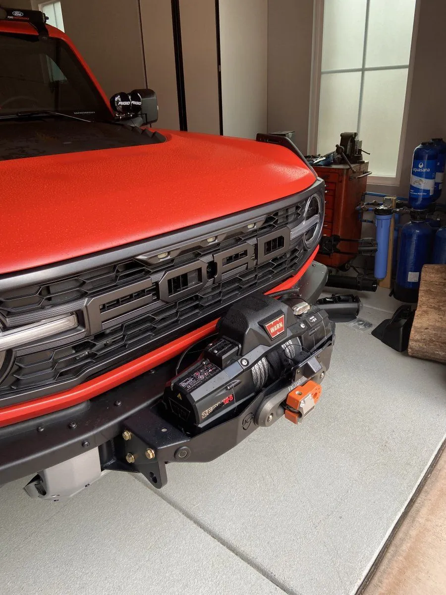

Today on the season finale (probably not actually) of “What Did With Do WithYour Bronco Raptor Today?” Randy completes his winch project.
The mounting, reassemble and spooling went pretty smoothly, but I forgot to put the silver plastic front cover on before mounting the winch plate, winch and cable routing. Other Broncos have two separate panels that mount on each side of the tow points, while the Raptor‘s single piece loops over the top. Fortunately, after suffering an oh sh*t moment or two, I realized I could just unbolt the six bolts on the winch plate, lift the assembly and slip the cover in. Crisis averted.
and there were a few choice words threading rope and inserting the puck in the winch. Hated that each time I’ve done it.
But it’s all done with minimal drama, it works (always a bonus) and I only have a little bit of cable / sprayer hose management left to do. View attachment 5661View attachment 5662View attachment 5663
Is that aftermarket or Ford? It looks awesome.
Thanks! Aftermarket. JCR Off-road winch plate and camera relocation bracket, Warn 12-S winch, Factor 55 Fairlead, Flatlink and Rope Guard.
I also pulled off the bumper ends/lights and shoved them in a cabinet. That’s not required to install the winch, but lights are pretty weak and I didn’t like the plastic air dams, it all comes off in one assembly.
