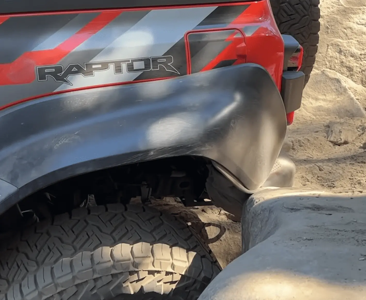

New to the group... Planning a Rubicon Trail Run with a couple EBs and G6s. Concerned about the fenders on the BRaptor (obviously). Anyone know of a fender delete or low profile fender flare kit available? I'm aware of the full replacement fenders but was hoping there would be something more easily changeable for the trails. Tahnks in advance!
FYI, removing the BR flares are not as easy to remove as the regular Broncos. Running with the flare leaves the wheel liners hanging so you either have to remove them or find a flare delete kit (as you requested) to secure the liners.

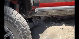

That dang forward trailing arm bracket . . .
Kevin takes a winch to clear the step.
Here's our buddies on the Rubicon with their BR. Best to turn the volume off.
So glad my JCR rear bumper is 3" narrower on each side compared to the OEM bumper. I'm still looking for a BR flair delete kit.

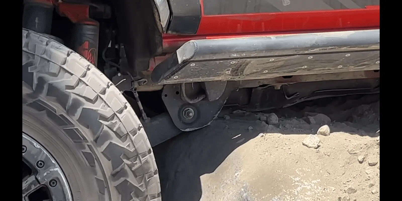

Ford should have added the trailing arm bracket skid like on the Badlands...
Is it possible the newer Bronco Raptors being produced have them on them?
Those skids look really nice for on the Badlands frame.
Yes the mini skids are quite rugged and impressive looking. Pic is from my wife's new Badlands, when I noticed them I was very surprised the Raptor didn't have them since the Raptor lower track arm bracket hangs further downward from the frame than the Badlands.
I've got bracket envy. ;)
I'm trying to read the PN on the bracket and skid . . . 50429AF ?? This is the only number on my brackets.
Interestingly, the Ford parts catalog shows the BR and a Bandlands/Sas frame have the same forward bracket, aka spring shackle bracket, PN MB3Z-5775B. Althought the Badlands does show the little skid without a PN.
