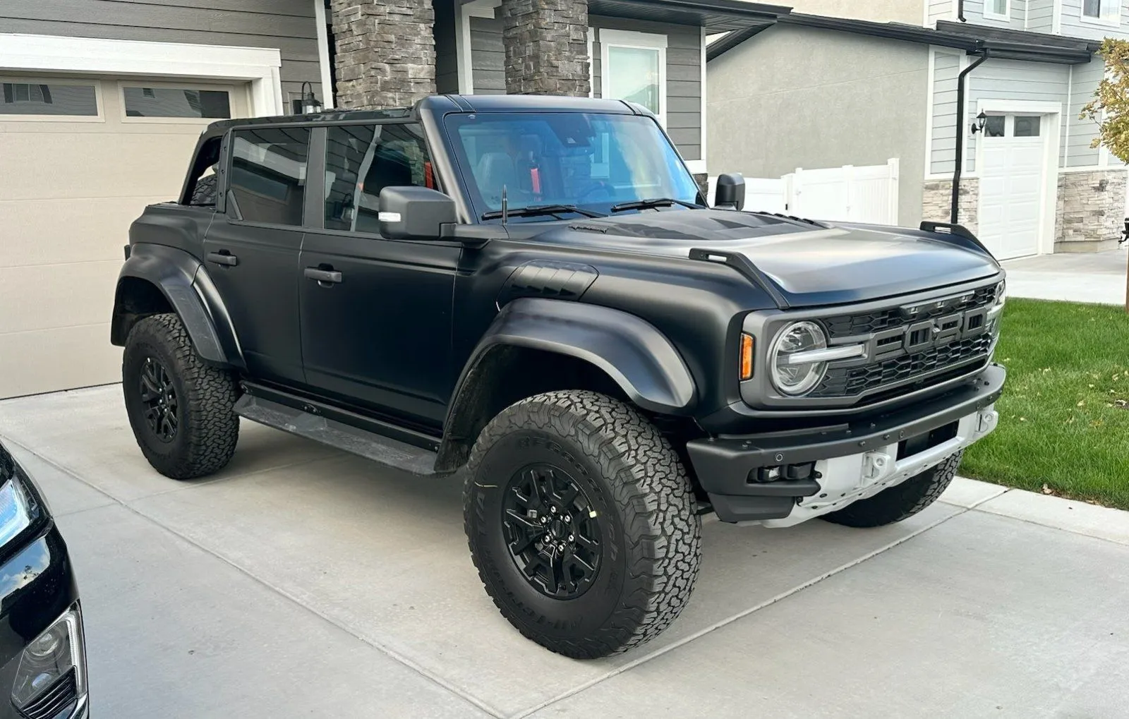

Just finished the base wrap. Satin black. Still gotta powder coat skid plate and then the graphics.
I will interested to see how that turns out.
