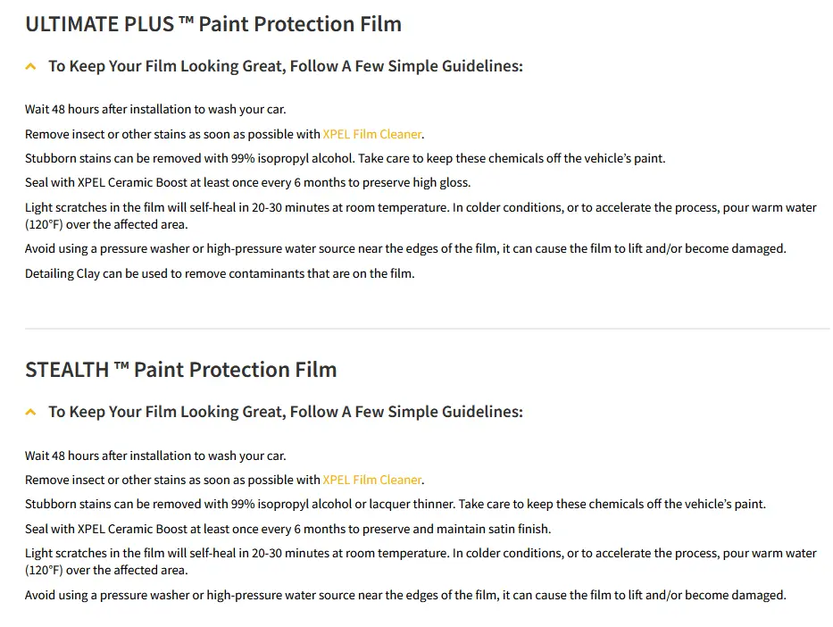

Below screen shot taken from the Xpel care site page, I wasn't sure if the Xpel stealth (satin) was also self healing. Google the film your installer will be using to find if there are similar characteristics.
Below screen shot taken from the Xpel care site page, I wasn't sure if the Xpel stealth (satin) also self healed. Google the film your installer will be using to find if there are similar characteristics.
The operative term here is "light scratches". My experience offroading is that heavy scratches will come into play from time to time. Not sure how well the PPF will hold up then. Possibly the reason that most hardcore wheelers don't bother with it (besides the cost).

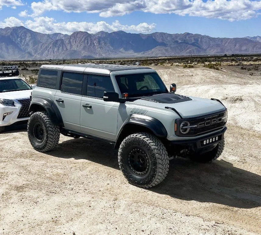

Here’s my Braptor with stealth satin PPF. I was little iffy on how the satin finish would look on Cactus Grey but absolutely love the way it turned out.
Well played! That Cactus Grey is one of the best colors for a stealth adaptation. That really looks good-as do the new wheels and bumper.
