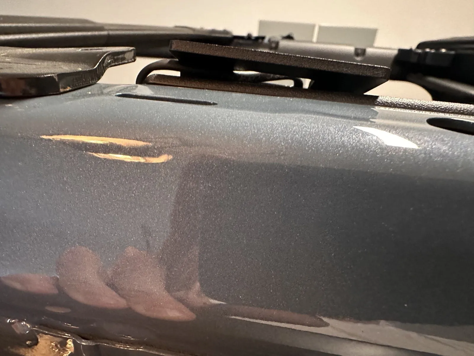

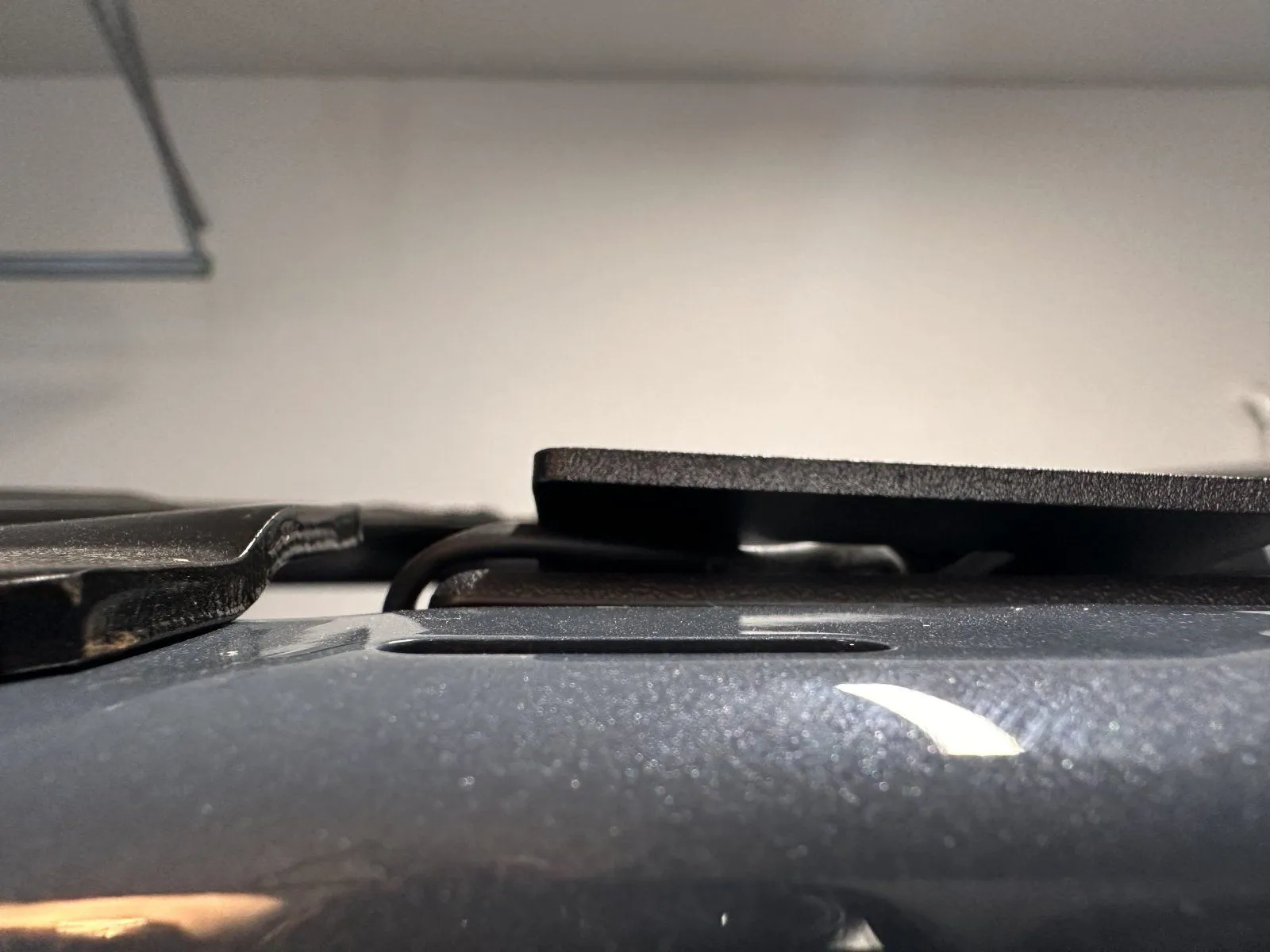

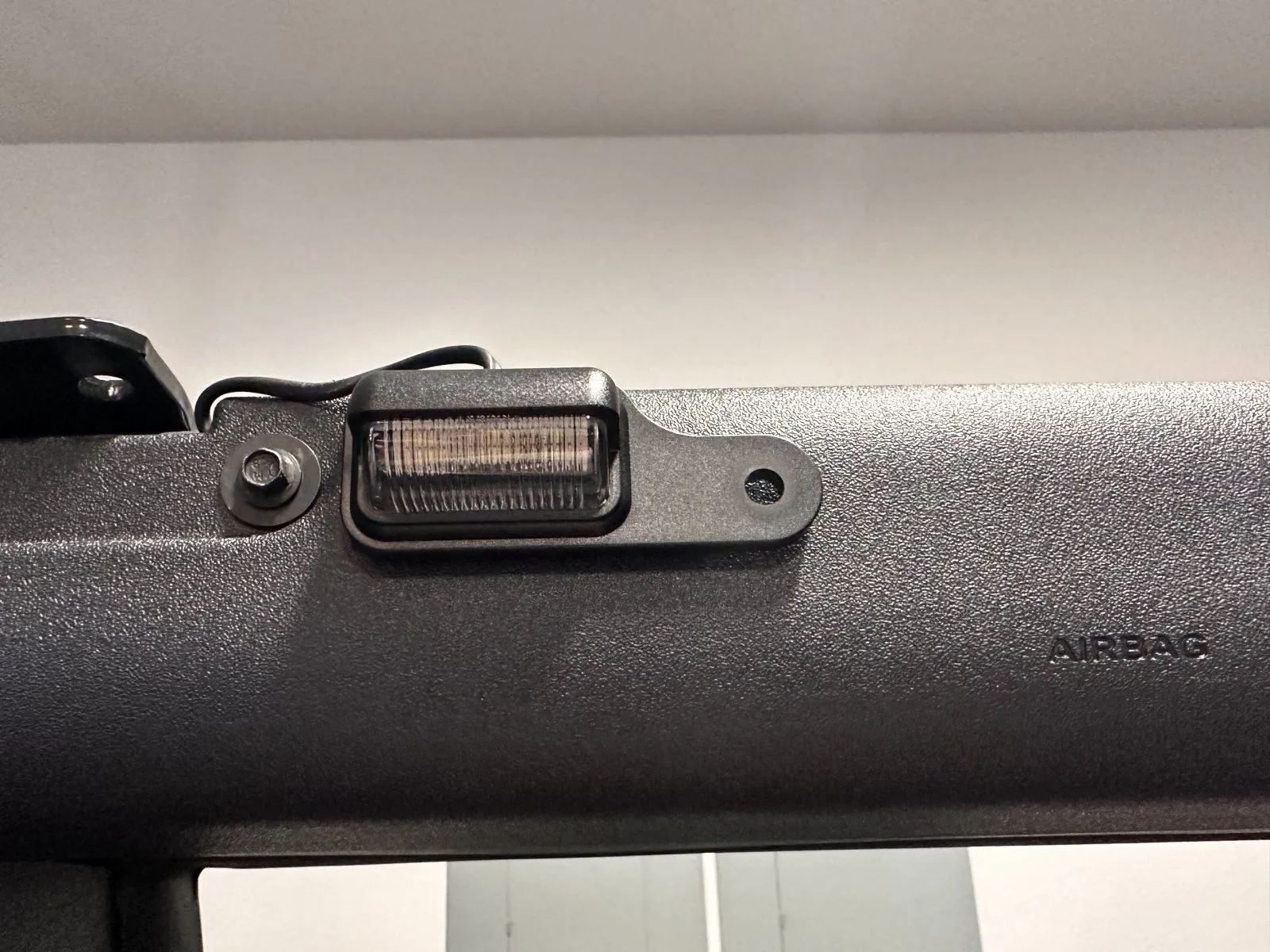

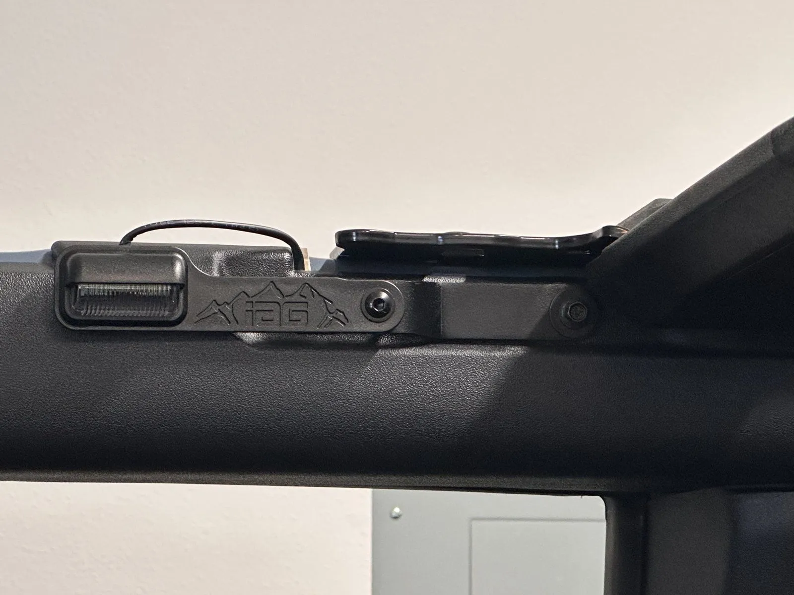

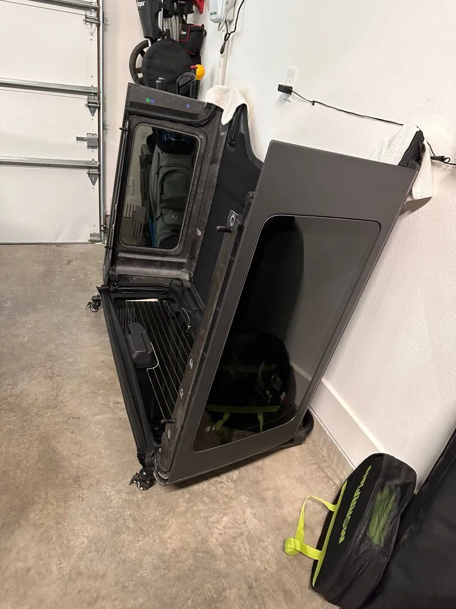

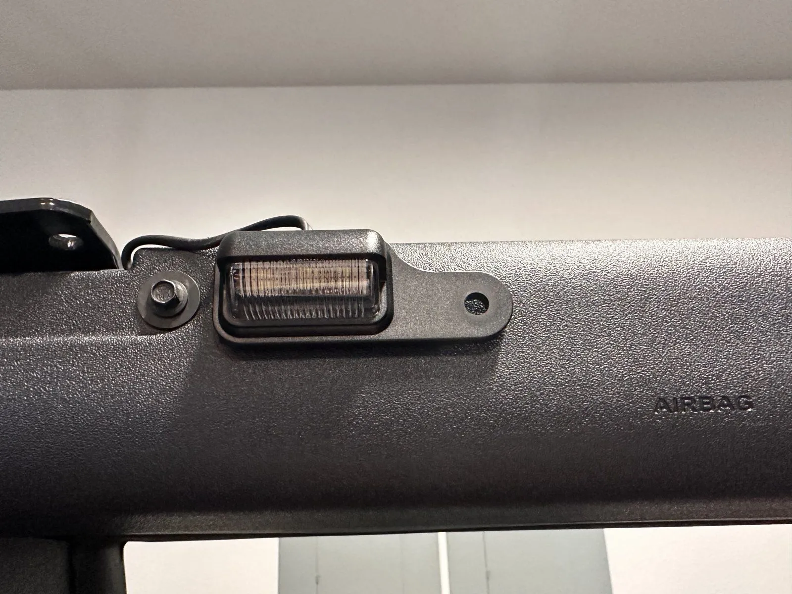

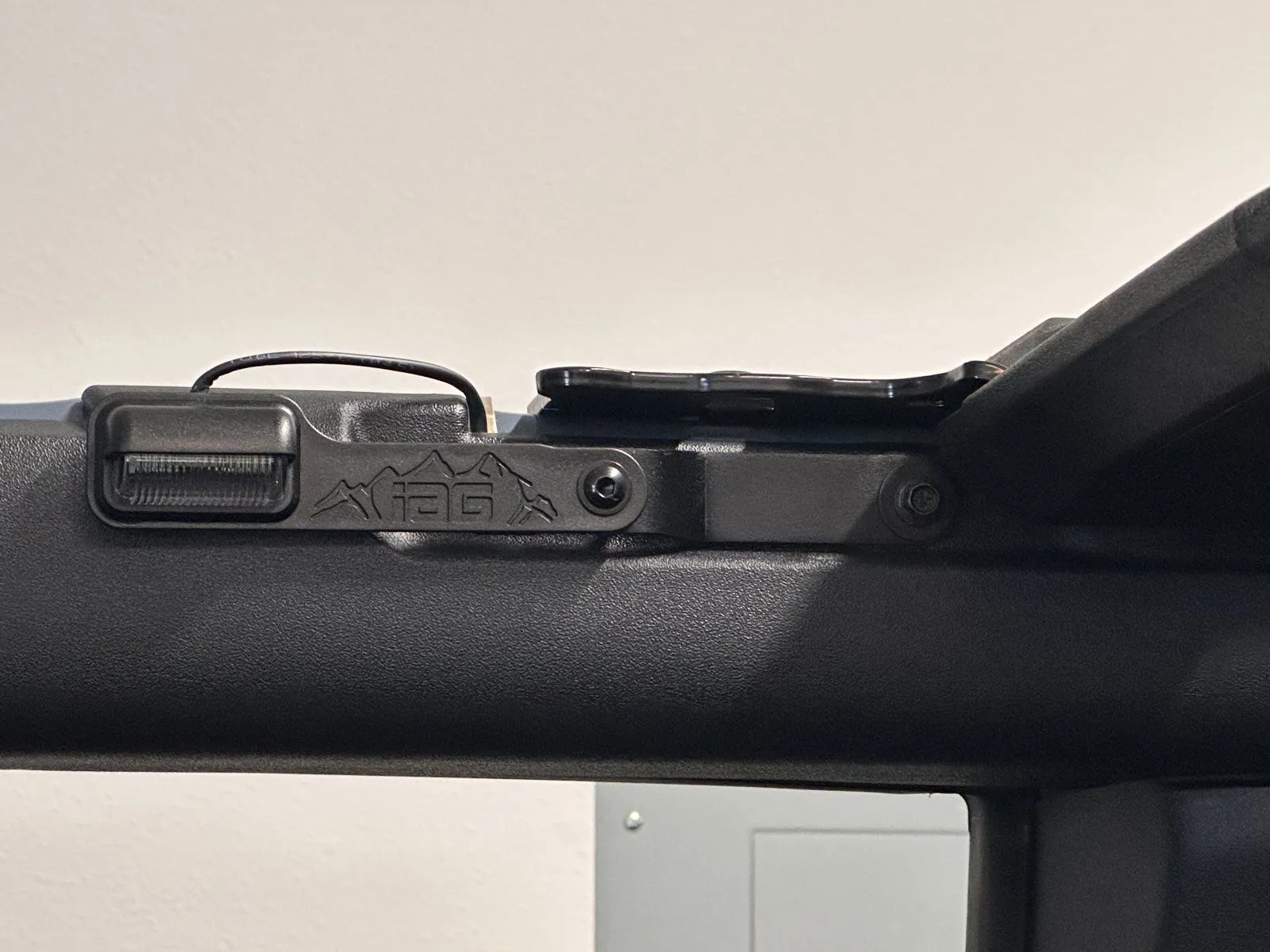

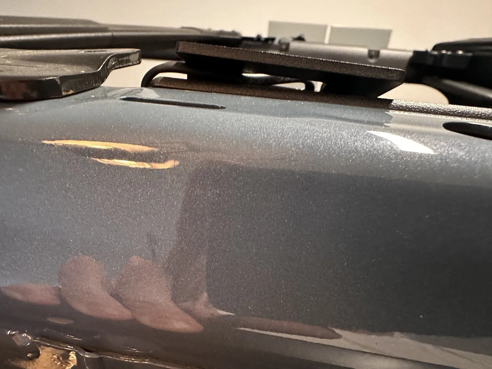

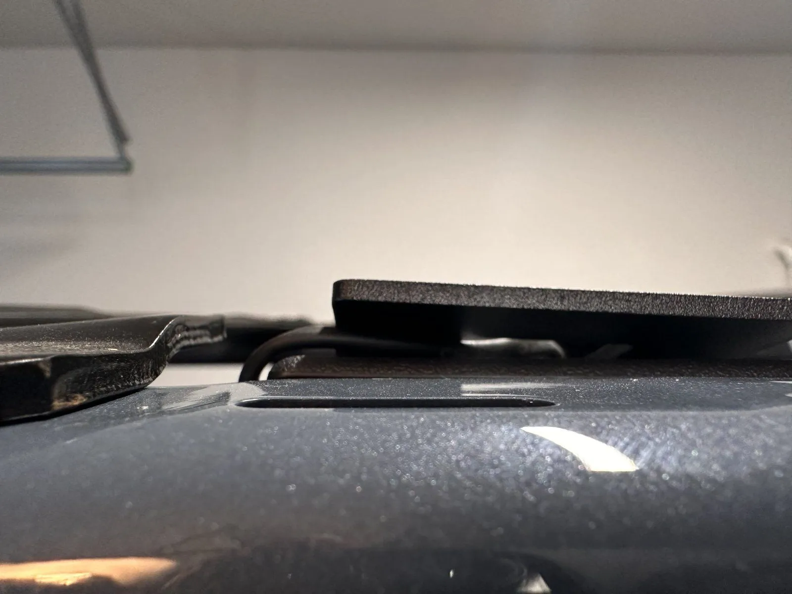

It occurred to me when I took the top off the other day that the front brackets for the IAG interior lights might interfere (if not rub/tear) through the JTops Bimini Sunshade when I install them. If you look closely, the front brackets sit above the top edge of the interior trim covers relatively close to where the JTops will be placed underneath the B-Pillar Raptor brace. Given the JTops appears to fit pretty snuggly (which is a very good thing), I saw a point of potential concern.

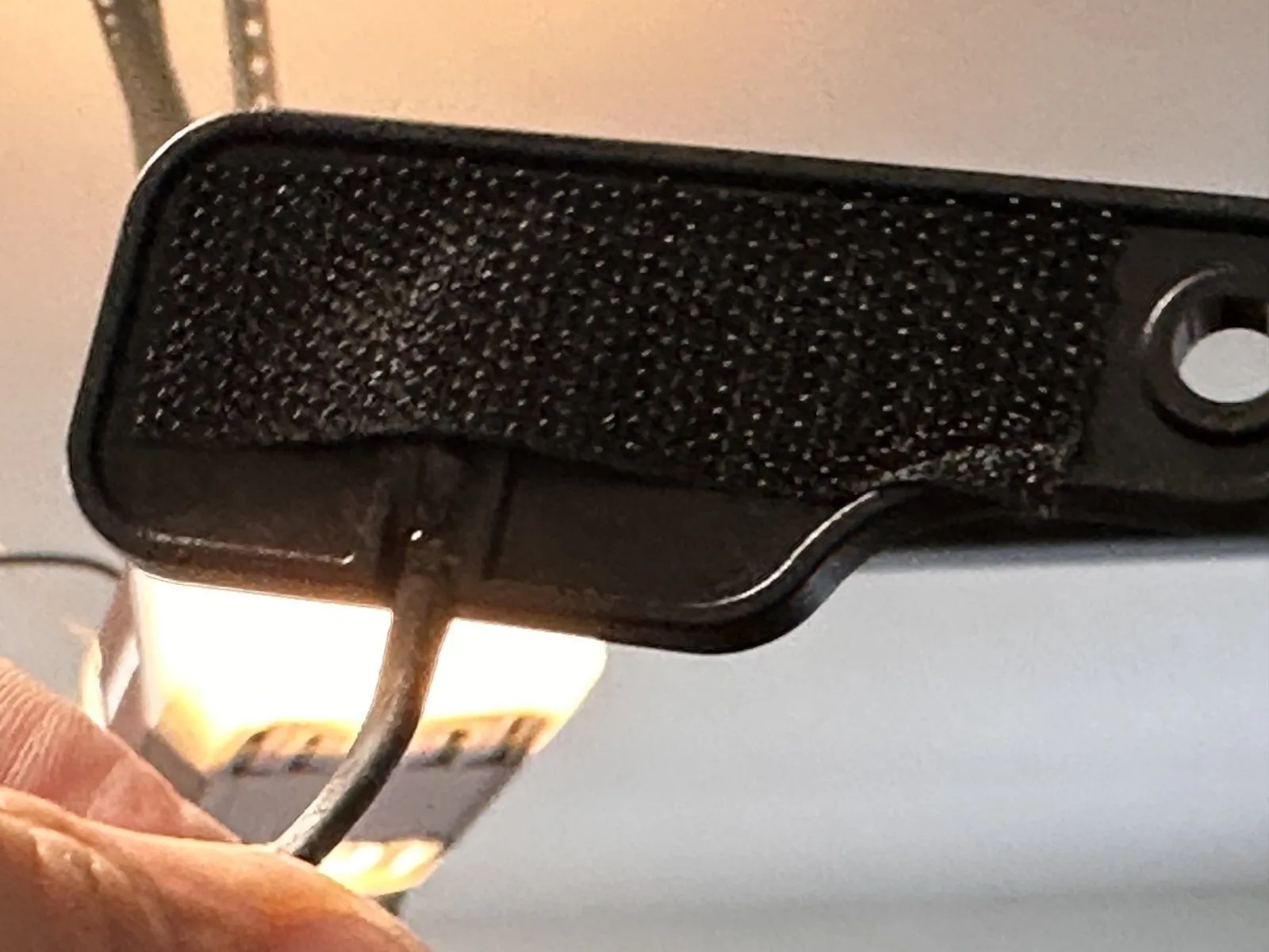

So what I decided was to remove the IAG braces for the front lights and use some Velcro strips to attach the lights to the trim cover panels. This way I’m removing the potential fitment and wear issues of the JTops while also reducing the profile of the lights as well as removing the metal bracket from the interior. I did consider whether this would be an issue with airbag deployment, but the strength of the Velcro should be no match for the deployment of the airbag.
I considered placing the light within the inset of the trim panel cover but I saw that as another potential issue related to the JTops fitting under the brace as well. Once the JTops is installed I may ultimately consider trimming the tab from the light to clean up the look a little more, but that will be a decision made later.
As for the rear brackets, no need as they sit below the top level and therefore are out of the way. But given they are basically a long lever (light + bracket) I’ve noticed that they tend to tilt over time. If I decide to trim the front lights then I might just to the same for the rear: remove the brackets, trim the extra from the rear (removing the branding) and reducing the overall footprint.
