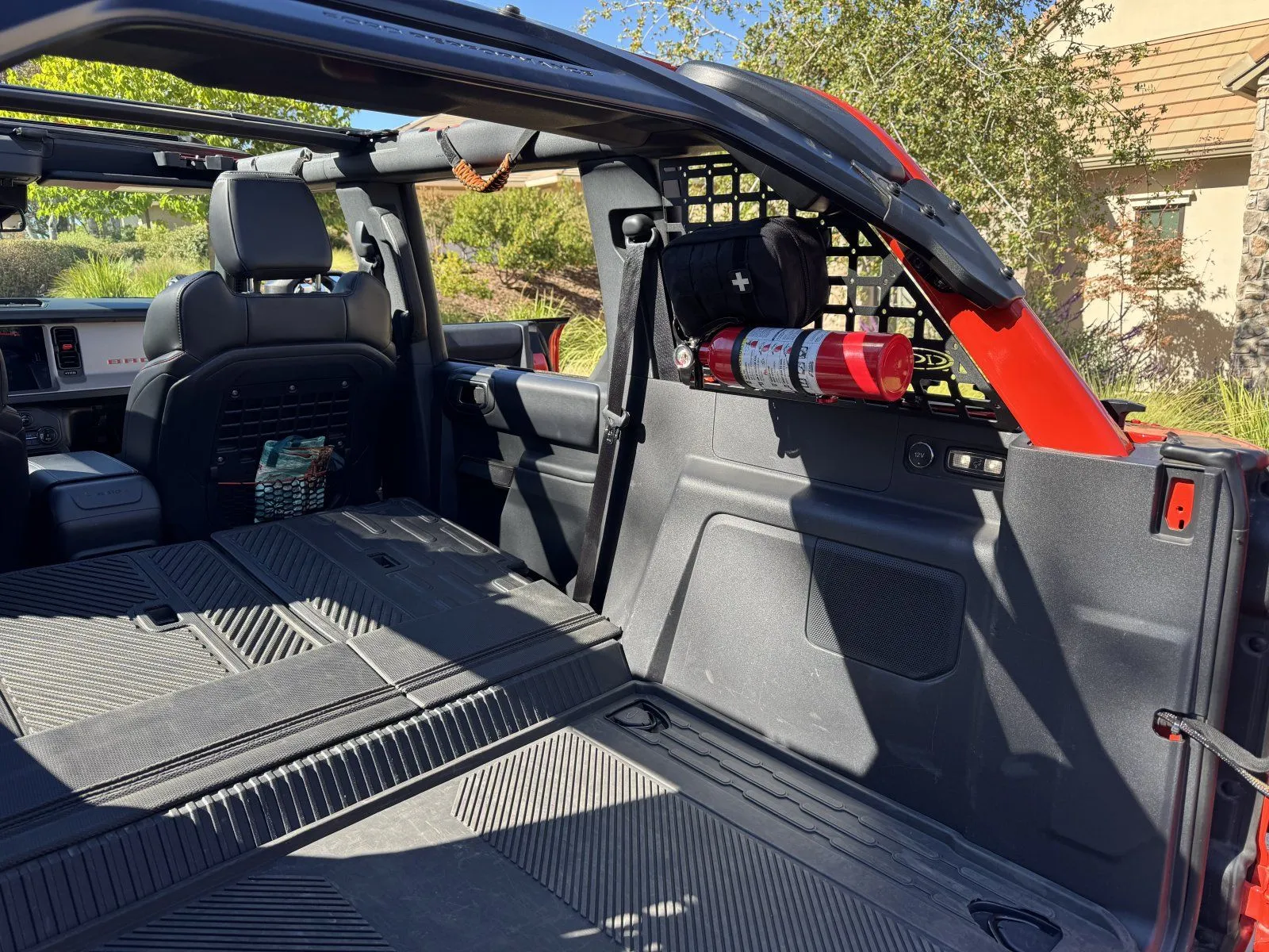

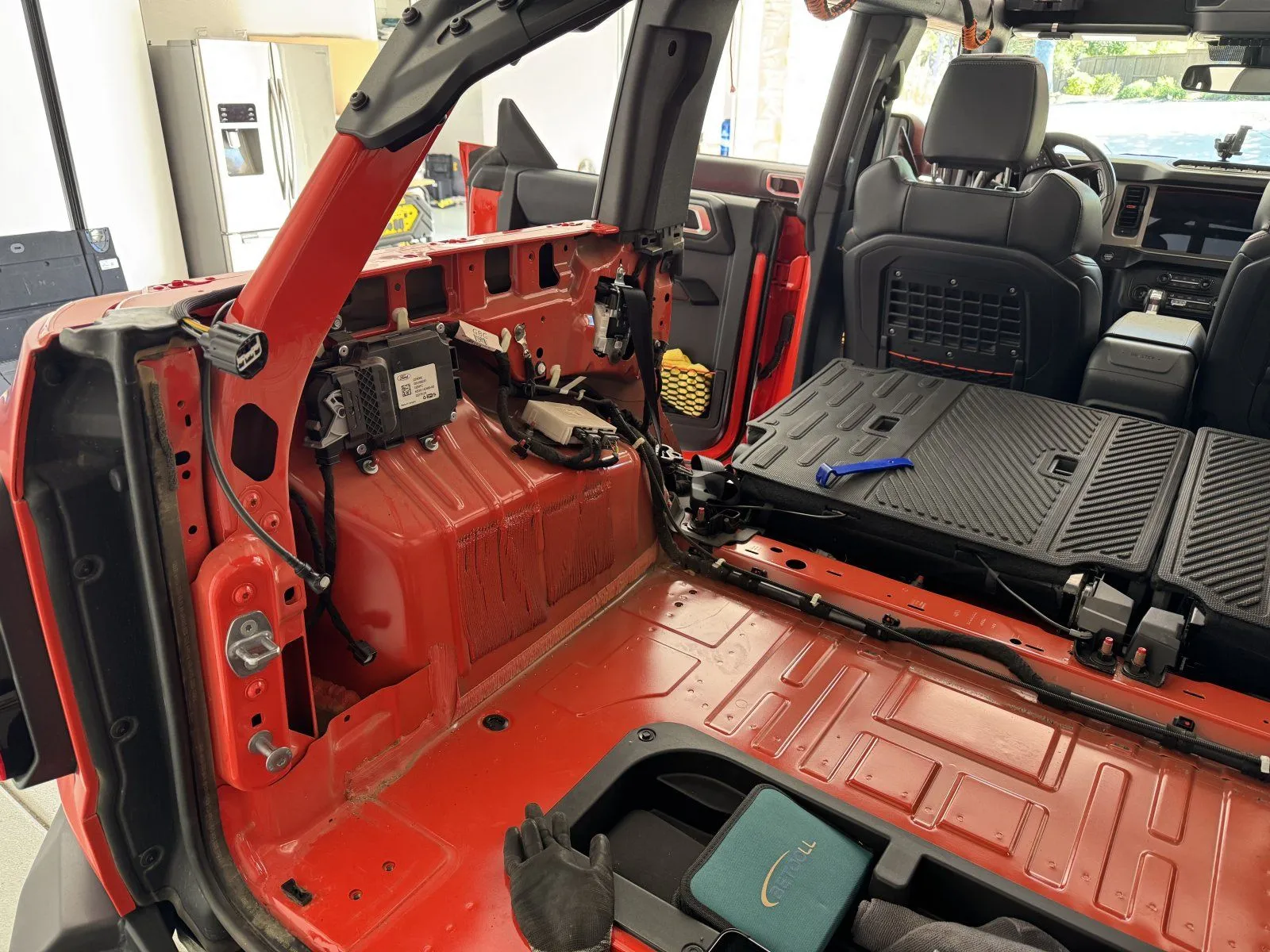

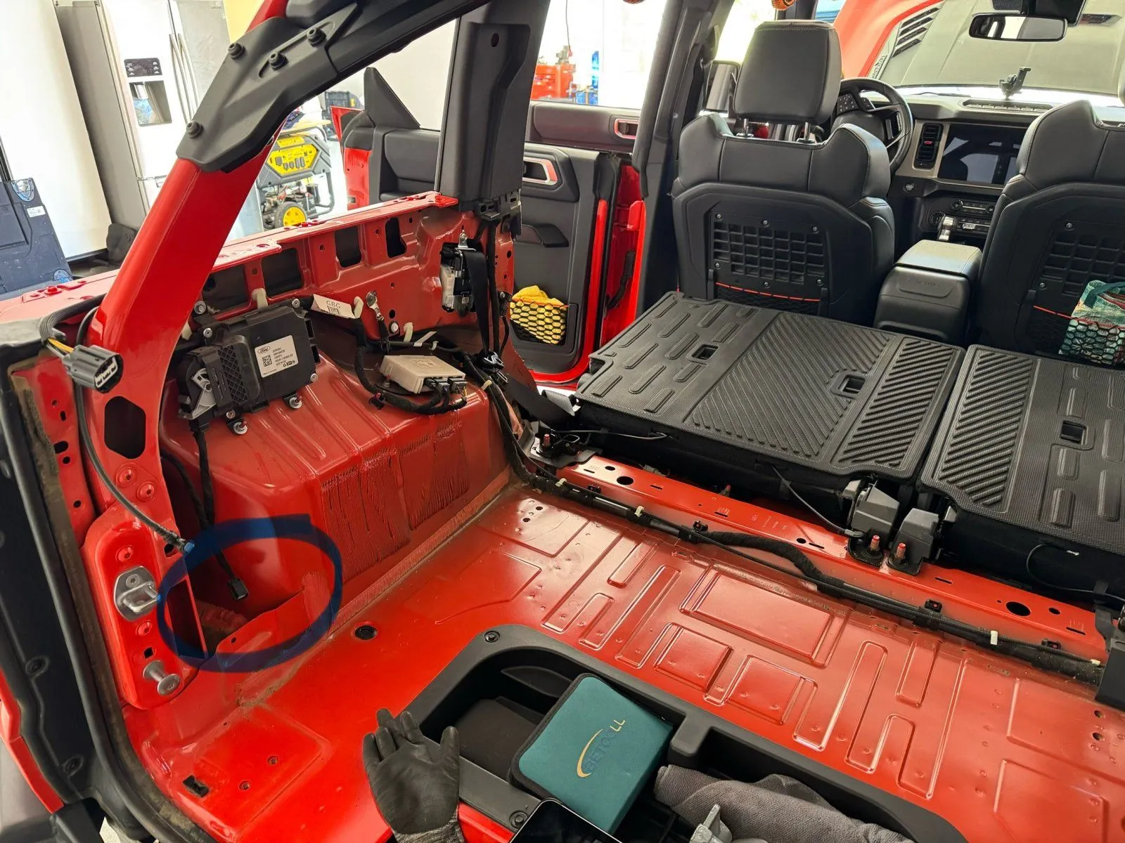

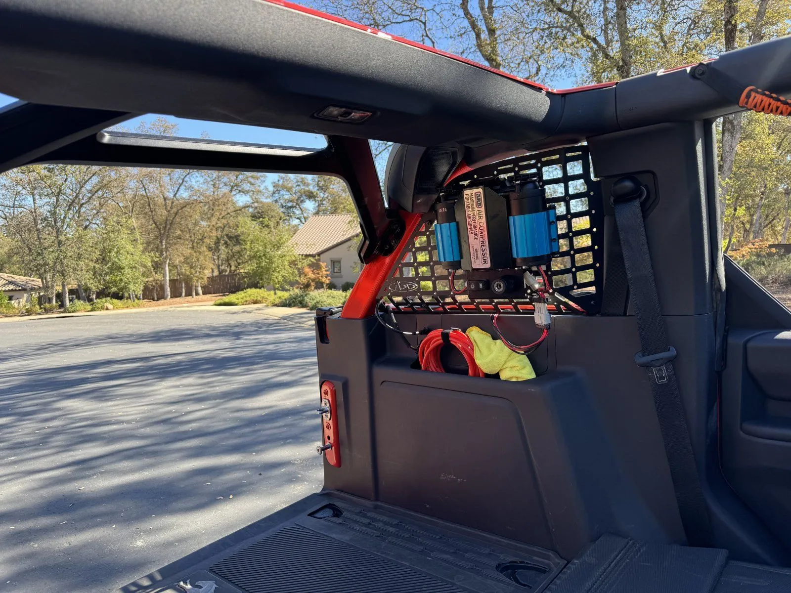

Just finished my ARB Twin Compressor install. The install was easy after installing the ADD rear molle panels, but the wiring…..
Running the twin 10 gauge power supply lines from the bit more of a challenge. I cut up my original harness, so I could easily butt connect in the engine bay near the firewall grommet. Ground point right under the carb trim panel, was super convenient and super close to the compressor. The compressor end of the harness fed nicely in the panel, but I decided to leave the plug exposed for later convenience.
The part in the middle was a pain! I pulled 10 big and small interior trim panels from the drivers footwell to 2/3 of the cargo area running the supply wiring through the cable tray. Took a long time to get it all out without breakage, but snapped back in pretty quick and easy.
Decided to do this vs more weight on tail gate, access issues with loaded truck with DV8 tray etc. Everything is a compromise of some sort including this solution.
FWIW
FWIW

Looks great, fantastic idea. How loud is the compressor inside ?
Loud enough that I wouldn’t want to sit in the backseat when it’s running. But I don’t take a lot of folks with me when I’m on the trail, you only run it when the ride is over and usually everyone’s standing around while airing up anyway. I didn’t consider interior noise to be a big negative for me.

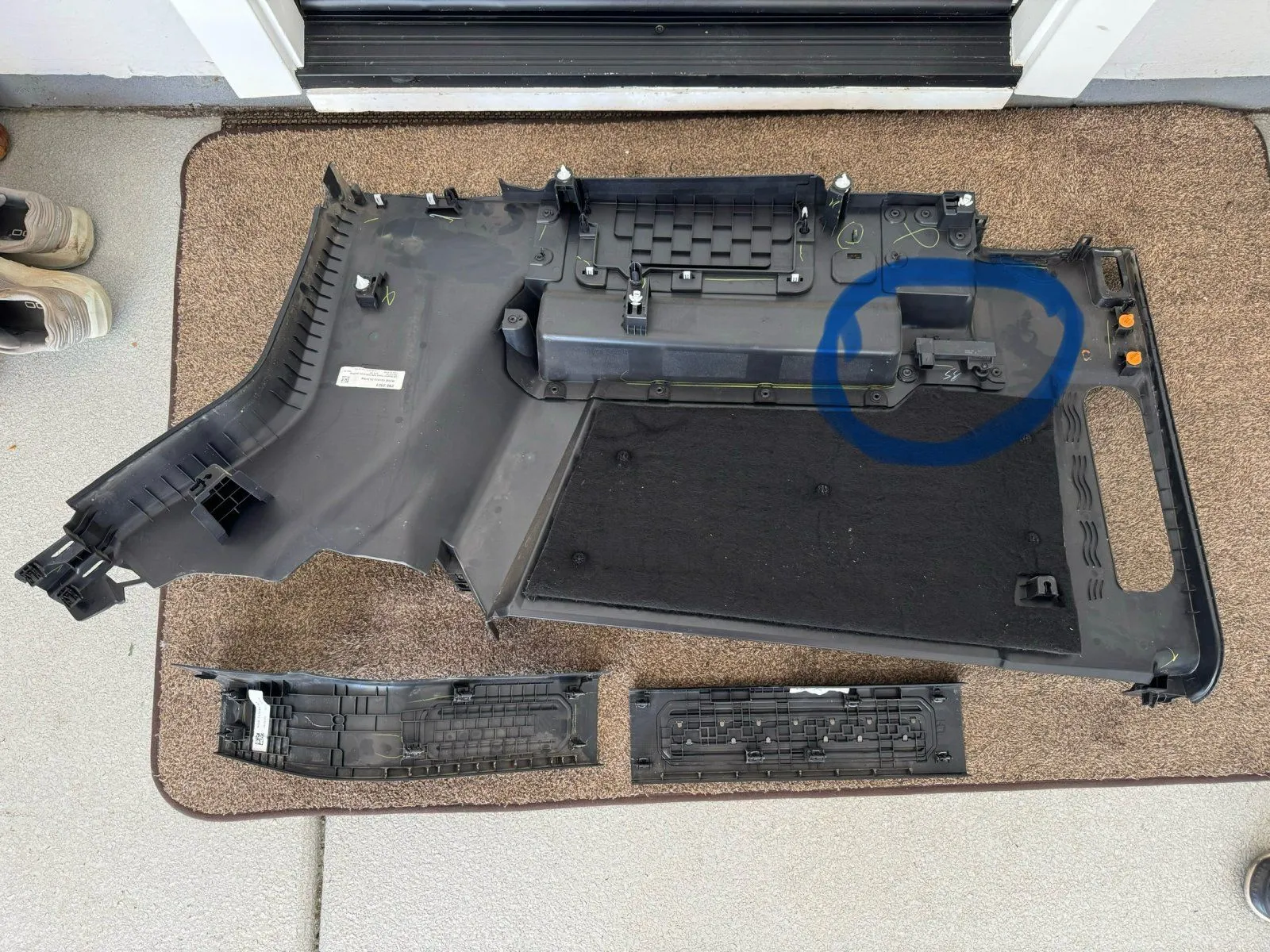

does anyone know what this harness and “device” (circled in pics) is for? This is drivers rear cargo trim panel. I forgot to check it out while doing my project. I was mostly surprised there was a harness to detach back there and then the need to make sure I plugged it back in before sealing it up (I did!). It would be like me to forget.
And we need a thread that shows the back of any panel pulled off so we can see what clips and harnesses are back there. So much easier to pull without breaking when you know what you’re dealing with!
View attachment 13839View attachment 13840
It seems I saw this in a YouTube video and they stated it was an antenna, maybe for the keyless entry.

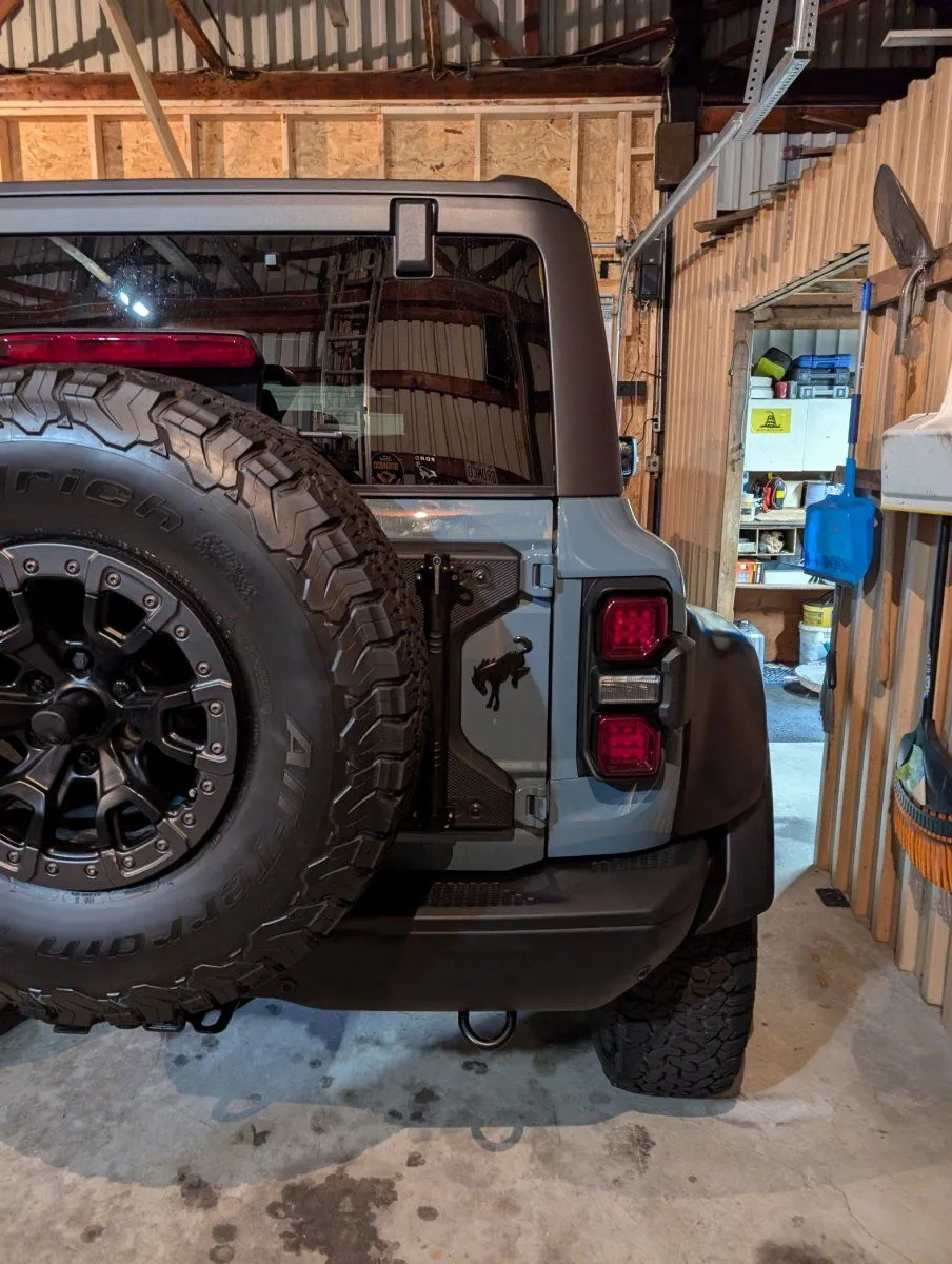

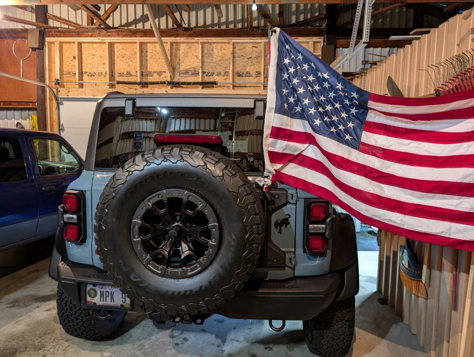

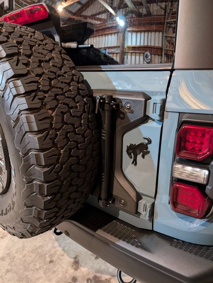

It Has worked out well, for a full-size flag or a whip flag attachment area also.
I have used it twice while off road and its sturdy!
