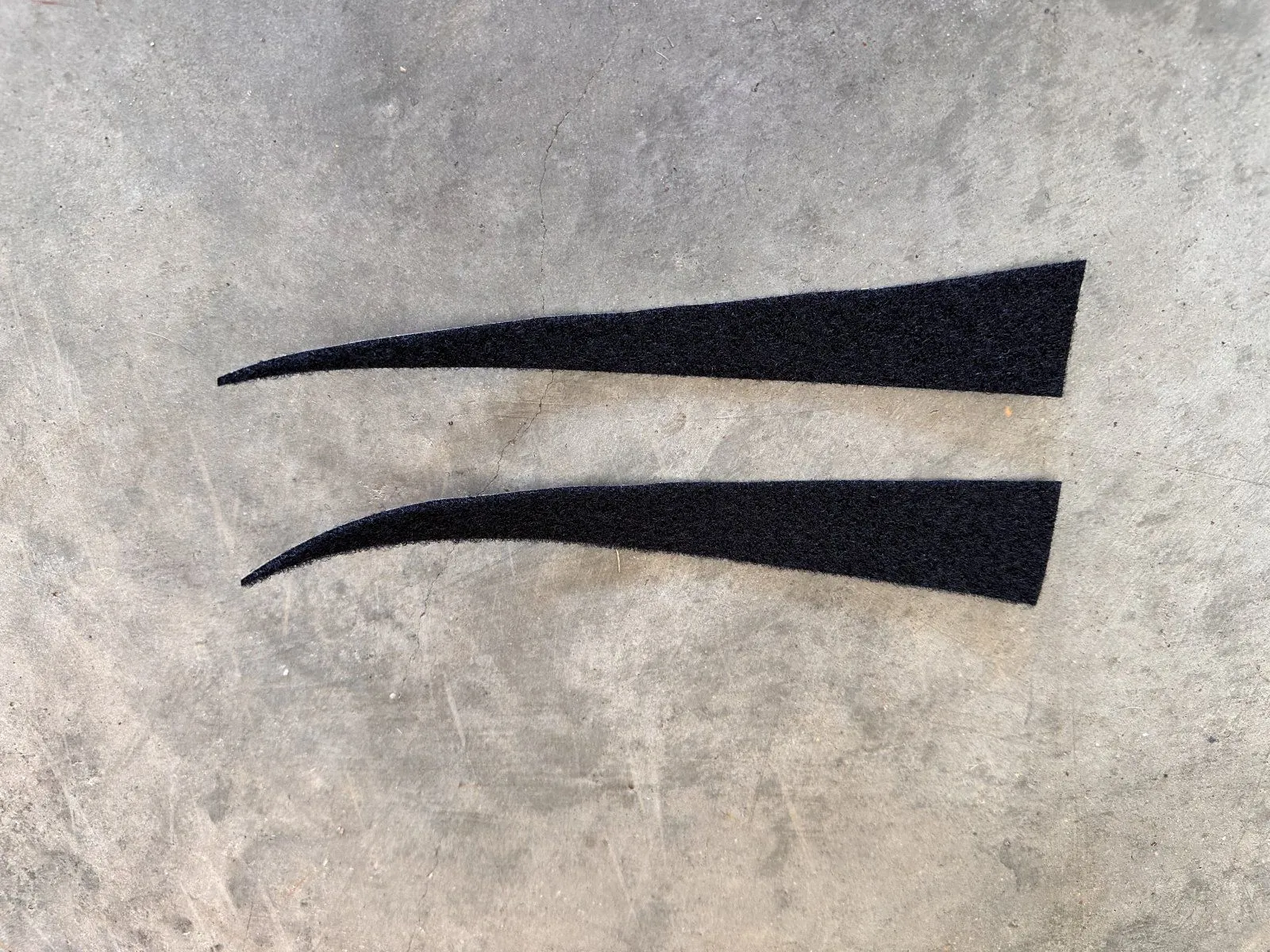

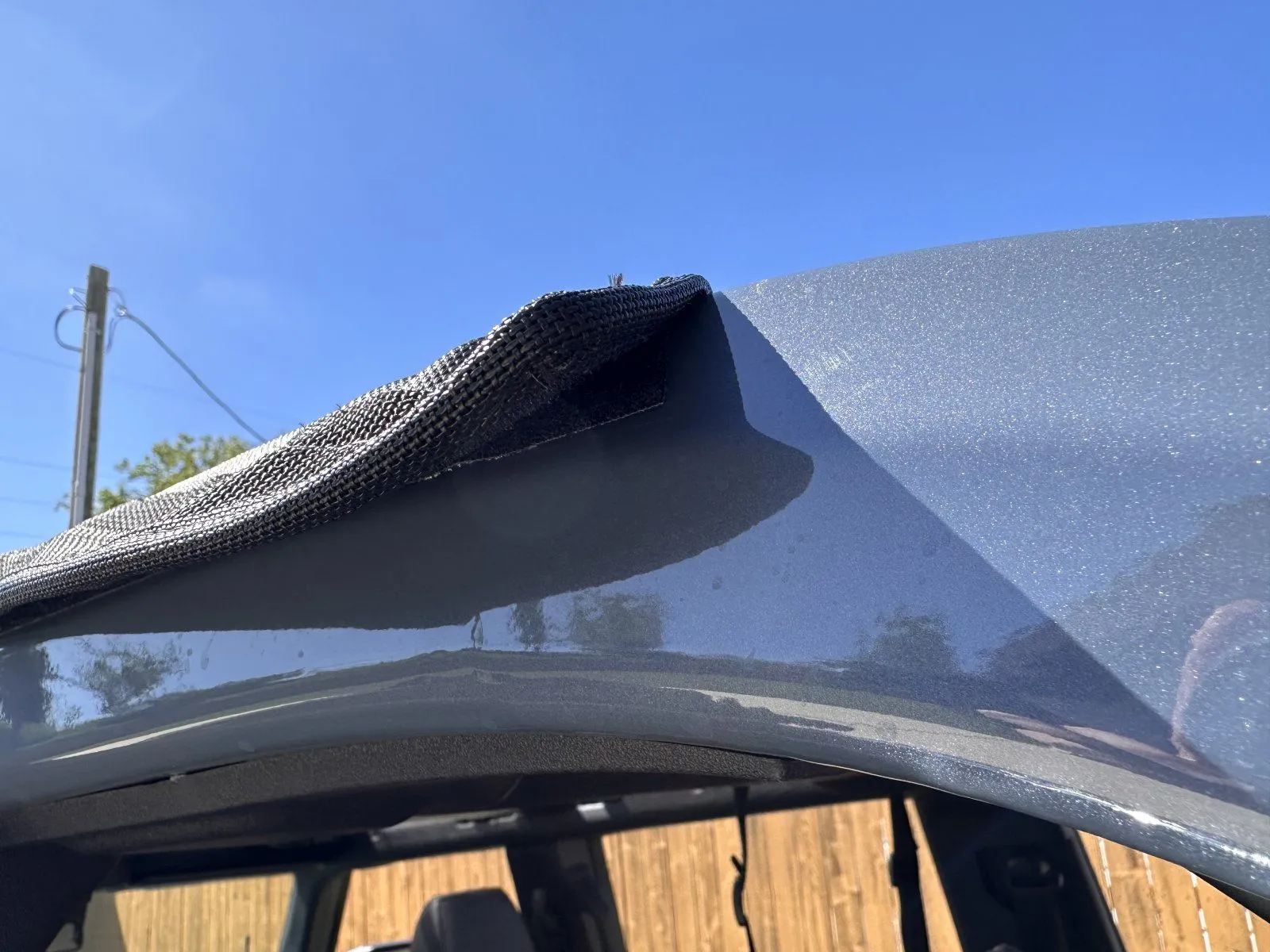

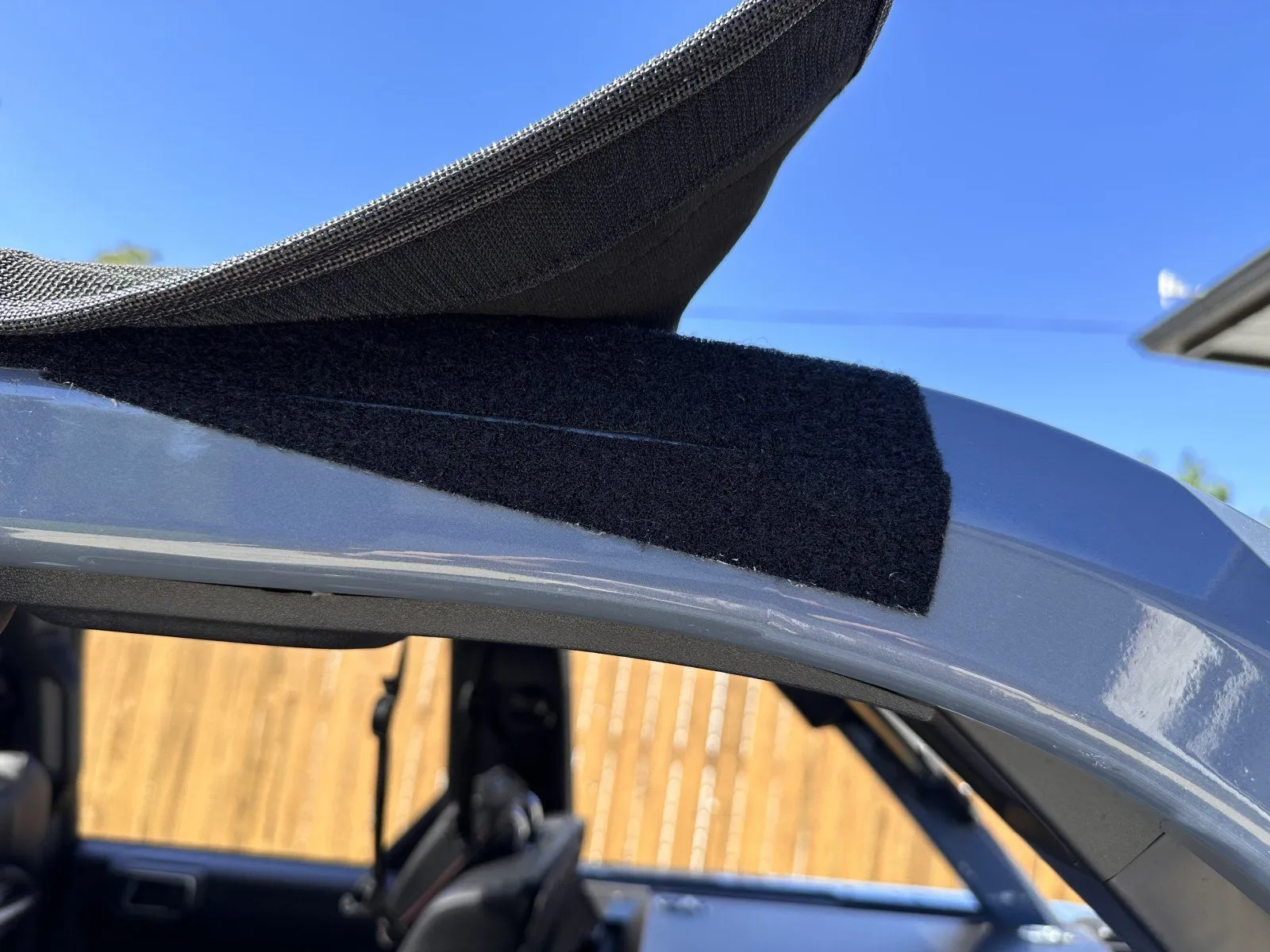

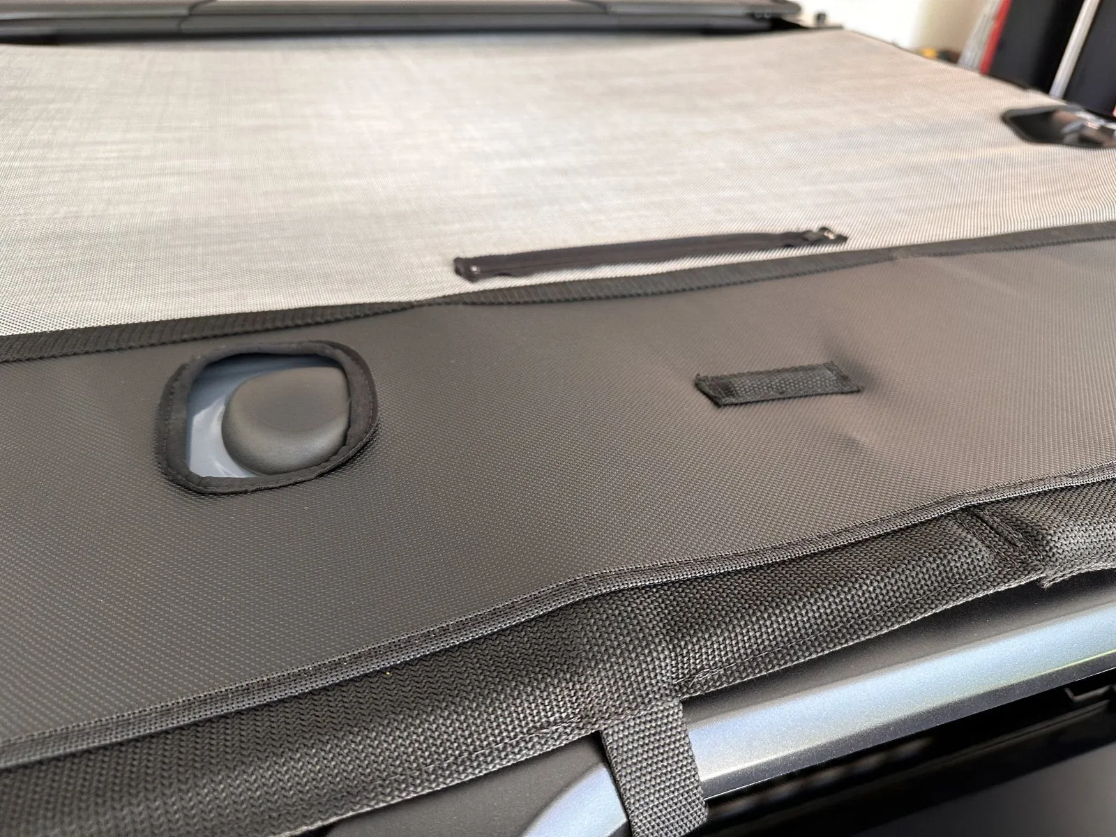

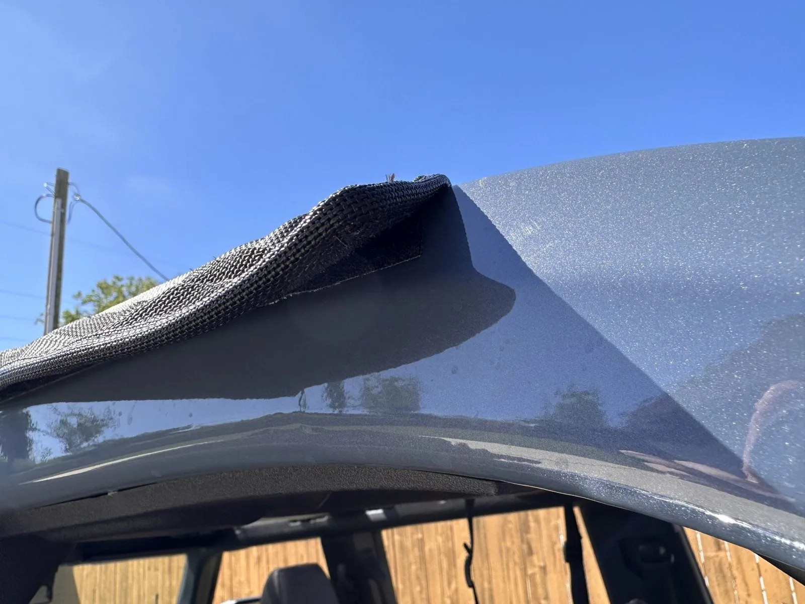

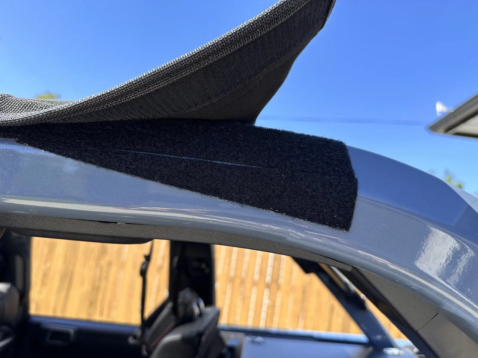

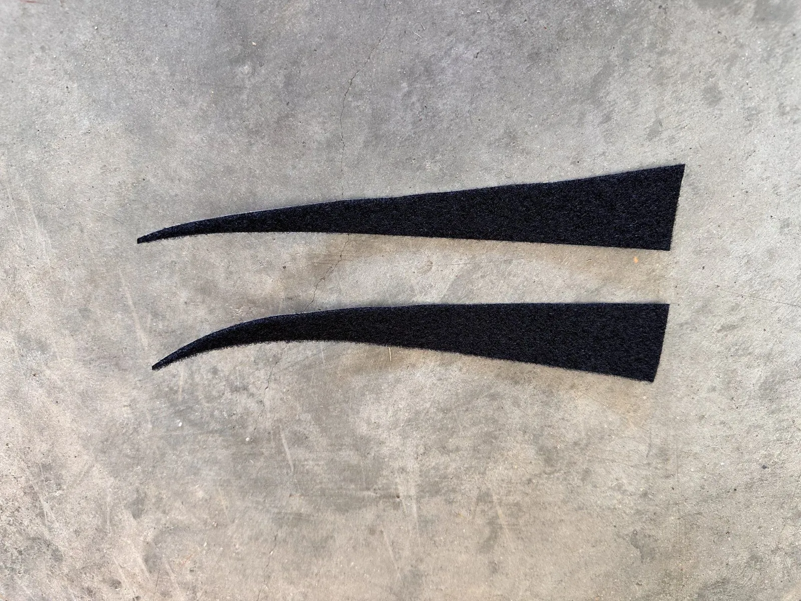

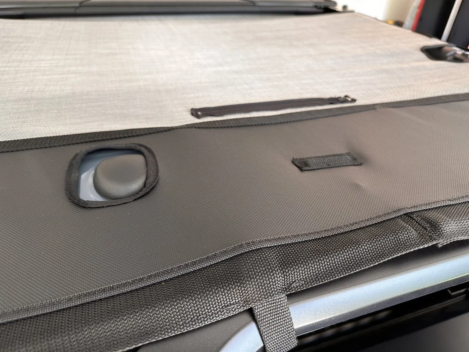

A couple of small clean-up items today. When I installed the Velcro straps for my JTops, I realized that the rear sections of the top weren’t quite overlapping with the Velcro. So I ordered a replacement kit from JTops and instead of removing the entire thing and installing a new strip I just cut a 9 in long section and then split into 2 triangular pieces and installed. Now should have full contact patch for that rear section.

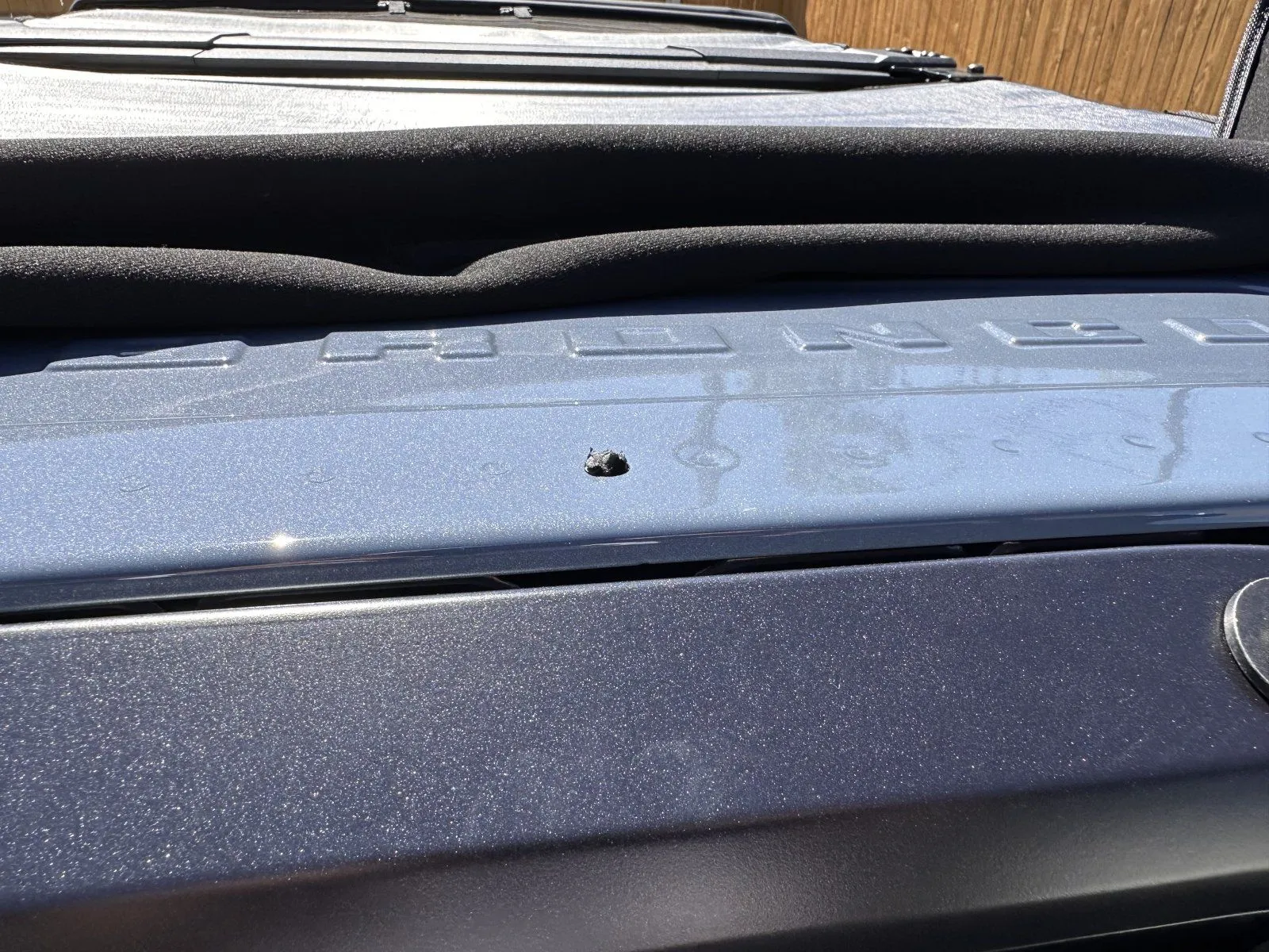

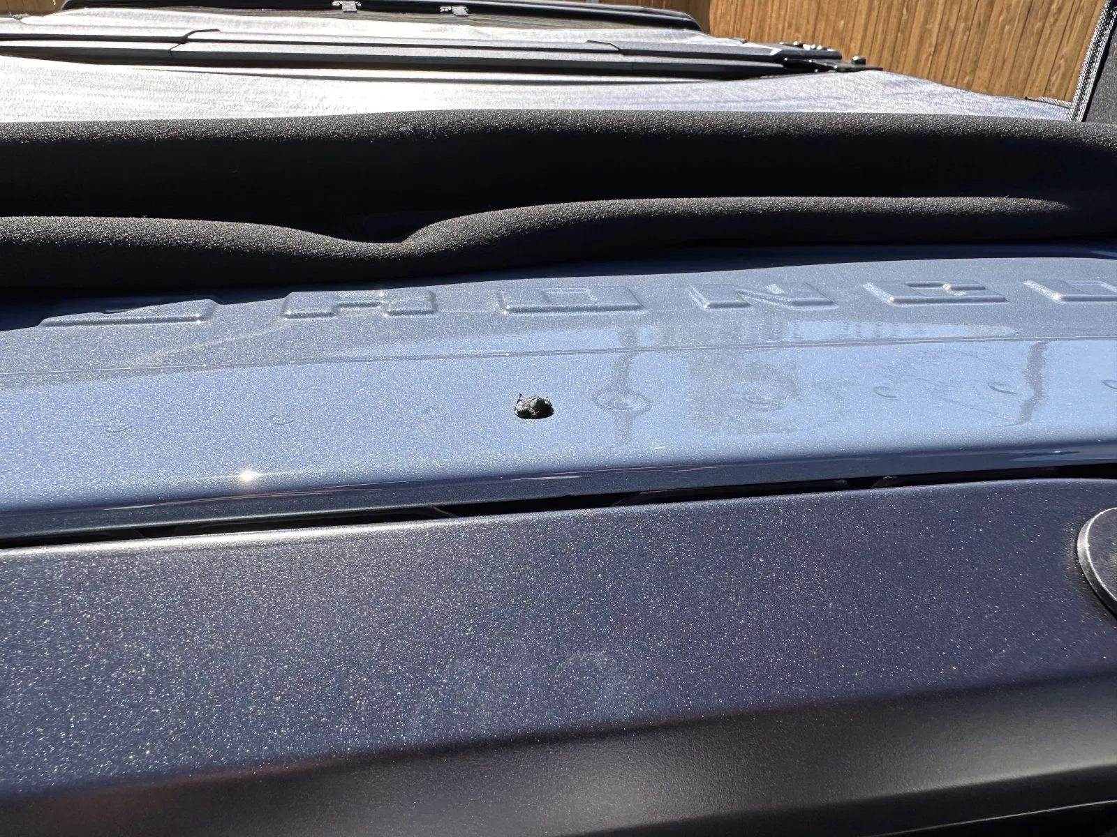

While I was at it I had noticed that there was a push-pin protruding through the c-pillar that was also pushing into the JTop vinyl. Concerned about an eventual tear I popped it out and trimmed it down a bit. Once the new Velcro sets overnight and I’m able to re-install I’m expecting that rubbing issue to be taken care of. I’m the second pic below you can barely see the point that I’m speaking of. That was before I had really tightened those straps down and it became more apparent after I got it as tight as I could.

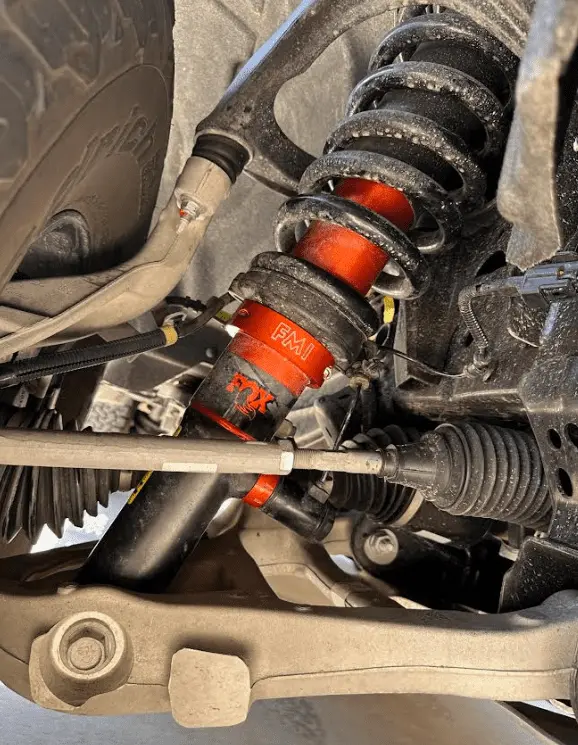

Monday brings more exciting action: Foutz Front Leveling Collars being installed. #itsthesmallthingsthatmakeadifference

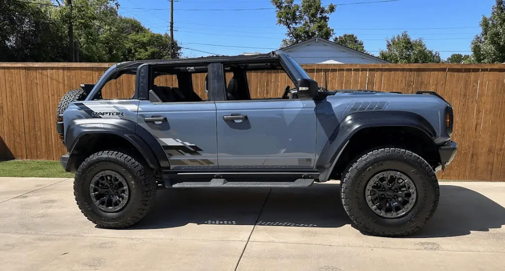

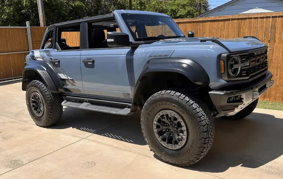

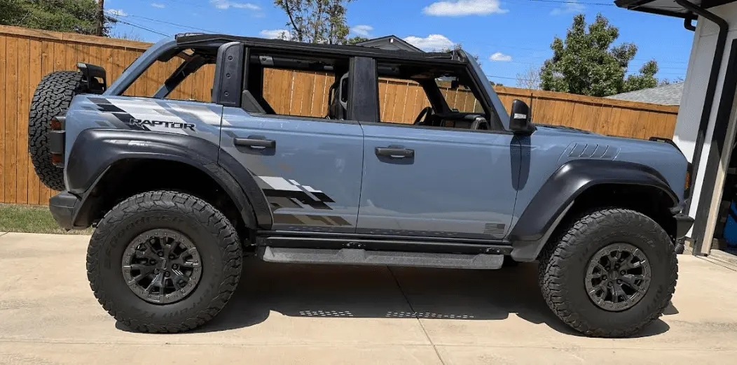

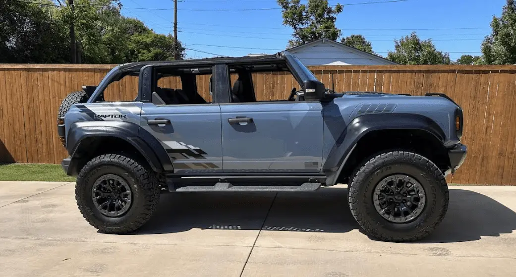

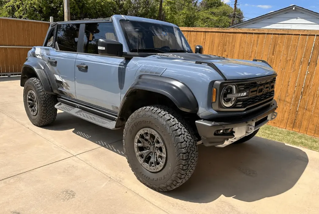

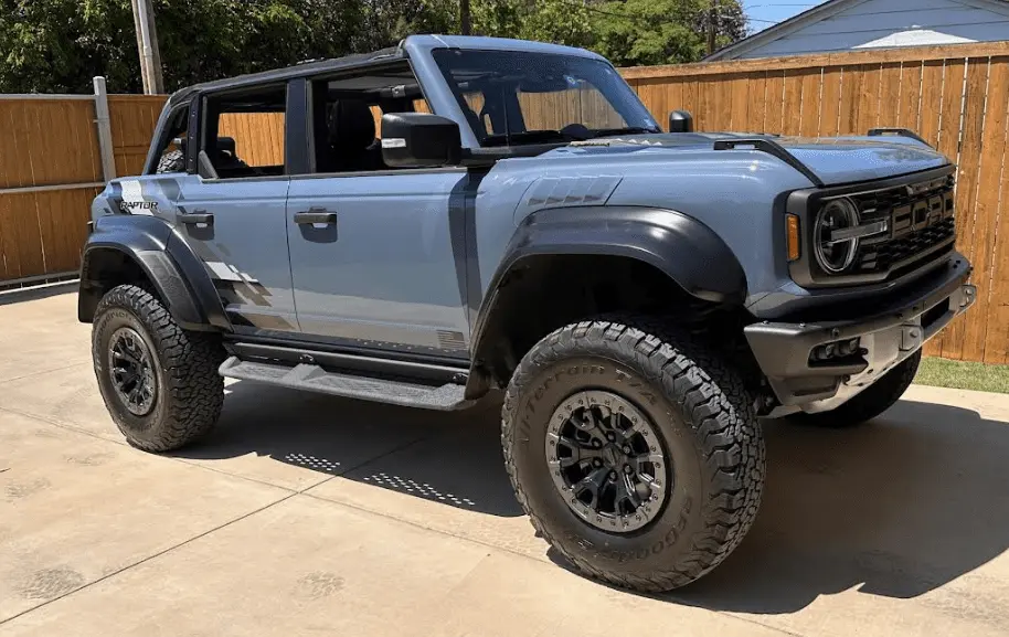

But as promised...I had the Foutz Leveling collars installed today: 1in collars on the front. Right now it's sitting a little high in the front as it needs to settle. But the gap from tire to wheel arch went from 7.25in to 9in with the 1in collar. The rear gap is right at 8.25in.
Before Side View:
After Side View:
Here's a before 3/4 view:
And here she is with the Leveling Kit:
Now I have another excuse to get her out and pound some rough terrain (pavement) to help it settle again...then probably adjust the headlights to not blind everyone.
Thanks for posting before and after picks! Let us know the measurements and driving impressions after it settles.
I was surprised by the dramatic initial change from rake to squat, hopefully that settles down nicely after you get it across some bumps, speed bumps if necessary.
Before Side View:
After Side View:

I’m installing the same Foutz 1” front collars this Saturday. I have to say, your ride def has a squat now and I’m a little concerned about installing…..would you please post again in a few days to see how much the front end settles. I’ve done many levels on trucks and I did the Bilstein 6100s on my previous Badlands, but this appears to be the most dramatic increase with just an advertised 1” I have seen.
At the same time, I wouldn’t mind doing a 1” rear if needed, but only running “true” 37s and currently my front end is just over an inch rake now. Thanks for posting!
Will do. I’ve driven it about 20 miles since picking it up this afternoon on a variety of roads but nothing real aggressive as I had my dog with me for some of it and later a stop at my local ‘beverage store’ to pick up stock for weekend golf trip (wasn’t risking breaking those bottles).
I wouldn’t say that I‘m not concerned about the squat, but I’d also say that the pictures slightly exaggerate the look. It’s almost imperceptible to the naked eye. I also checked with a level and only 1-2 degrees of squat right now. So on a scale of 1-10, my level of concern is a 2 simply because I prefer the ever so slight squat over the factory rake anyway AND I have full confidence that it will settle pretty easily. It’s only a 1“ collar so the squat is simply caused by the labor of the project and will come back, it’s just a question of how long given the limited driving I’ll be doing over the next few days.
Do you find yourself loosening the back straps to get the front clips off and on?

The pictures make it look like a 15 degree angle and that you rear is an inch or greater lower. Could you post new pictures? I think you scared a lot people :-)
