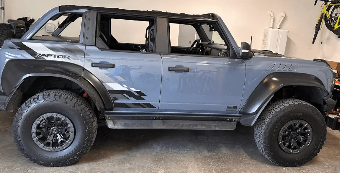

The pictures make it look like a 15 degree angle and that you rear is an inch or greater lower. Could you post new pictures? I think you scared a lot people :)
yep, my driveway is on a decent slope so a little misleading. I tried taking another picture in my garage as the aspect might be a little more realistic. I also placed a level on the top of the rollbar to show how close it currently is. Hopefully that helps with the look. Measuring the ground-to-fender at the front is 43.25 in and the rear is 43.0 in.

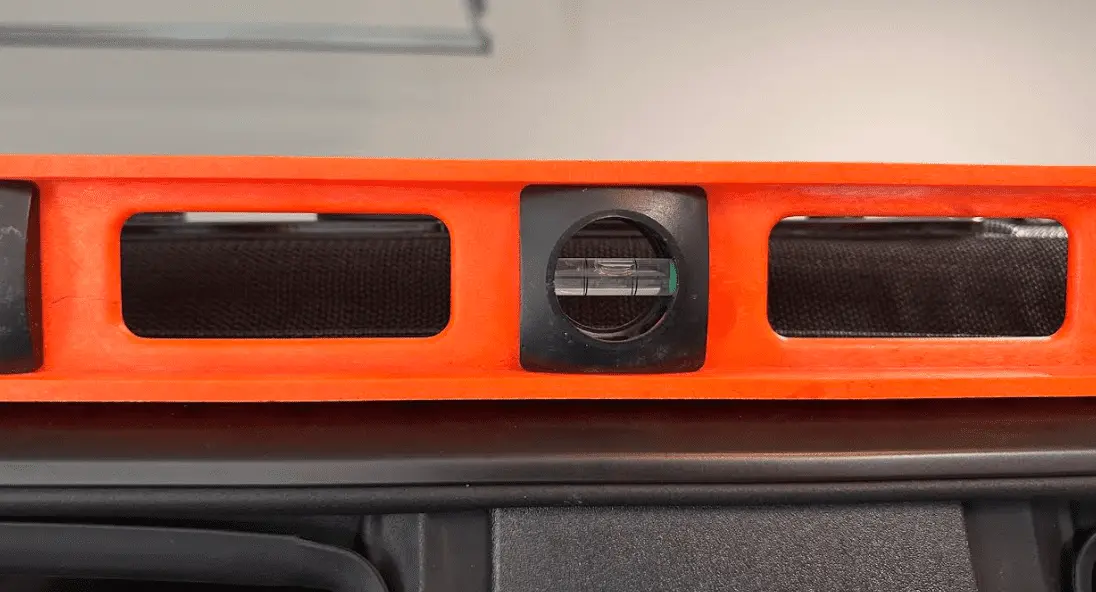

The best way to measure your rake would be to measure at the front of the rock rail and the rear.
Sometimes the simpliest solution is too simple to see.
The front end of the rock rail is measuring 1/2in taller than the rear end. I measured to the top edge as it allowed me to get my 24in level up against it and the front was 23.5 while the rear was 23.0.
Haven't driven it today but have a bunch of driving around town tomorrow so will be seeking out as many bumps as possible...which isn't hard to do around Dallas).
You are going to need a collar to level it out truly. By the time you go to your bumpers, I bet you are sagging 3/4 to 1 inch in the rear. I don't see the springs settling even a fraction of that amount. Have you called Foutz to get their input? Their measurements are using true height. I'm curious if you got the wrong set of collars on accident.

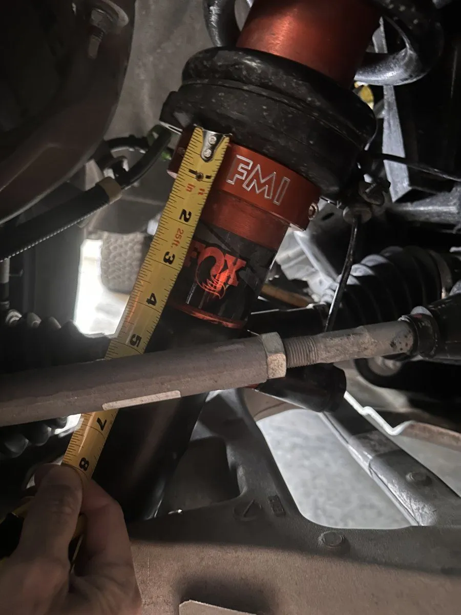

I measured the collars themselves and they are exactly 1in thick.
The remainder of the added lift is coming from the compression and/or having the shocks/springs removed for the work. I'm planning on giving it a couple of days of driving to see how it settles (if any).
So I know this is confusing, but the physical size of the collar does not reflect the lift increase. That is a 2 inch collar. I have the a set of 2 inch FMI collars sitting here right now. You need to call Foutz...
Turns out the offroad shop ordered/installed the 1.5in Level Kit which consists of a 1in collar that provides a 1.5in lift. It's an oversight on my part as I just wasn't paying that close attention when they sent the original quote...and TBH I'm not sure I would have caught it or known better anyway.
I talked to FMI real quick and it should settle a little bit but not the full 1/2in. I'm going to go with it for a while and see what I think. If anything I may end up moving these to the rear and having the 2in installed on the front but not spending another $600+ just to have these replaced (Parts, Labor + Alignment).
Small lesson learned for the rest of the group.
Your shop is not shooting you straight. That is the Foutz 2 inch lift collar. I just got my set in to replace my 1.5 rpg collars. My RPG 1.5 collars are significantly smaller then this one. Your shop f’ed up, you should be holding them responsible, but whatever it’s your ride.

You could be right, I just referenced the quote that lists 1.5in kit...could easily be the shop, could easily be Foutz shipping them the wrong part (even though they probably should have figured it was wrong).
I might stop by tomorrow to have them take a look. They usually use RPG but I only wanted front so they went with Foutz given RPG doesn't sell front-only.
Hey Dallas, I think M Braptor is correct and hope these pictures help make your case.
Pics are of the 1” lift front collars I ordered from Foutz directly. The collar is only 3/4” tall which should provide 1” lift total.
So shop def messed up or Foutz sent the wrong part. Hope this helps and good luck!
Yep, that’s the case. It turns out the shop ordered the 1.5” kit and I didn’t catch it beforehand…so it’s partially on me for not paying closer attention. I’ll go by and get their take on the best way to handle it and see if they’ll do me a solid if I move these to the rear and place 2.5” in the front or just replace them.
I could push harder but I preach (and bitch) every day about people being accountable for their actions and mistakes so would be a little hypocritical if I didn’t take some responsibility for reviewing the parts ordered much less asking.
Quick update...I decided to put the 1" lift on the rear. This will get the entire truck back to level with maybe a little rake but since the rear setup is so soft it will work just fine. Stopped by the shop this morning and we connected on the gap in communication. They're going to do me a solid and help out with the labor costs.
So I'm going to look at this as a relative good problem to get solved as I'll effectively have 1" lift all around with the front being at worst 0.5" lower than rear as opposed to the original 1.25".
Should be done in a couple of weeks.

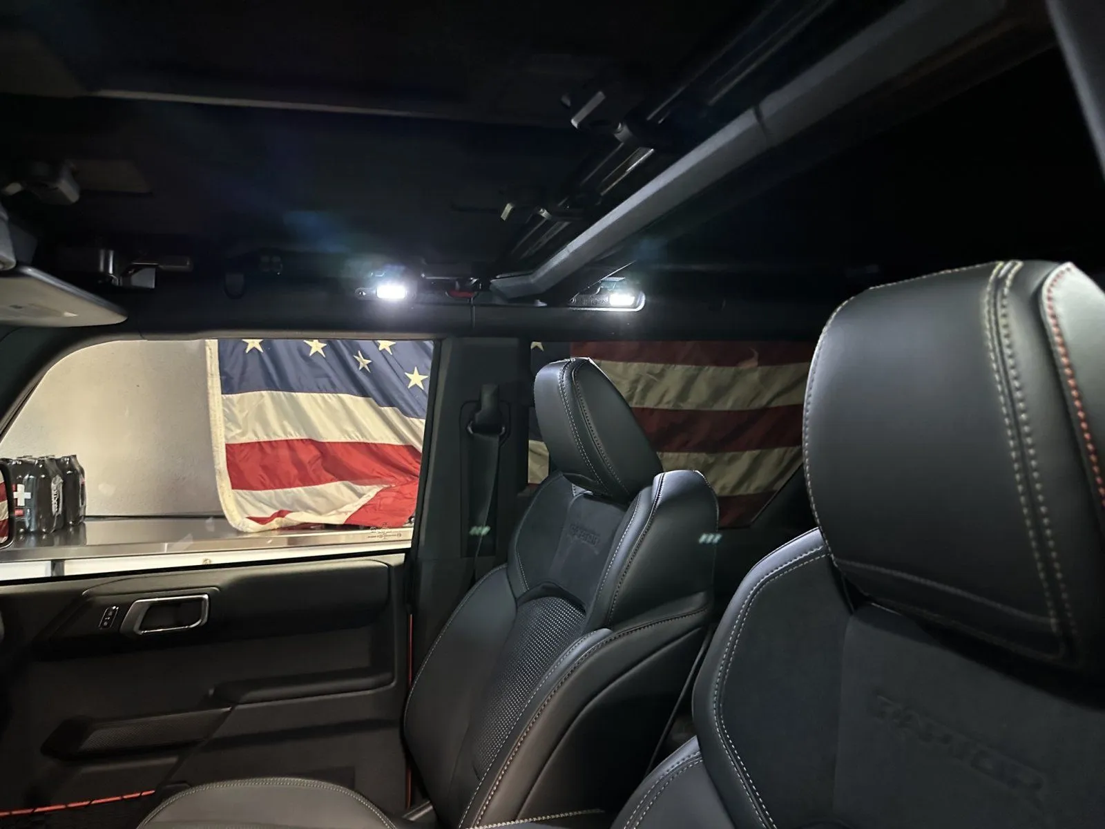

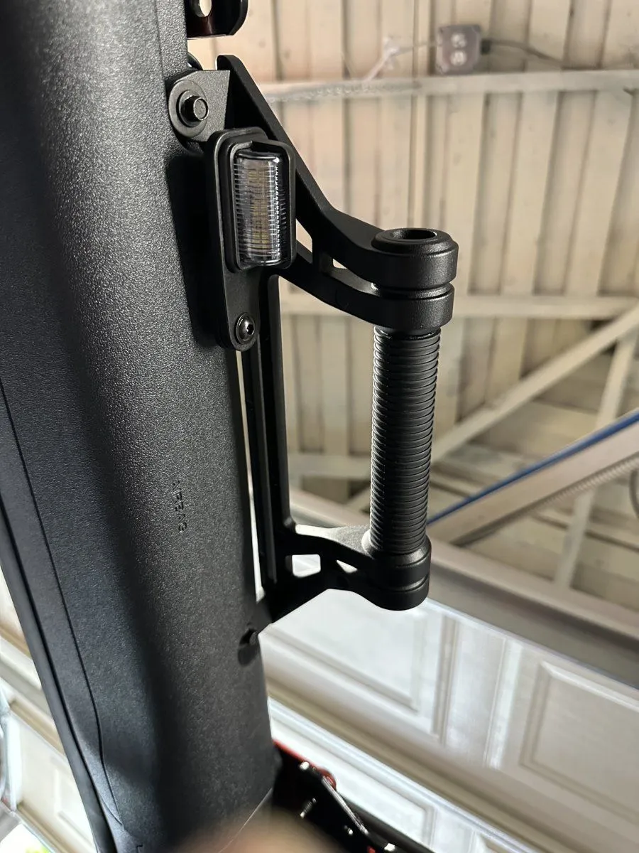

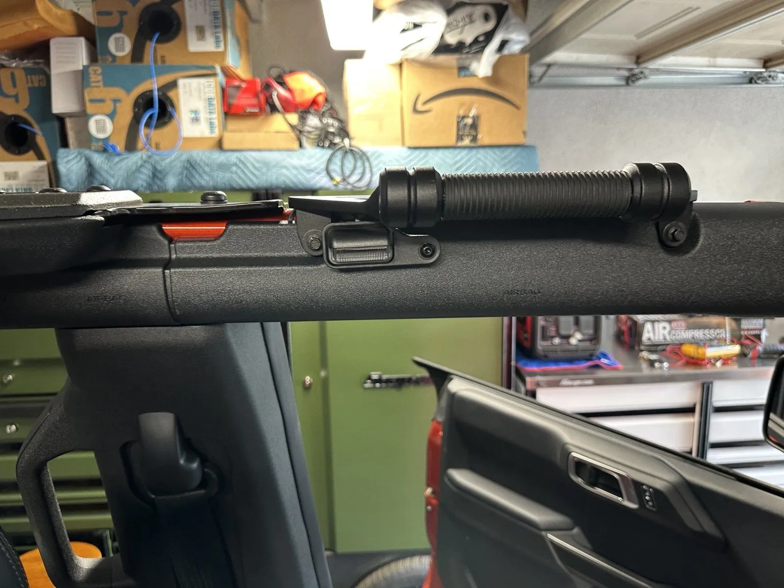

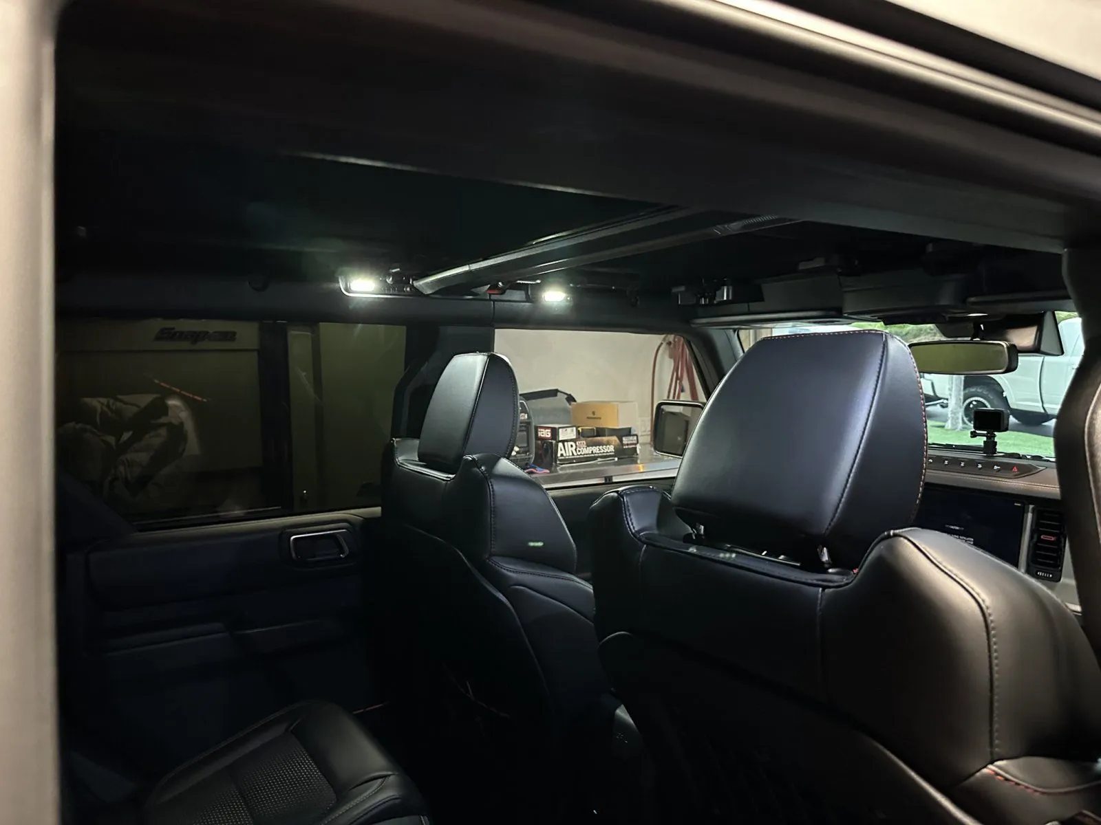

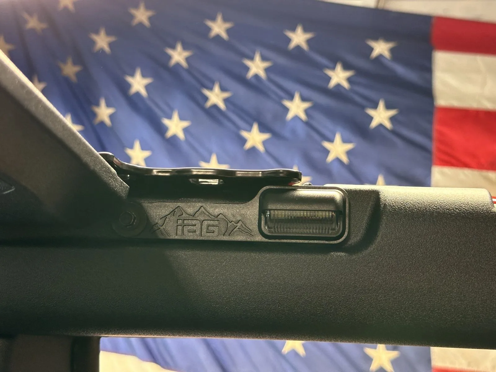

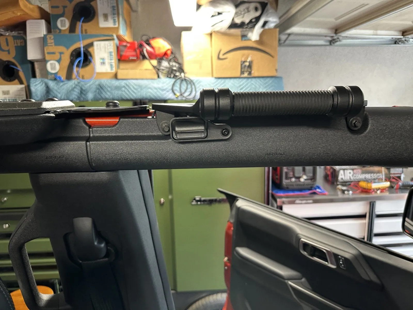

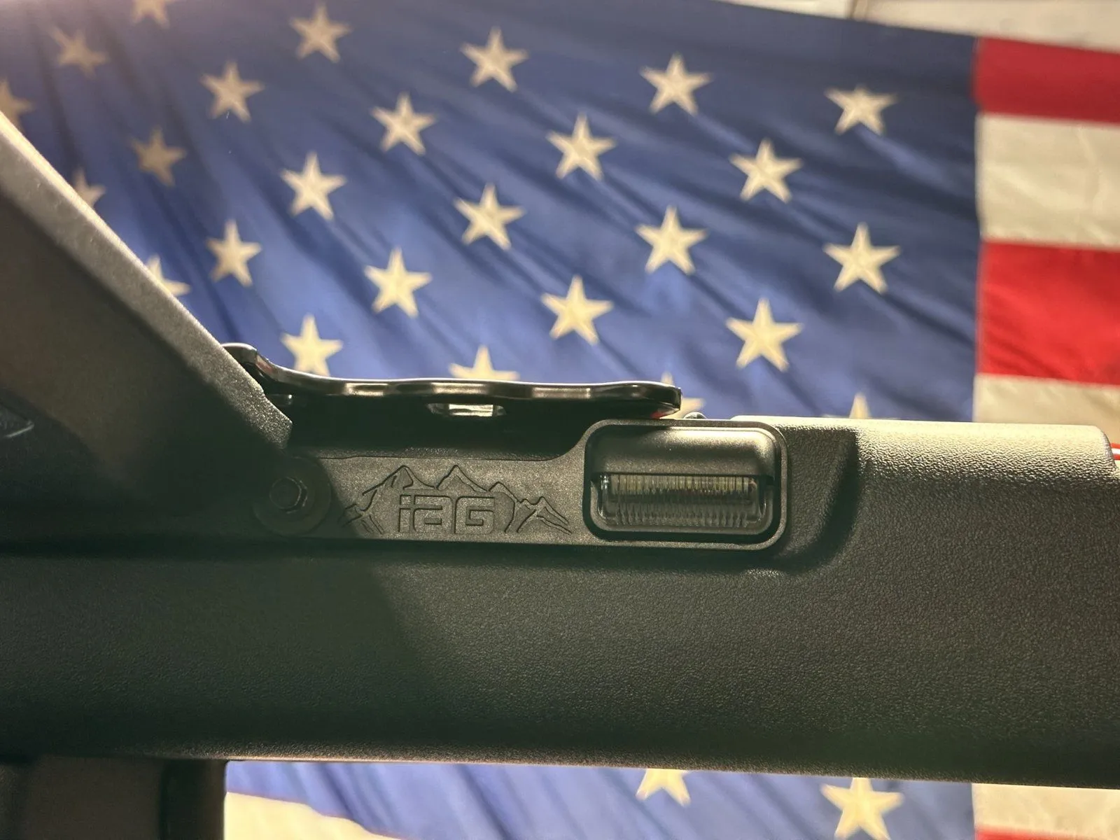

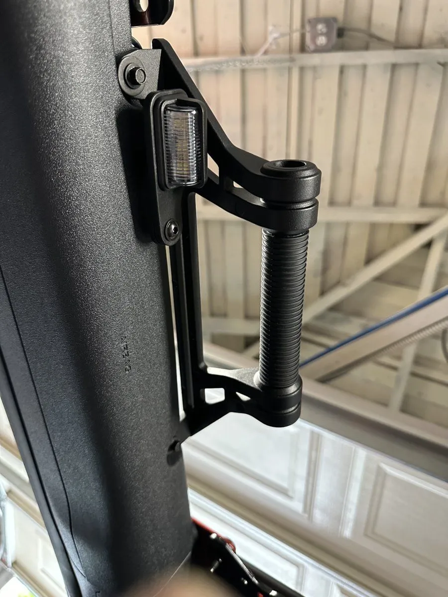

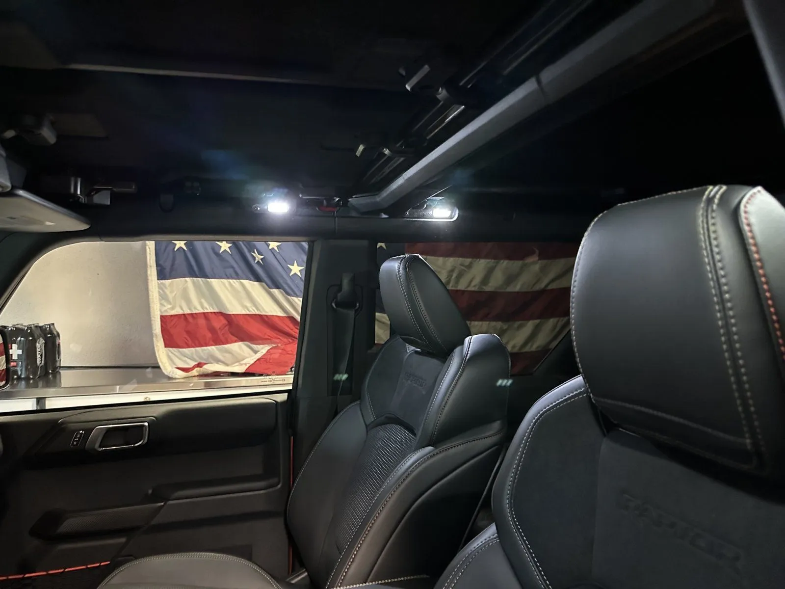

Well just sharing with everyone what I got done today on my BR... The Interior lights were definitely a great add on. Very simple install too! I also added the Seven Sparta Aluminum Alloy Roll Bar Grab Handles also a great add on! Something inexpensive and great upgrade! Am I the only one here who feels these after market companies are charging a ton for the Accessories??? $500 bracket to mount an air compressor? Just saying... I have a ton of parts to install so this is just the beginning... Enough talk here are some pics... All of the lights are straight now... :)
View attachment 8050View attachment 8051View attachment 8052View attachment 8053
Well done! Your off to a good start, lights and handles look great. I agree some of the nicer add-ons are over priced, seems that way with Bronco parts in general since they are still relatively new compared to Wranglers. Supply & Demand.

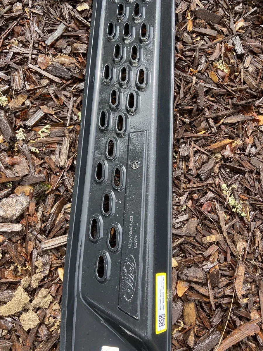

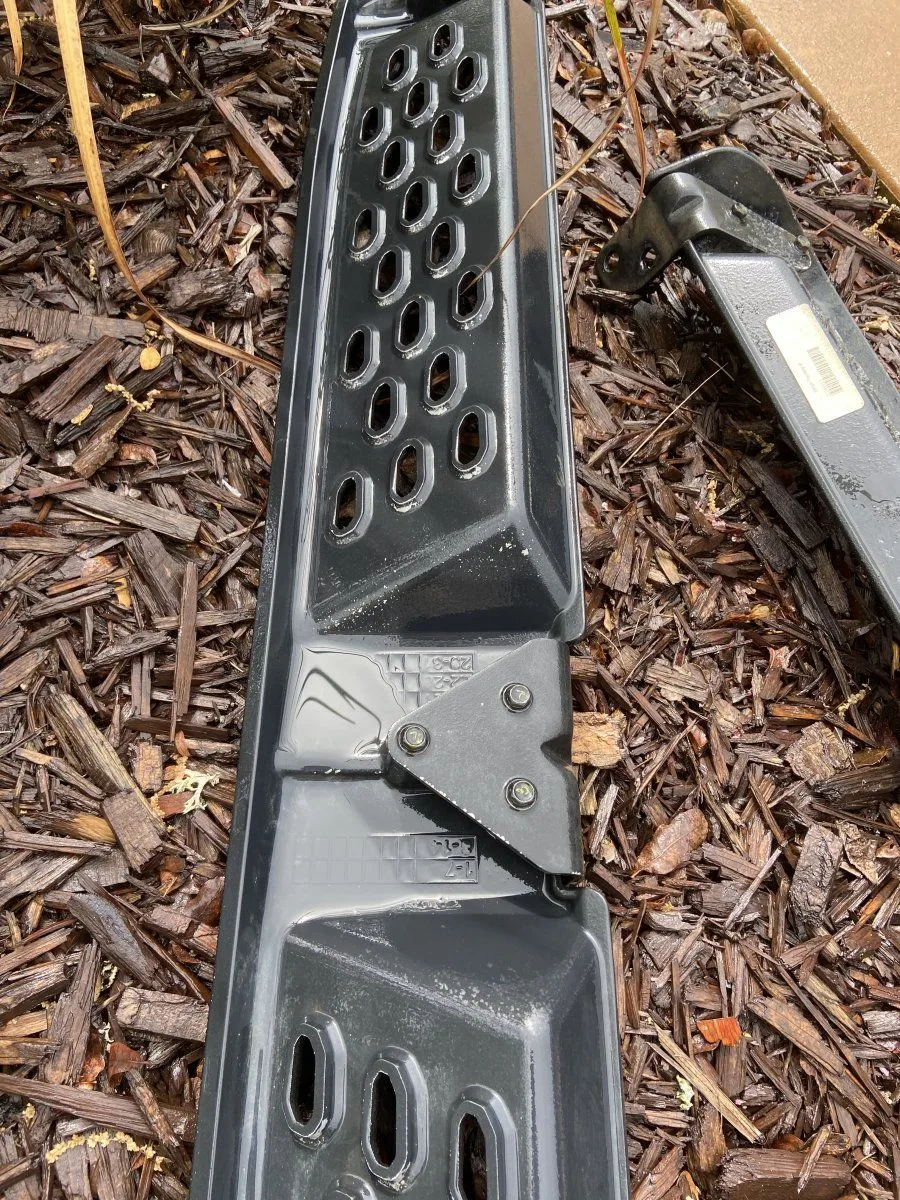

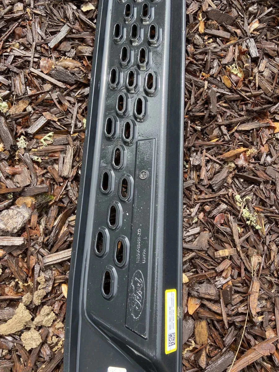

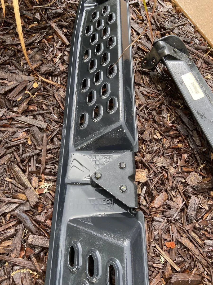

Prepping to take the neighbors kids to the local OHV park (Prairie City) tomorrow, I removed my sidesteps. Done this many times, but I decided to clean the mud from off-roading yesterday and noticed how many rock strikes (chips) these babies take. No surprises, but in case you’re interested in what 5000 total miles (maybe 400+ in Mojave and local trails) looks like…..
Note: I typically remove them when crawling on some rocks, so no major trail tattoos). This is all just spray from the tires…
frankly, it doesn’t look so bad, but I’m glad I have ppf for when I don’t have them on!
frankly, it doesn’t look so bad, but I’m glad I have ppf for when I don’t have them on!View attachment 8084View attachment 8085
