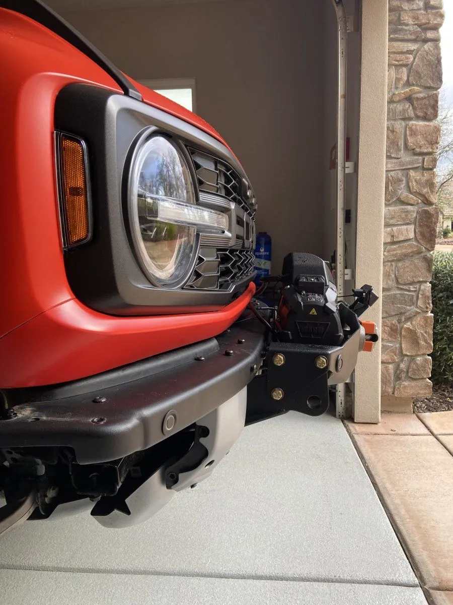

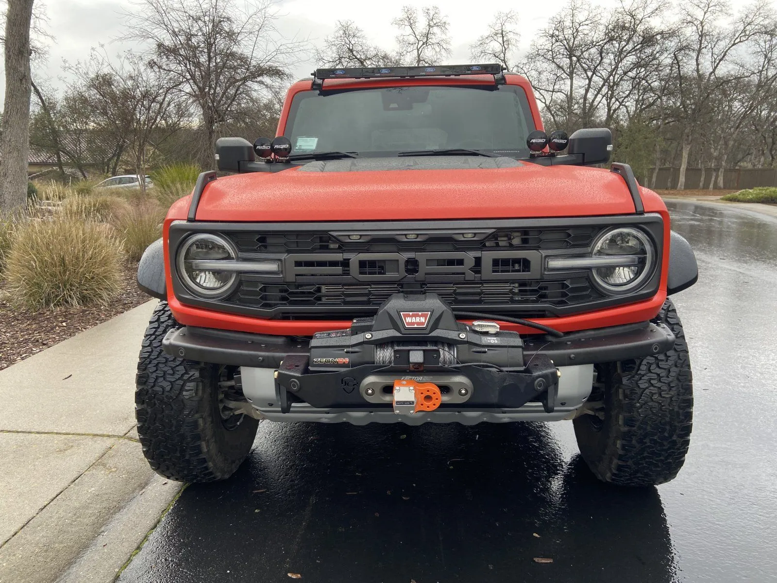

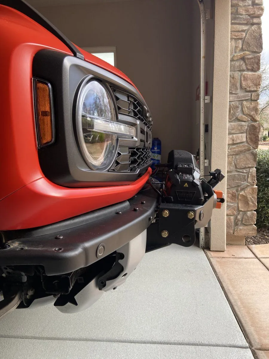

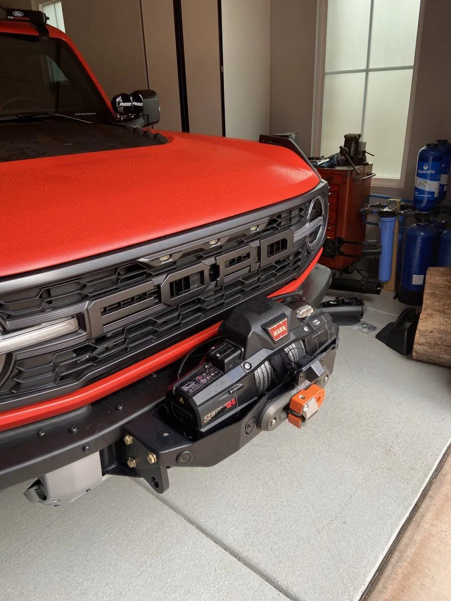

Today on the season finale (probably not actually) of “What Did With Do WithYour Bronco Raptor Today?” Randy completes his winch project.
The mounting, reassemble and spooling went pretty smoothly, but I forgot to put the silver plastic front cover on before mounting the winch plate, winch and cable routing. Other Broncos have two separate panels that mount on each side of the tow points, while the Raptor‘s single piece loops over the top. Fortunately, after suffering an oh sh*t moment or two, I realized I could just unbolt the six bolts on the winch plate, lift the assembly and slip the cover in. Crisis averted.
and there were a few choice words threading rope and inserting the puck in the winch. Hated that each time I’ve done it.
But it’s all done with minimal drama, it works (always a bonus) and I only have a little bit of cable / sprayer hose management left to do.

That turned out great! I think you might be one of the first Bronco Raptors with a winch on it. That front camera is now truly front and center!

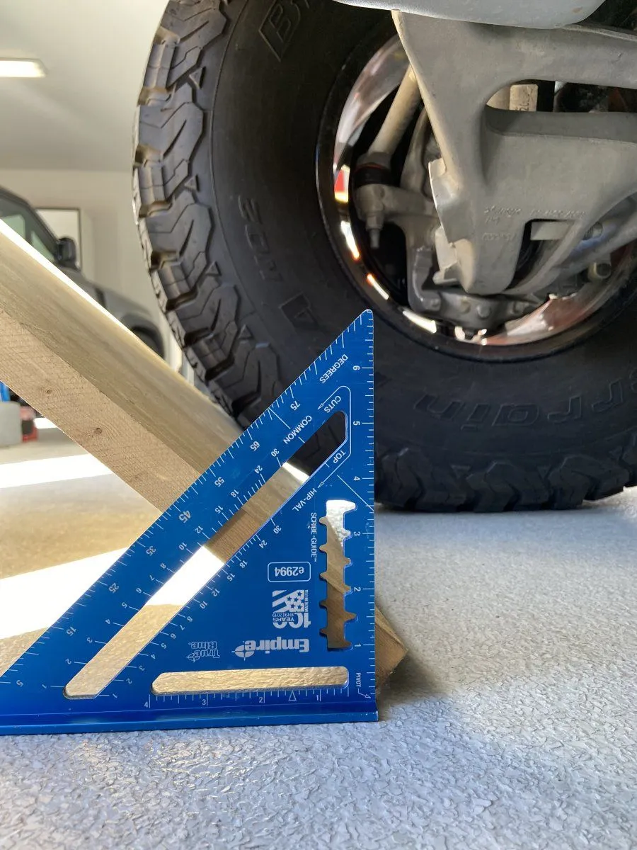

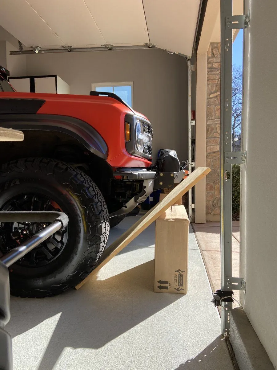

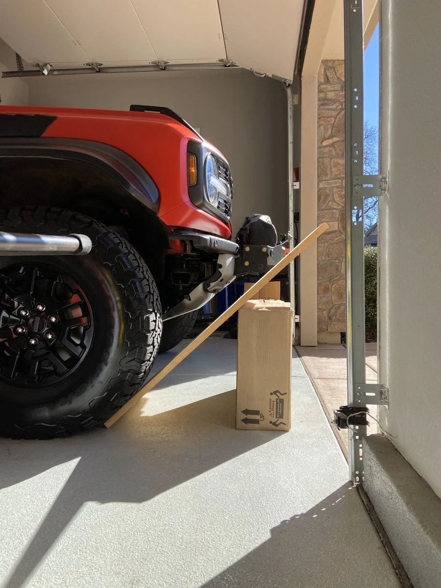

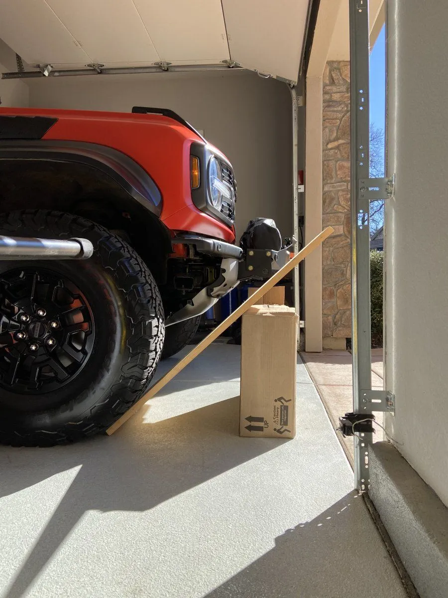

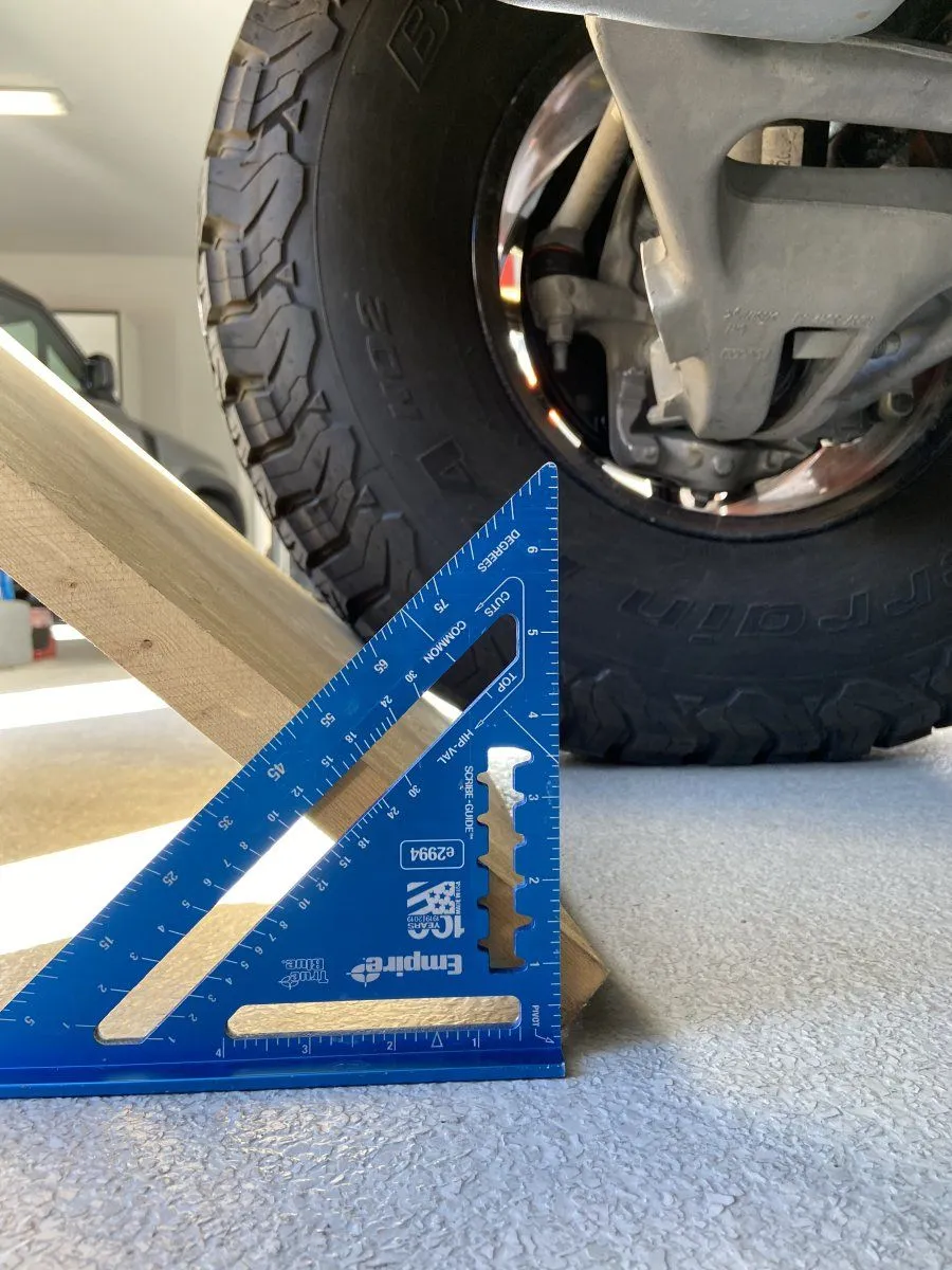

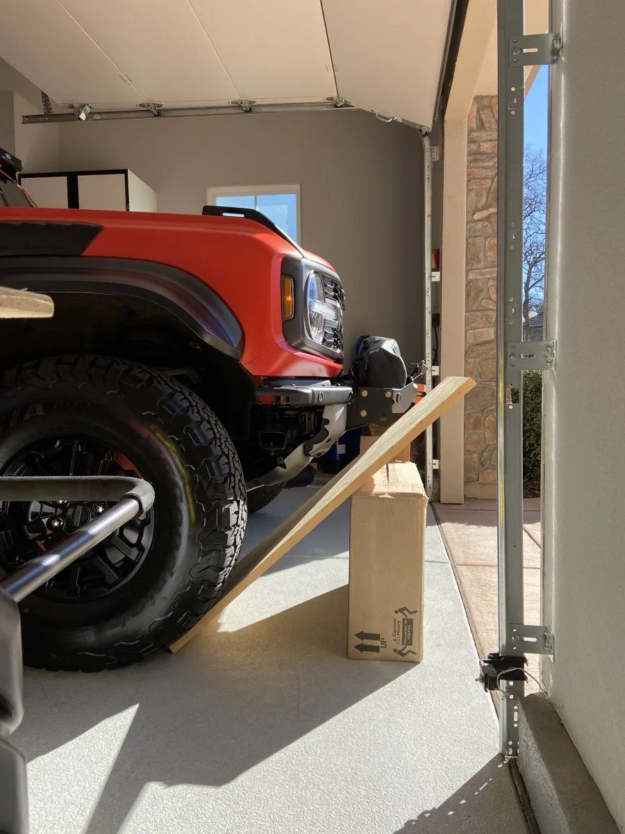

I should have done a check before and after on approach angle using my highly flawed method pictured below. While it still wouldn’t be accurate at least it would be consistently measured inaccurately!
I think the. OEM approach angle is 47 degrees I’d put this around 43 degres +/- some margin of error.
Actually mines probably even a little less if I fully factored in my flatlink and rope guard.
Hope that helps in some way.

Yes that's very informative. Actually I would have expected more impact - 42-43 degrees is still really good.

If there is a need to restore the approach angle close to factory, a front leveling kit may do the trick... or larger tires. :cool:

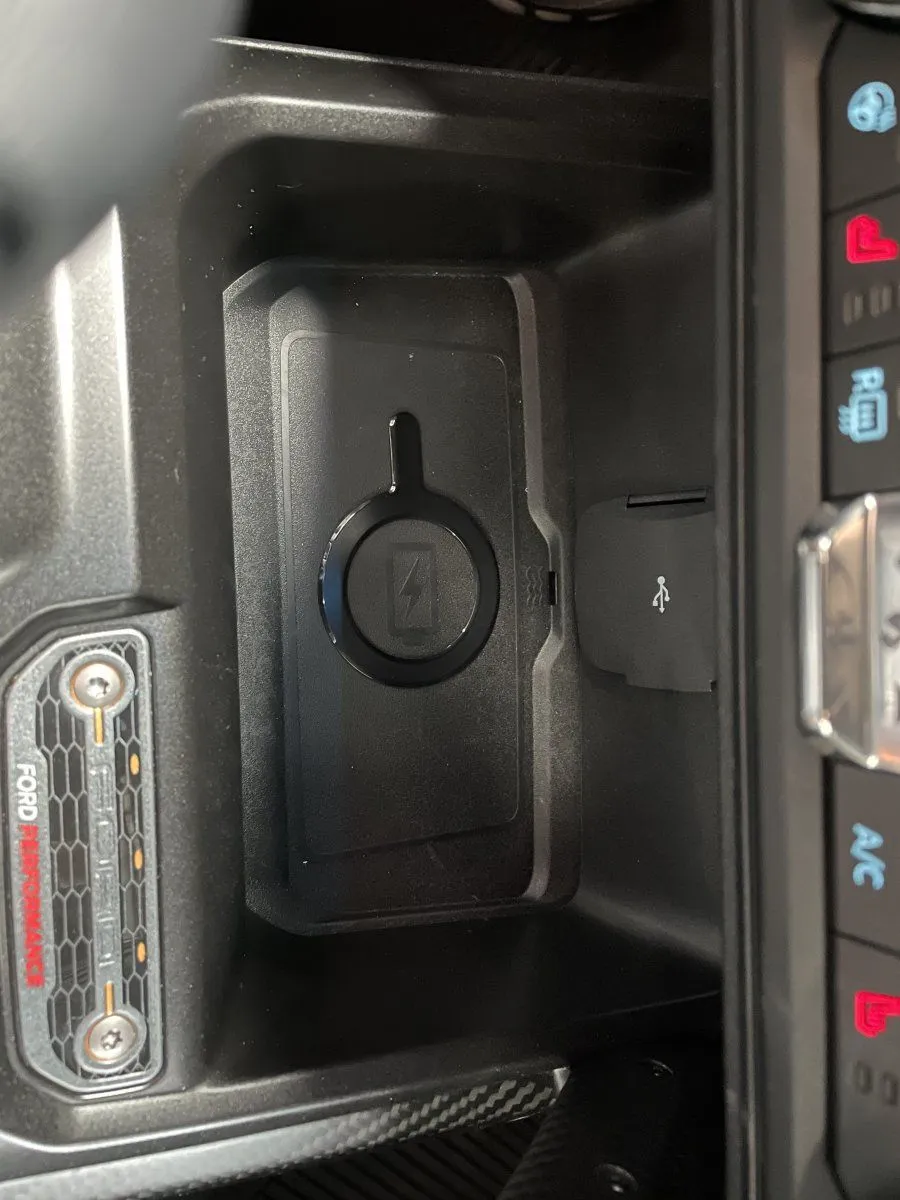

I used a plug tap I got off Amazon and mounted my Valentine One radar detector using the directions found here:
Here's the link to the mirror tap I used: https://www.amazon.com/dp/B082V1245P?tag=braptor-20
Let us know the verdict.
Definitely better than without, but still not perfect. A good jolt can still knock it off the magnet…😏
