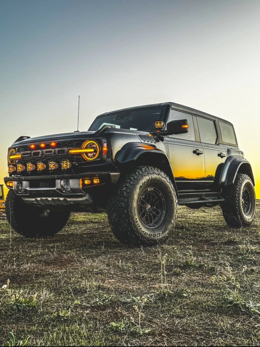

Thanks for sharing this approach. Will you be using the chase light as a 3rd brake as well and removing the obstructive factory 3rd?
Unfortunately no. The back light really isn’t bright enough to serve as a brake light. The only thing I’ve seen is the Rigid chase pod light that does it all, brake, tail, reverse, chase and courtesy light in one package. Even has a Bronco bracket, just not a Raptor bracket.

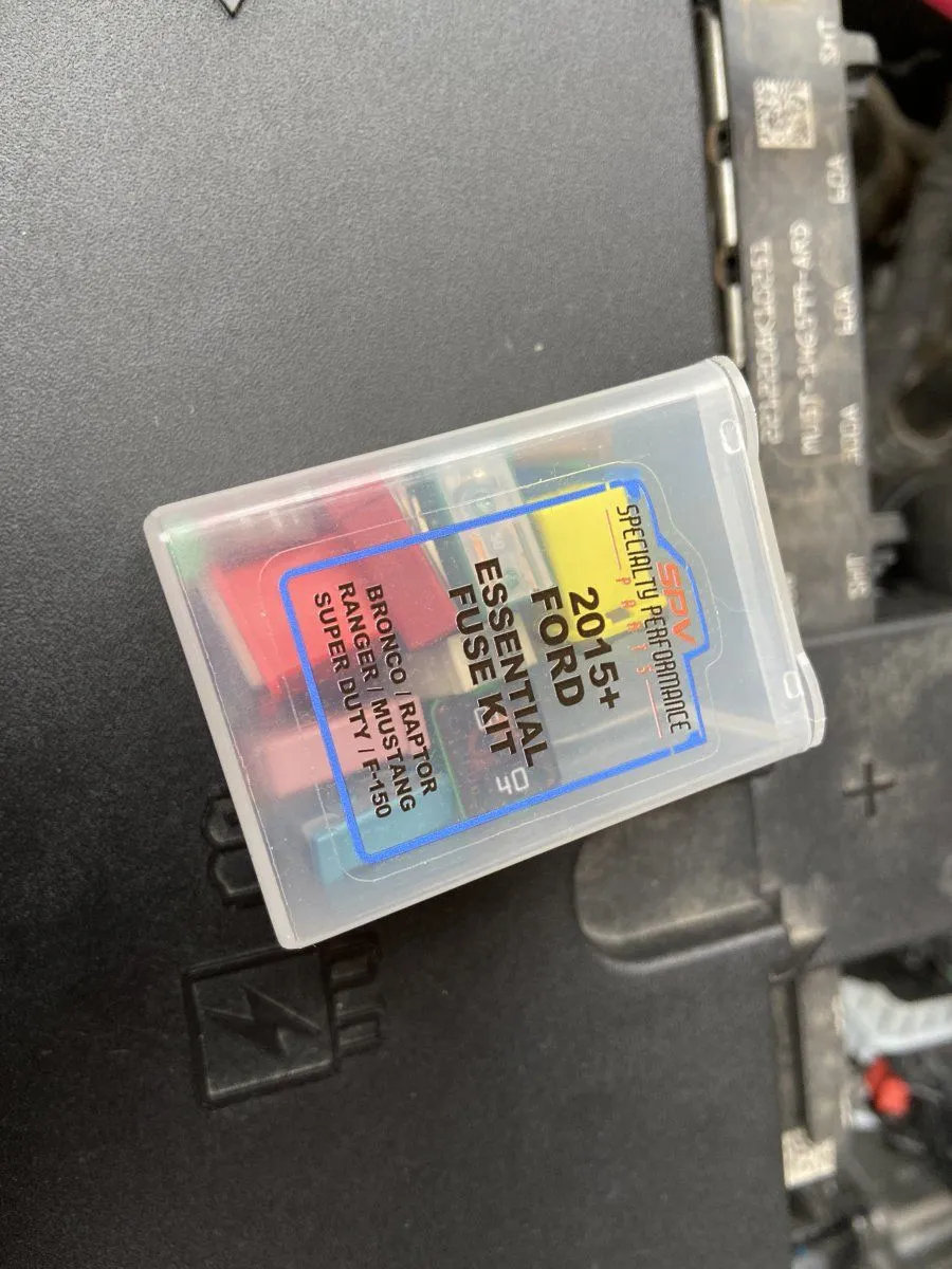

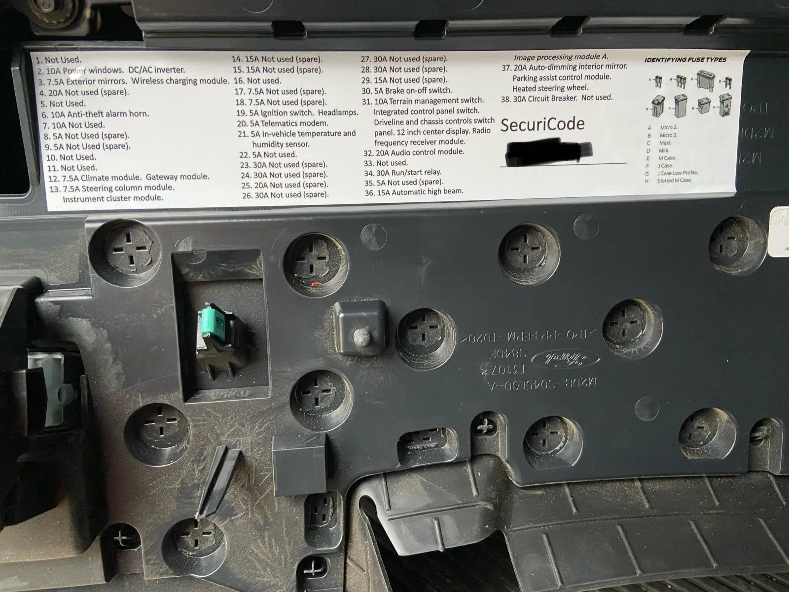

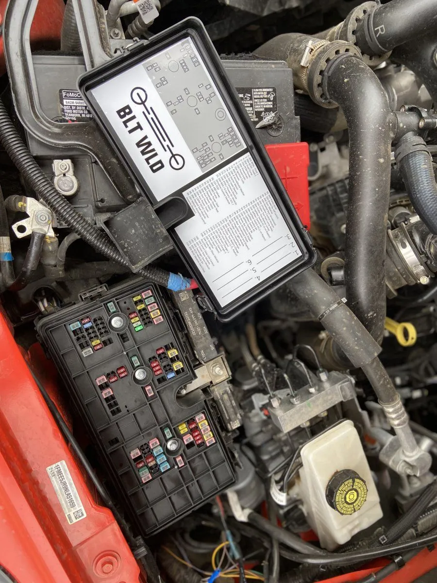

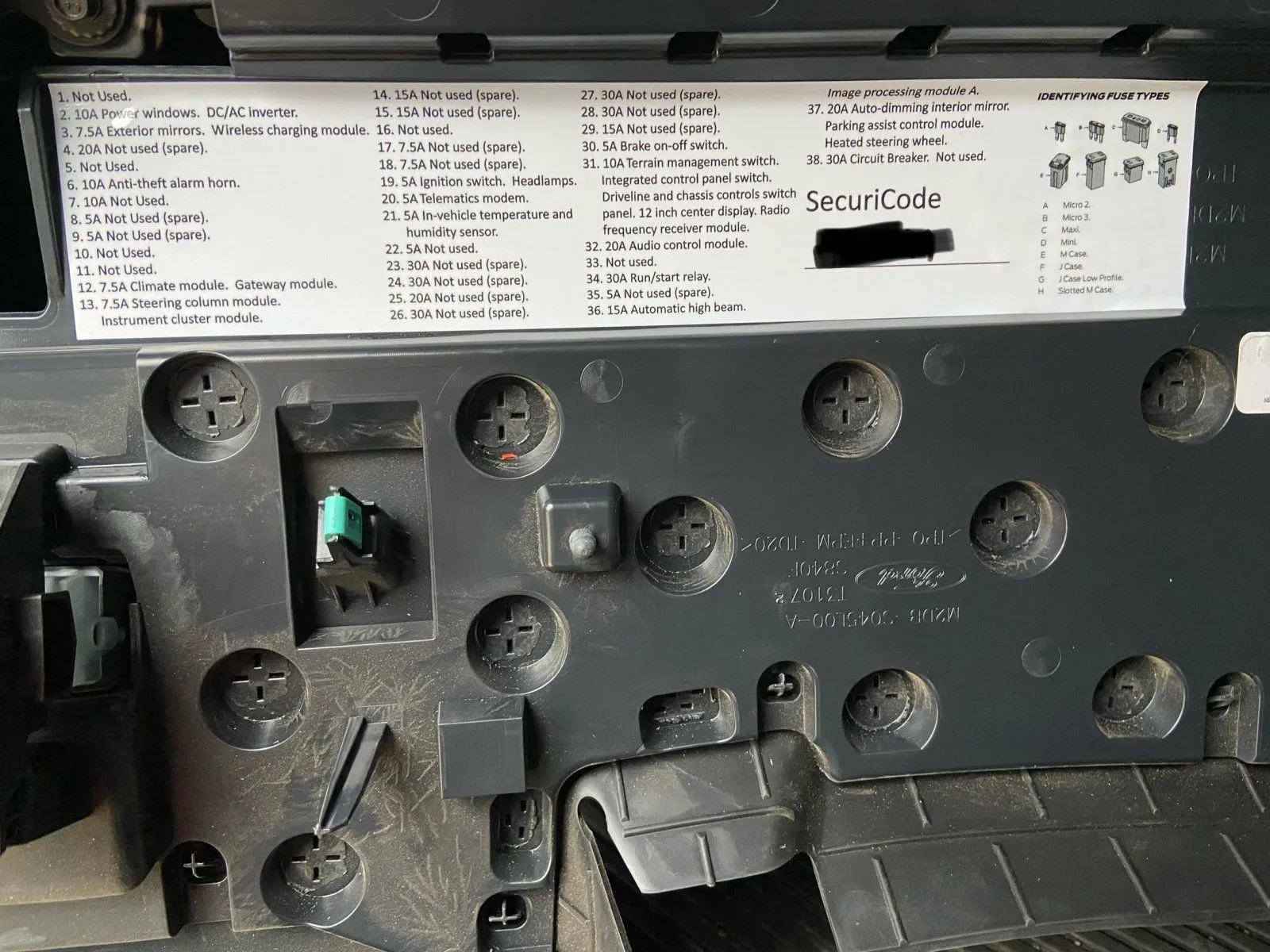

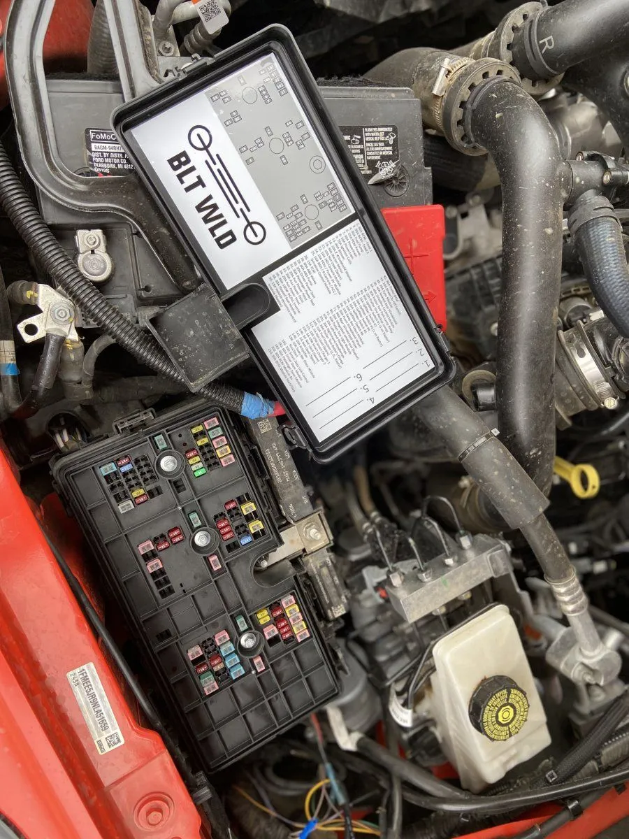

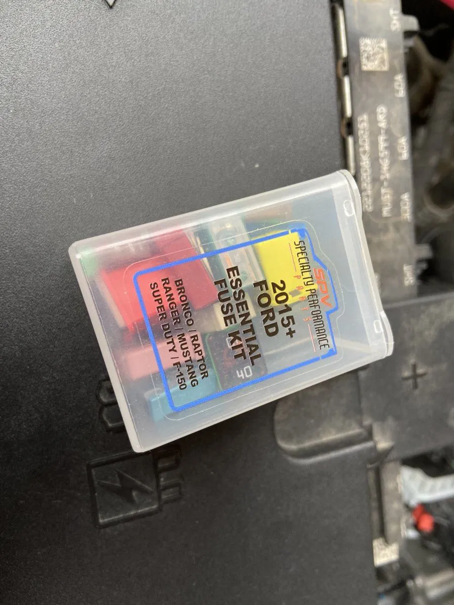

Small thing today…. “Installed“ Sticker Fab fuse box stickers under the hood and dash. Also threw a box of assorted Bronco specific fuses from Specialty Performance into the tool box as part of the overall “project”.
As I’ve added lights, winches, powered accessories, etc it’s probably time to be prepared for some sort of electrical issue. While I wired everything the “right way”, you just never know.
Only tricky part was pulling the panel under the steering wheel. It was straightforward, came out with firm consistent pull but it’s always a little unsettling pulling a panel for the first time.
For about $10 for the stickers (incl. shipping) and $40 for the fuse set, it’s hopefully cheap insurance to make sure I (or others I'm driving with) get back on the road quickly and safely.
FWIW
FWIW
View attachment 11423.
I did the same thing the other day. My sticker to the left under the fuse lid is slightly askew. Good thing I can't see it. I also from sticker fab got the small chiicklet stickers for the rocker switches. I put one on really straight. Hopefully the next one when I put on my chase light will be the same. The one thing I found was that there was no 7.5 micro fuse in my SPV kit . I ordered that and two large 40 amp fuses for my ARB compressor. I pulled that lower panel once before for my autostop eliminator and the 2nd time wasn't much better. Came open easily though.
Glad you posted this, I think it is a good precaution and easy to do.

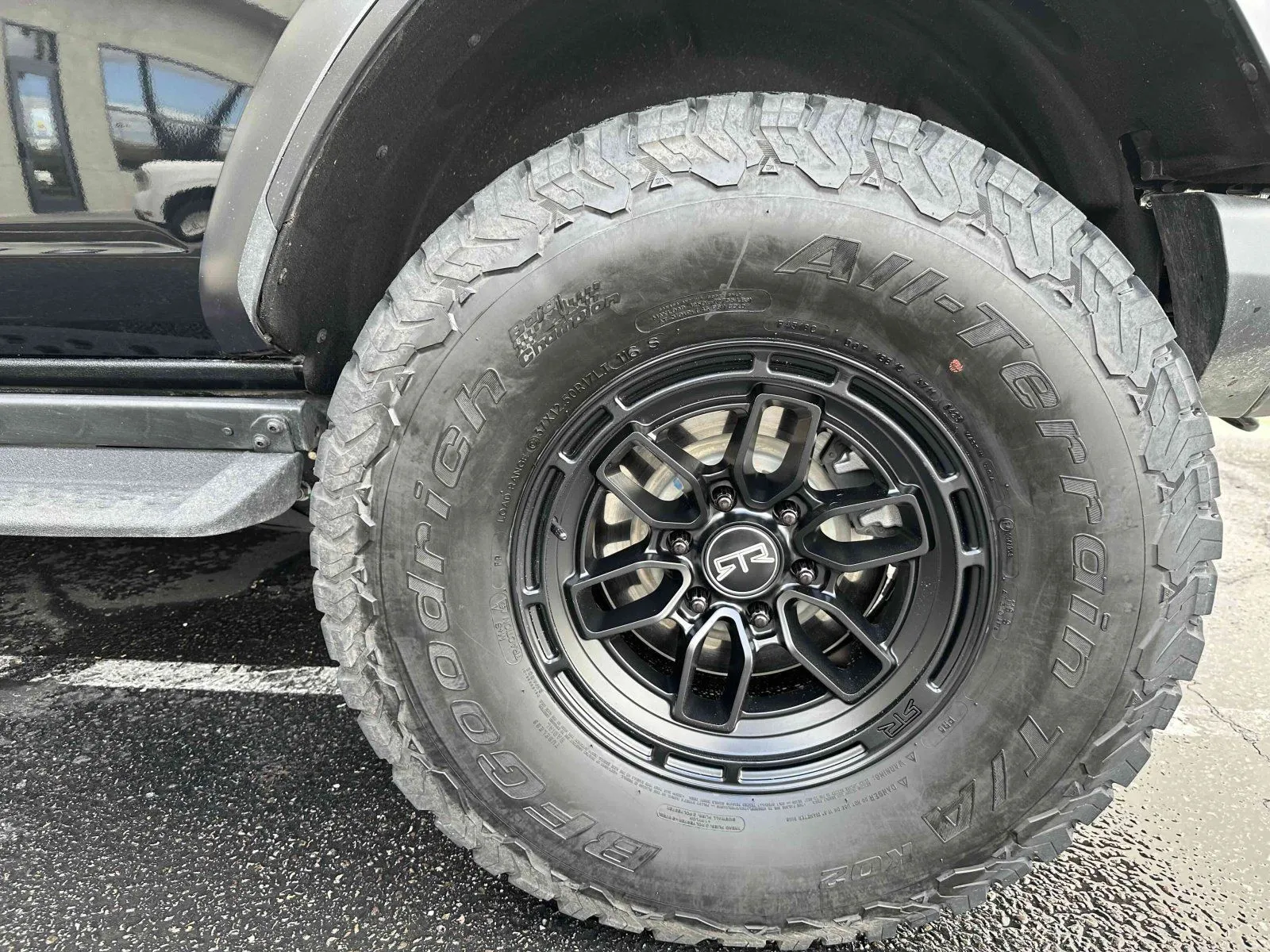

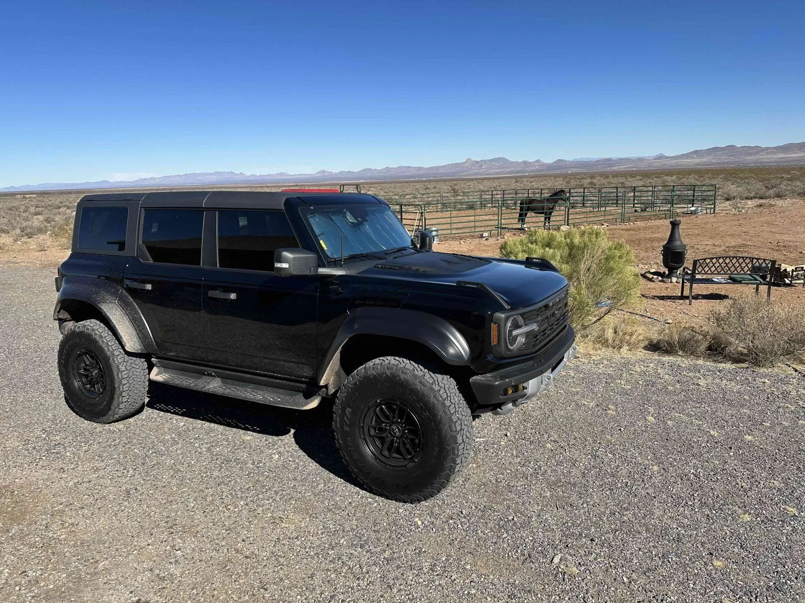

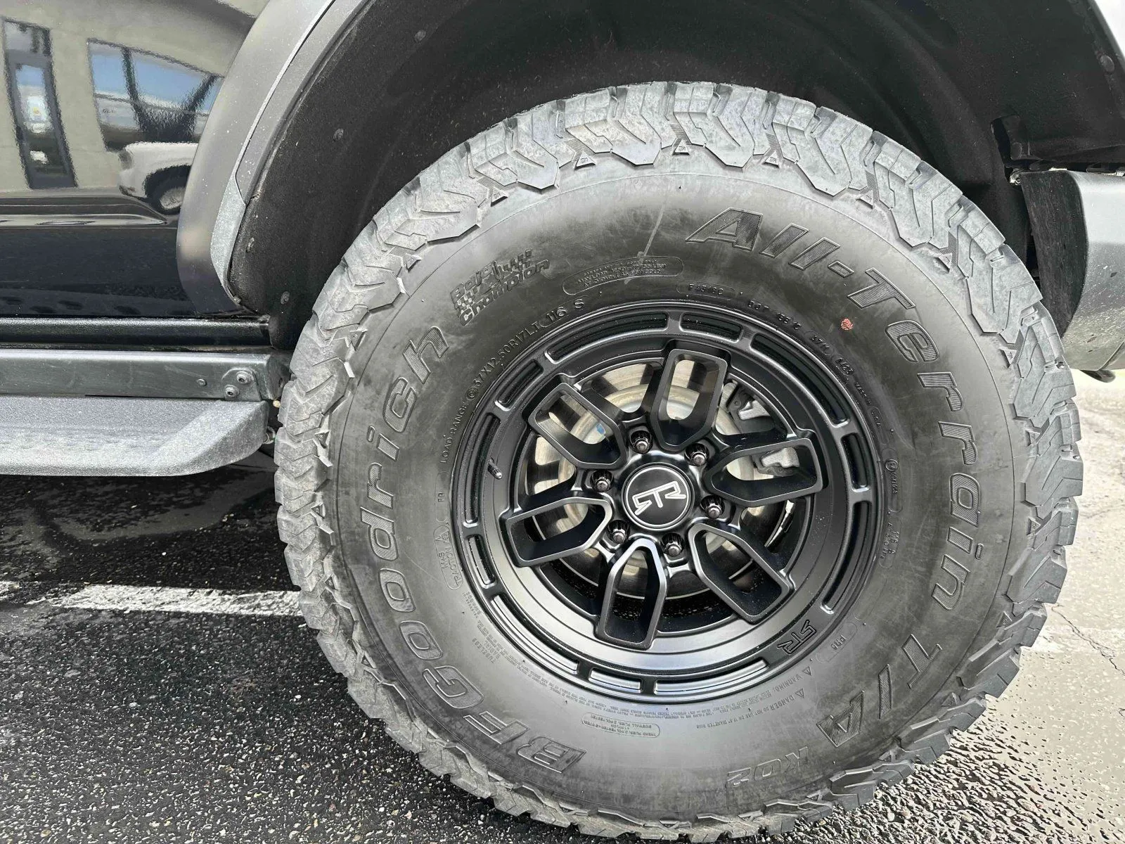

New Rims yesterday!
RTR Evo 6, Satin Black, 17 x 9, +18, My truck had the black allow rims and I probably wouldn't have changed them if it came with the bead locks. I appreciate all who helped with my decision.
New Rims yesterday!
View attachment 11475View attachment 11476View attachment 11477
RTR Evo 6, Satin Black, 17 x 9, +18, My truck had the black allow rims and I probably wouldn't have changed them if it came with the bead locks. I appreciate all who helped with my decision.View attachment 11481
Congratulations, great choice and one of my favorites. Not only do they look fantastic but the size and offset is perfect for our Bronco Raptors. That 1/2 inch in additional wheel width makes the OEM 37’s look like a size larger tire.
Thank you. That is interesting. A friend with a Badlands Sasquatch commented that my old truck (Black Diamond with the Roush package - non Sasquatch, my dealer had available at the time) the wheels looked bigger and I thought so too. With that package the the vehicle was lifted about an inch or inch and a half and the tires poked out past the OEM Black Diamond fenders which made the 35's look bigger than the 35's on the Badlands with their larger OEM Sasquatch fenders.
New Rims yesterday!
Good choice in wheels, now go to 39's :)

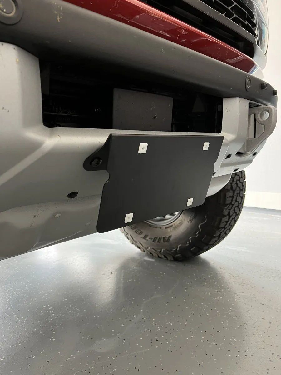

top view of trail tax mount
Side view of trail tax mount
